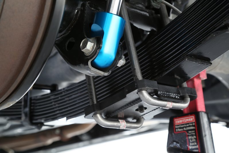

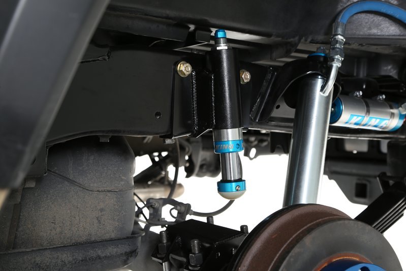

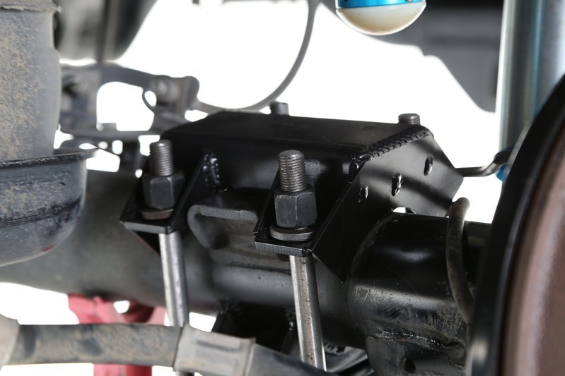

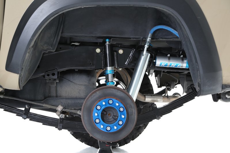

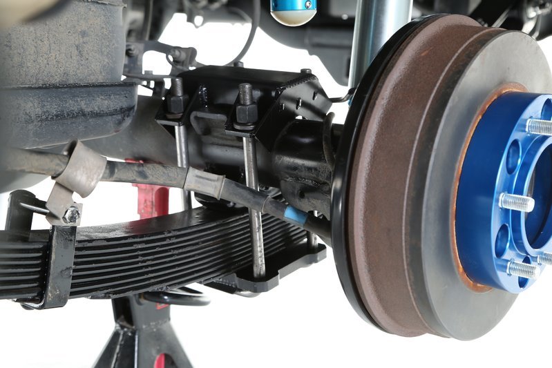

    The Spring under kit is a direct bolt on kit in the stock location.
    The kit includes custom Deaver springs designed for our SU, shackles, perch mount and spring plates.
    We also have a bump stop kit as well!
    This is designed to give you a little more up travel.
    You can run an OEM replacement shock in the stock location or you can relocate the shock mount.
