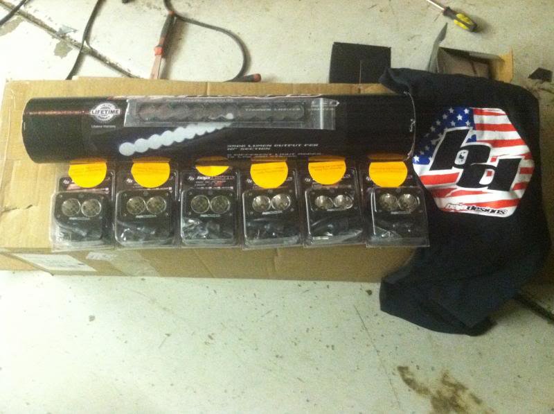

    This was the first round of lights mounted and wired
    (6) Baja Designs S2's for the around the rack lighting
    (1) Baja Designs Stealth bar with amber lenses (I also got the clear lenses too)

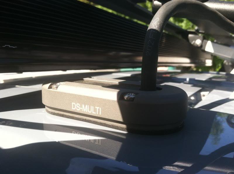

    I used this bulkhead connector to run all of my roof wiring. Its a solid piece of rubber that you drill the wire hole through then the cover compresses around the wire for a water tight seal

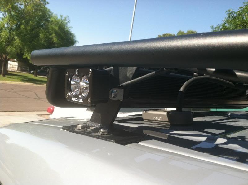

    Lights are mounted 2-2-2 both sides and rear
    This was one of the front mounts

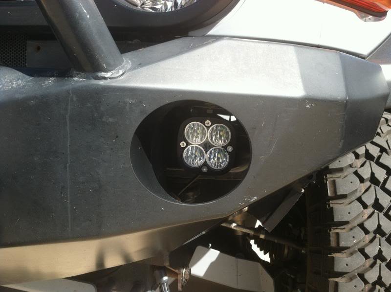

    I added 2 Baja Design Squadrons for the bumpers

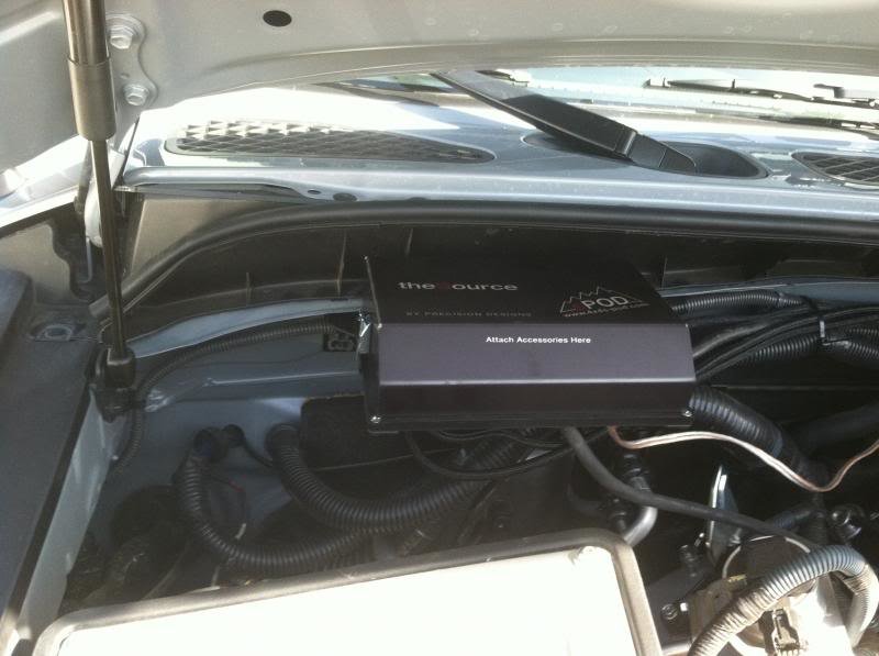

    Here is the S-Pod that has 6 relays all fused and protected for LED lights
    All of this is plug-n-play. You just need to get all the wire runs to this location ( a little easier said than done) :rolleyes:

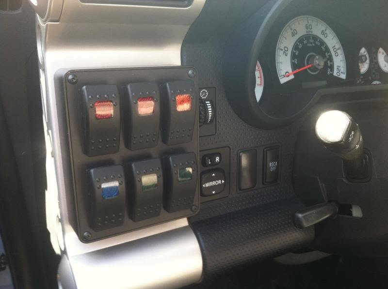

    This is the Dirty Parts Switch panel, you can integrate with the S-Pod
    All circuits are used
    40" Baja Designs Stealth bar on the Spylight System
    20" Baja Designs Stealth bar (Amber) on the front bumper
    Baja Designs Squadrons in the bumper
    2 S2's on the left side of the rack
    2 on the right side
    2 on the rack, facing the rear
    The Spylight switch is mounted next to the switch panel on the dash

    Has your roof bulkhead proved to be a watertight connection ?

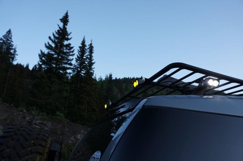

    Here are a few near daylight n Ouray Colorado
    I put amber lenses on the rear lights. I have got nothing but great comments from followers on dusty trail. They love the fact that they can see the lights, through heavy dust

    This bulkhead is used in the boating industry for high end applications. It rained every day in Ouray. No runs, drips, or errors. it was about 40-50 bucks, just for the bulkhead connector
