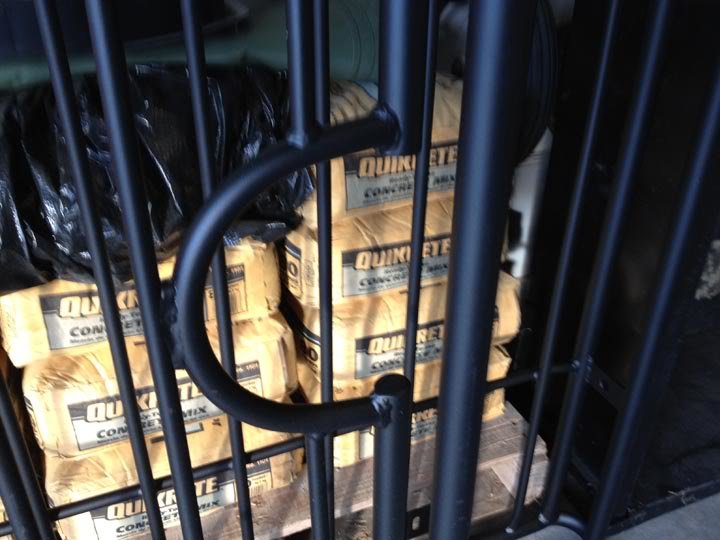

    I have now owned all three versions of the Baja Rack for the Tacoma and I had an issue with one version. I started a thread here to ask for assistance in dealing with the issue; however, Baja Racks being the excellent company that it is, fixed the problem and I promised to do a write up on the racks once I wrapped everything up. So here it is...
    Ok so I got my Tacoma in May 2012 and one of the accessories I added to the purchase was the OEM roof rack. This is the two bars that run along the sides of the roof. I like the design because it stows nicely and is still functional. In any case, I knew I would want a proper roof rack/ roof basket in the future. Up to this point, my experiences with roof rack all needed and existing “luggage” rack with cross bars and then the roof rack would attach to the luggage rack. There several pros and cons for these types of racks. From my perspective you can always remove it when not in use to cut down on wind noise; however, adding lights to this type of rack would mean that the wiring would need to be temporary as well or have a detachable connector somewhere in the line. Another issue is the weight limit. I am sure most of us have seen a Disco with a roof tent, or a spare oversized tire on a rack along with hi-lift mounted on side, etc....

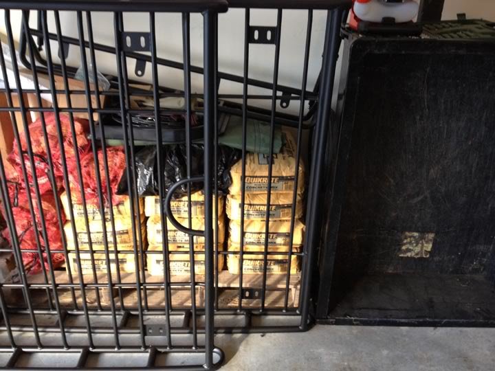

    Anyway, how can you put something like 600 lbs on a roof rack? Well I found out that the answer was to have a bolt on roof rack.
    But I degrees,

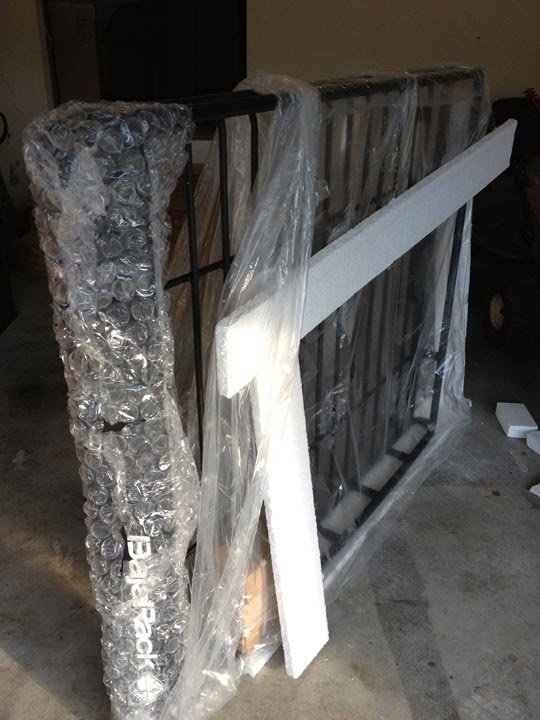

    This rack arrived via UPS freight (tractor trailer) and was packaged very well. It was inside a large thick cardboard box, inside there was foam on all four sides, the rack was wrapped in a plastic bag and bubble wrap around the wind deflector. The mounting hardware was wrapped in foam sleeved and inside another box that was zip tied to the rack.

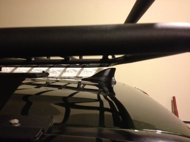

    However, I ran in to an issue. I have a 2012 Tacoma with a shark fin XM antenna on the roof. the Baja Rack did not fit because the fin sticked up too high and the rack rest on the antenna with at least 1” of space between mounts and the rack.
    So my dilemma was to either get a different XM antenna (like a 2011 tacoma XM antenna) or cut the rack. this is when I started a thread to ask for help on how to remove the XM antenna. Well it would require separating the the roof liner and a good amount of work. A “old” version of the XM antenna would cost 80.00 new and after spending just under 600.00 for the Baja Rack I was not happy. I called Baja Rack and explained to them the issue. Baja Racks was already working on the 2013 racks with a cut out for the XM antenna because all 2013s will have the shark fin. They shipped me a shark fin version and arranged to pick up the bolt on rack.
    In this picture I placed the shark fin version in front of the bolt on version.

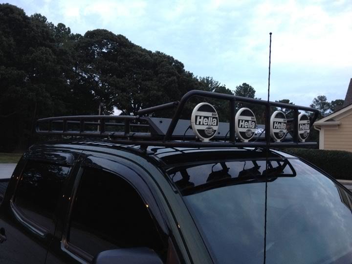

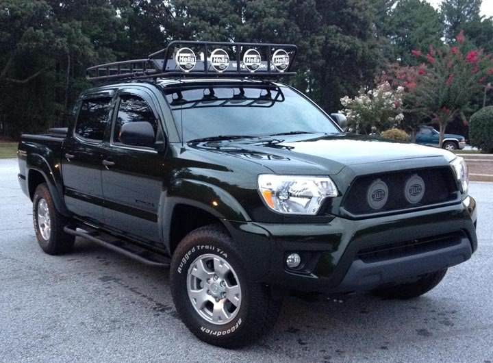

    I also purchased the light bar and here are the pics
    All and all I am extremely pleased with Baja Racks and their customer service. I found the quality of the racks to be first rate. The welds, finish, and design are excellent. The only thing that I think Baja Racks should change is the nuts and bolts used to mount the rack and light bar. they should be black rather than a stainless finish.

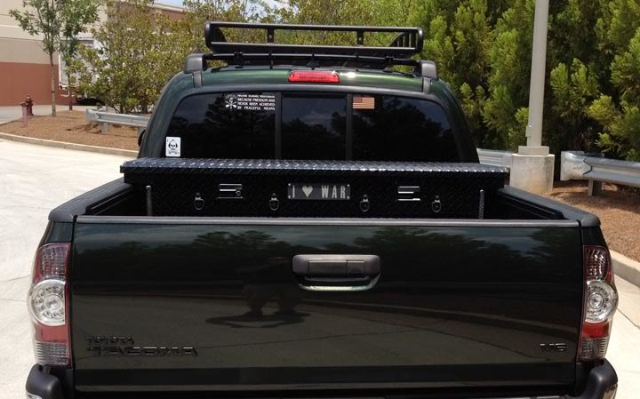

    whats with the "I Love War" on your toolbox?

    Rotorpilot, well since I have spent the last 24 years fighting for my Country, serving in the military is one of my professions and I love doing it, and since my job has been to go to war. I love my job, so I love war. To be honest, I really miss not being inthe thick of it. I had the same plate on the tool box on my Tundra since 2007 and before that, on my Dodge Ram since 2000, and before that, on my Jeep since 1995. I have never had anyone say anything except "I love your truck, jeep, etc... and I really love your bumper stickers". So thats the story with that...BTW, what do you fly? Are you @ Dobbins?

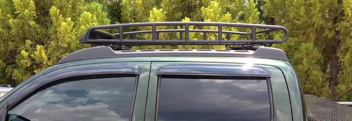

    Nice, that truck looks good. Here are a few pics of mine.
    I put LED work lights on the rear of mine. I've tried the OEM bars, Thule load bars, and a Thule basket. This is by far the most secure and versatile option for a double cab. The bolt on version is rated at 200 lbs. Good write up OP.
    Edit: my rack was purchased from SouthEast Overland. Great communication and service highly reccomended.

    Ive been thinking of getting a rack for awhile. I really like yours, it seems to have a more low profile look then some of the others

    Hey 1 question I just checked out there site. Whys it say no drilling, when clearly in your post u said u had to drill holes? Just curious that's all

    No drilling. Toyota already has threaded holes under double sided tape underneath the rubber drip molding (on double cabs). It is painted over and only requires a razor blade to expose the holes. These are the same holes used to mount the OEM load bars.

    Ross132, The drilling I was talking about is in the rubber rain drip rail strips. You do not have to do any drilling to the truck just the strips. AzoggSS is correct, you use the existing drilled holes in the roof.
    Also you mentioned the low profile. That is another reason I went with this version. I have a very small garage and I needed to keep a low profile to get it in there. Even at the highest point on the light bar top, it is still lower than the top of my OEM antenna. I will be using the antenna as an early warning device to prevent me from making a costly error.
