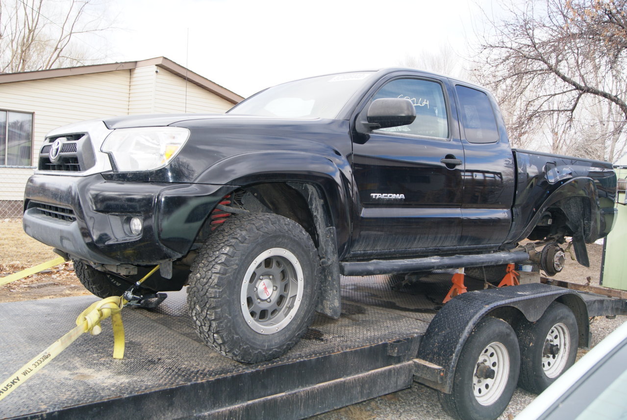

    I recently came home with a 2012 Baja Series Tacoma and have been searching the threads for mention of them with little luck. Is the Baja Series anything special? The one I have is damaged but repairable, so any information you know that might help me would be appreciated.
    For instance, I've measured a few things and it appears the Baja is a couple of inches lifted compared to the base model, but I don't see any lift mods. The rear shock height is 21" instead of the base 19". I don't see any differences in springs, shackles, etc, so where does the additional height come from?

    As far as I can see the leaf springs are stock. Three and one, just like my base model. Back mount appears to be the same. I haven't checked the front mount, but a quick look gave me the impression that it is the source of the added height.

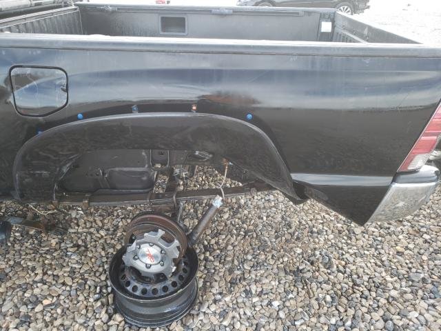

    I'm stumped on something.
    As you can see in the pictures the truck was hit hard enough to break the left rear wheel.
    Is there any kind of seal or gasket involved when you remove the four bolt hub and axle from the differential?
    Any tricks to replacing the axle that I should know?

    No tricks. You just undo the abs sensor, hard brake line, and the 4 bolts and it slides out. May have to gently tap the back of the drum with a dead blow hammer.

    No seal/gasket where the four bolts separate the hub?

    There’s a rubber seal but it’s pressed into the axle. It’s not like a rubber gasket where you have to forcefully break a seal.

    So a fresh axle removed at the wrecking yard should have the seal already in place?
    Just insert replacement axle, tighten nuts, and good to go?

    Probably, but it’s cheap and easy to replace so if you’re rebuilding the axle I would put new seals on.
