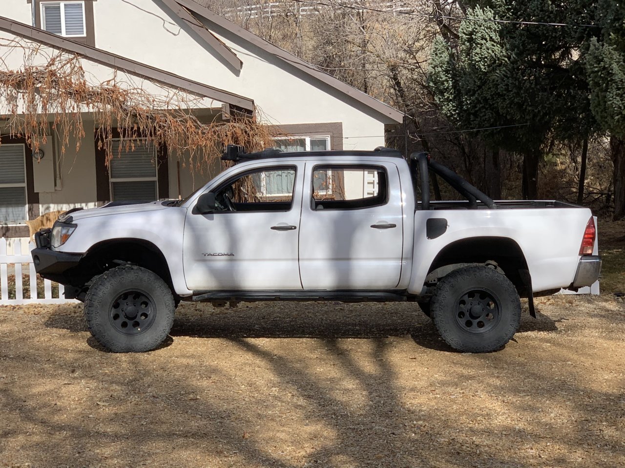

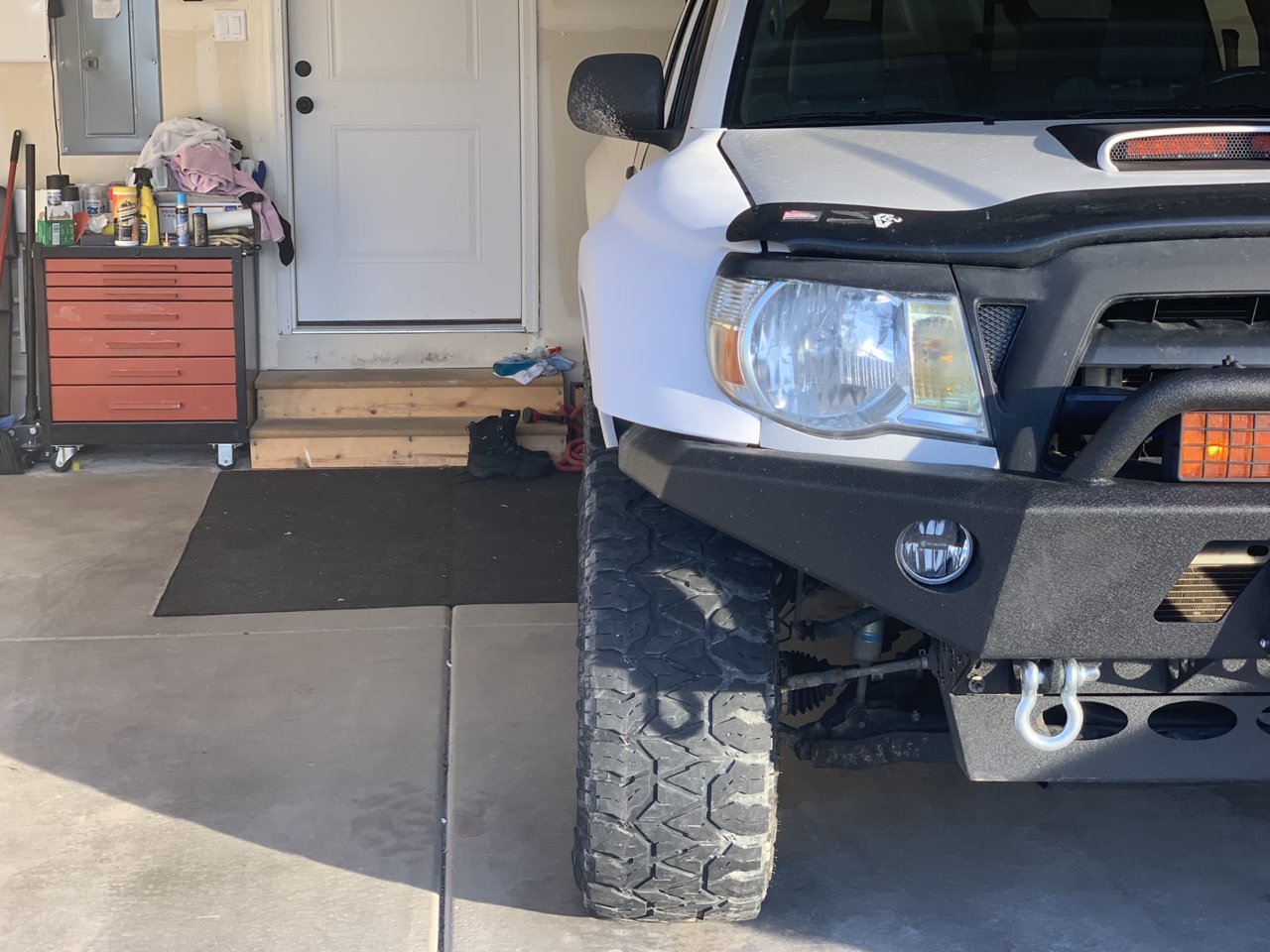

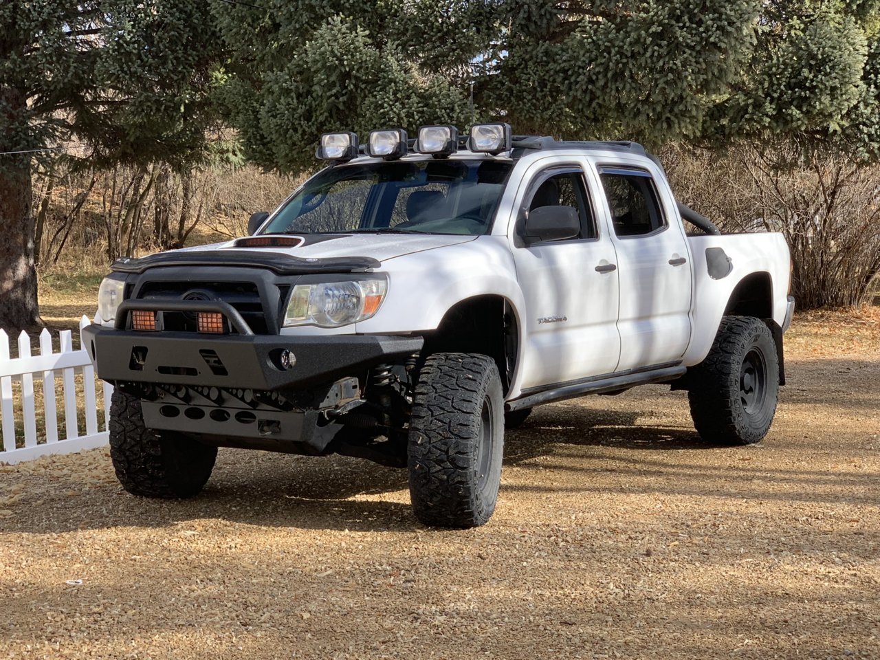

    Here’s some photos of ADV front 4” flare 3” rise and rear 5’ bed flat top fiberglass running 305/70r16 MT (wide 33’s) tires on 16x8 -11mm wheels with spidertrax 1.25” spacers with 2.5” of lift on stock LCA’s9C75B120-BEA7-464C-B073-CB587BE8E0D0.jpgC80A5191-ED1F-44AB-991D-A61609CE7AED.jpg E6896BE1-6F11-4C7B-AE9C-D7AAF80913DB.jpgF264D526-D603-48BE-A43B-F8D8DAAB29F0.jpg
    and one with 315/75r16’s for good measure

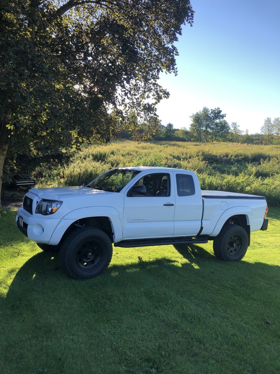

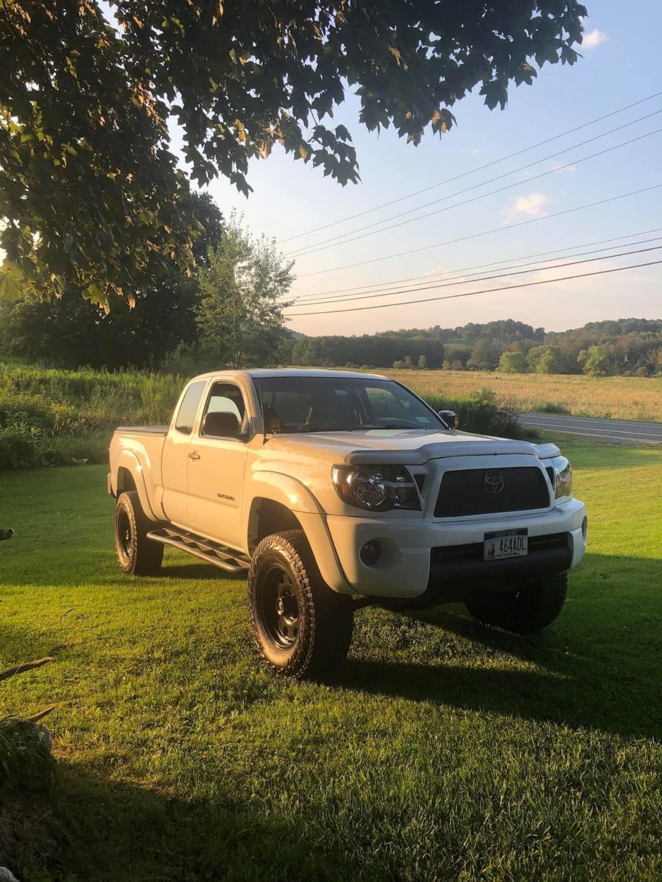

    17x8 ,4.5 backspace with 285/70 17s just about 33”
    2.5” lift in front and around 3” in rear . No special flares :oops:
