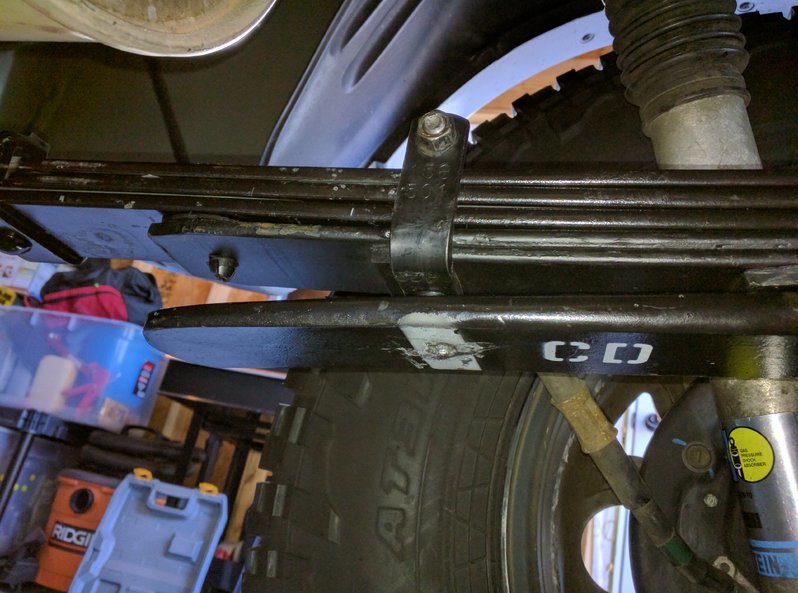

    So I think I have an issue. The dealer tech guy installed the Icon AAL with Overload on the new recalled leaf springs. But it seems that he removed the front U-shaped alignment retainer that was attached to the overload. (Because from the looks it was interfering with the retainer from the rest of the leaf pack). The rearward side of the overloads has the retainer in place. Is this safe? Or can I just add a retainer that encompasses the whole pack?

    It is hard to say from the photos, but it is possible they may have installed your AAL backwards. The longer side is supposed to go toward the rear. Measure and check. The Icon instructions make no mention of interference with the forward alignment retainer, but it is possible they can hit the rear spring pack clamp (mine didn't), and if so it should be removed. I took out my overload out, so I cannot compare to my truck.

    Actually he did initially install them backwards and I told him to fix it and make sure the longer side of the AAL faced to the rear (I checked before I left and saw they were indeed facing to the rear)
    Seems I see photos of other overloads not supported so maybe it's okay like this?
