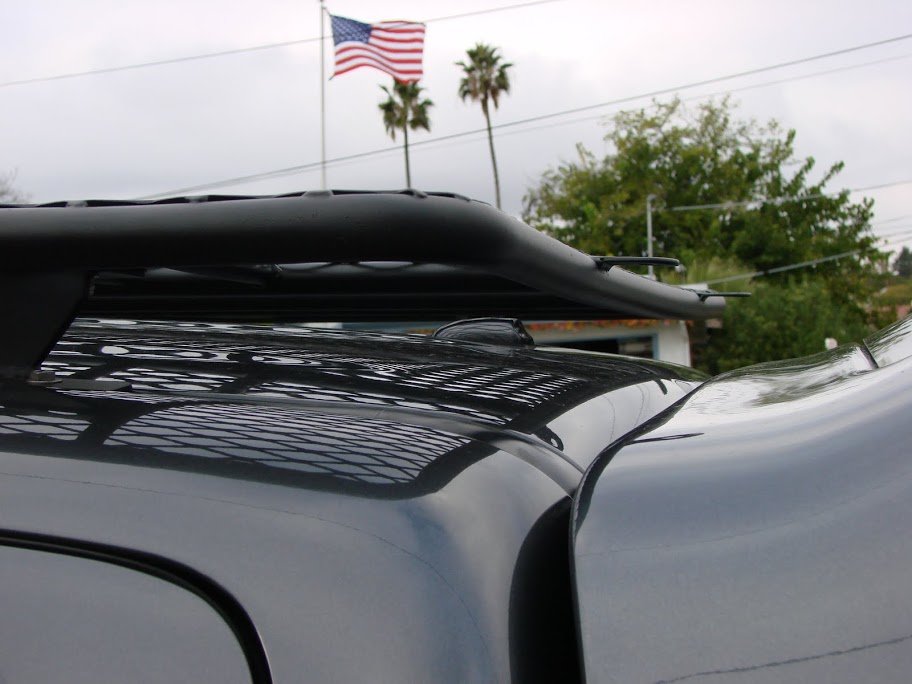

    This happened to me. Mine was slightly concave from side to side. If the welder works too fast the steel can get too hot so I've been told. I notified BajaRack and they took my rack back and straightened it and returned it. It sucked having to deal with defects. It should not leave the factory if it's not right.
    I would call them and let them know and tell them you want it fixed.

    I don't remember, maybe 2 weeks? Being without the rack was not a problem for me, I just wanted them to correct defects and deliver a solid product. I bought mine directly from BajaRack and did a local pickup. I've met the owner Sergio, and John (don't remember job title) in the HQ office.
    Once I supplied pictures of the issues they agreed to take the rack back and warranty repair it. No fight really, just a pain in the ass of driving down there, taking rack off, waiting, driving back putting rack on etc. They did ultimately compensate me for my troubles (I had too short brackets in the beginning), so I feel justice was done, and all warranties were honored, etc.
    I updated my post to show a pic of how my rack was initially bent.

    Level just to indicate the degree..bubble was off the chart.....kayaks weigh so much it pushes the bent part into roof

    Its bent and to close to roof
