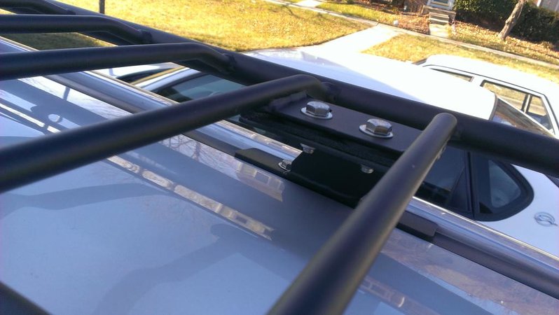

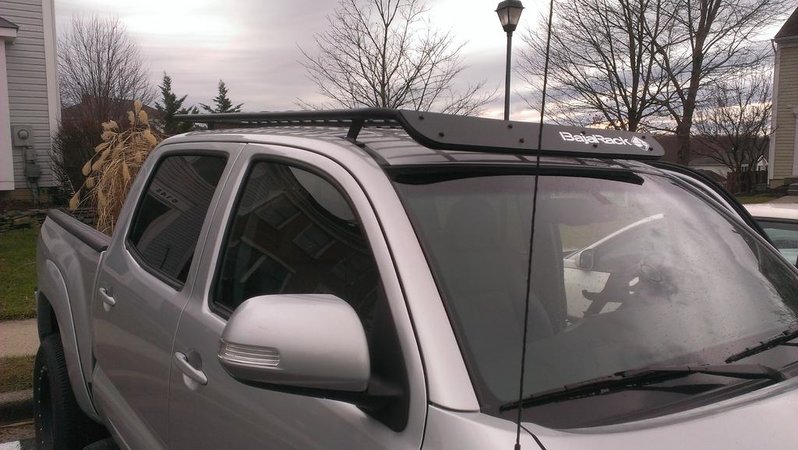

    Here are some pics I have, I also have the brackets that were too short still if anyone is interested in them. They would work for a basket type that would sit on top.

    For anyone that has one installed - suggestions/tips for an easy install?
    I read on a thread about punching holes in the weather strip with a leather punch. Anyone ever do that?
    @Crom I recall you telling me that the weather strip was a bit of a pia. There is a metal insert in the strip? Is that correct?
    Any help would be great. Thanks.

    I don't have a BaJa Rack but the FrontRunner mounts similar (except it has the mounting points in the center also). I used a drill bit to drill the holes through mine. Measure 4 times then drill once.

    There is a metal strip in the middle, I took a pair of cutters and cut the metal out of the area to be drilled.

    I used a 3/4" leather punch to punch my weather strip. Then filled the roof mounting holes with silicone caulking. Hopefully I won't run into any problems.

    Did mine yesterday.
    The metal in the strips were a p.i.a., but the leather hole punch worked great. Was a better option rather than the drill. :thumbsup:
    Copious amounts of RTV silicone used. :D (I get nervous about holes in the roof.)

    Looking to have a few questions answered as I'm looking at this rack for my '15 DCSB.
    1) For those that have a XM antenna, can you provide me the measurement the rack sticks up *past* the top of the shark-fin? (have a low ceiling in the garage and its pretty tight already, but I think it will fit!)
    2) Has anyone else suffered from dramatic wind noise? Is this more of one off issues or wide-spread?

    1) I'll get a measurement once home (where the truck is) if no one else does first.
    2) Depending on if its windy out (and direction) I would say its substantially louder at highway speeds than having nothing up there. Again seemed to depend on wind.
    3) Mine was perfect nothing damaged or bent.

    I think it is maybe 2 inches higher but will measure to be sure. I've never had a roof rack or anything on the roof of a vehicle before this. So I have no reference. I could still have a conversation with my wife but I think we were probably talking louder to accommodate the noise. Then other times I forgot the rack was up there completely due to change in direction or wind.

    I don't know what I was remembering....Its a 1/2" from the top of the shark fin to the top of the rack.

    Awesome! I think it should clear just fine for me then.
