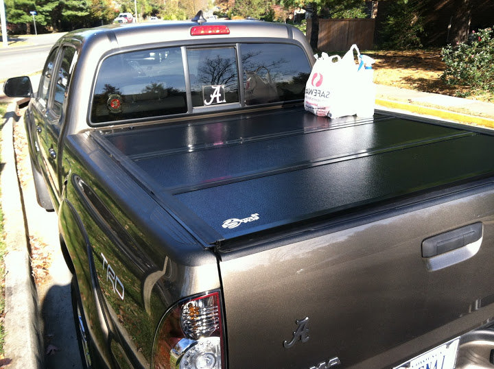

    Bought my 2012 Tacoma double cab this past March. Installed my BakFlip just a month or so ago and was Googling "drill holes in bed of Tacoma" and found this forum.
    Man, lots of great ideas-and I like this one the best. I don't seem to have a lot of water accumulate in the bed of my truck - assuming it runs off - but I'm taking my truck loaded with stuff on a 1700 mile round trip this coming weekend and the bed will be full of luggage and Christmas gifts. Sure don't want to test the 'leak proof-ness' of the G2 with all that stuff back there.
    I like the idea of the hose barb. Thanks t-frax for posting this simple but effective idea.

    Thanks - I did do that when it was warm. That photo was right after I had installed it, but shortly after I smoothed out the weatherstripping.
    You are so right - you have to be careful. I actually bought the 1/4 inch ones. They work fine - not a tight friction fit, but since installation we've had rain, and my bed has remained dry. I'm actually very pleased!
