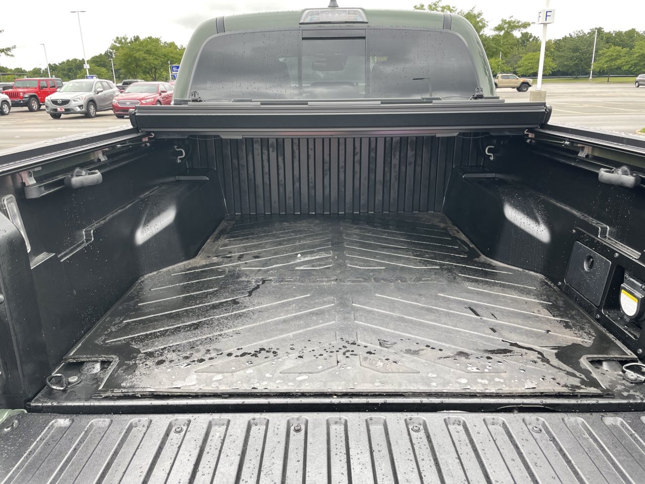

    463AE4F6-427A-4B75-AC20-FE232A07E035.jpg This is the amount of water that gets into my bed after an overnight rain with the Bakflip Mx4 cover. This is my second cover under warranty. Has anyone else experienced this or have a fix for it?

    That’s odd. I have had two Bakflips on two different trucks and even driving at highway speeds during the most torrential rains I only ever had a very tiny amount of water get into the bed.

    I just put one on and it’s been through the car wash several times. There was a tiny bit of water in there, but nothing like what you are showing.

    Just not sealing well on the sides. Whether that be to installation or whatnot. Can lay a thin bead of sealer down and see if it helps

    My first one was installed professionally and it leaked the same way. Bakflip suggested taking it off and reinstalling it which didn’t help so they sent me a complete new one. This one is loaded up with silicone and you see how much water gets in. The truck was parked when the water got in.

    I skipped the drain tubes installation and I get the same rain result like yours

    I got mine used, 2018 mfg I think, and it leaks like that. After some effort it’s mostly sealed now.
    Butyl tape is good stuff that feels like sticky playdo that doesn’t dry. Putting that down to fill all gaps was the trick. Especially up at the front there is a big gap under the bed side rails.
    The other big problem was actually the top texture of the bed side rail caps creating little gaps along the side with the cover rail seal. I would suggest the first and easiest is to add the butyl tape to the underside of the cover rails about where the rubber meets the aluminum. Look where it touches the bed cap before taking off because there is a gap with the bed and the tape needs to be squished to work. It also leaks along the header section so same thing up there.
    That might get you to a happy moist place, or go all out right away and tape under the bed rail caps too.
