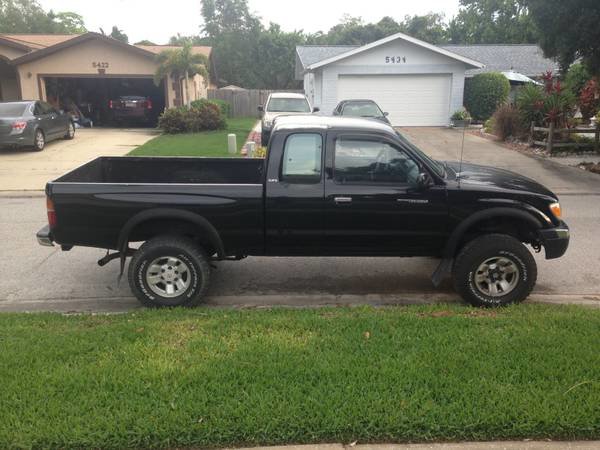

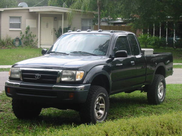

    Here's a pic of the truck from the Craigslist ad I found it on:
    The truck runs great and has a fairly straight body aside from a few dings in the tops of the bedrails. It also came with a diamond plate aluminum tool box. It currently has a 2' Pro Comp above-the-strut spacer/rear AAL lift on it that will be getting replaced. The paint, however, is in pretty rough shape with the clear coat wearing off in several places. Seems to be a common problem with black vehicles in the FL sun.

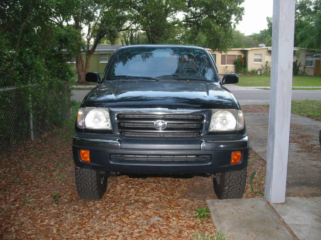

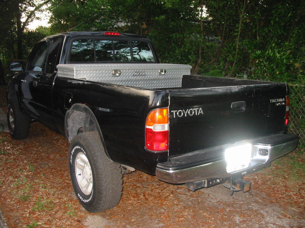

    I finally went out and took some pics of the truck that show how rough it is paint-wise. I also removed the fender flares for when it gets painted but I kinda like it better without them, so I may not put them back on. I may have to do some trimming on the fenders anyway to clear my wheel/tire choice, so it's probably better that way.
    As you can see there's lots of room for improvement. :rolleyes::p

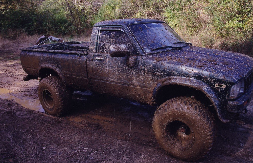

    Why did you part ways with the 83 ?
    Those are tough trucks
  8. May 26, 2013 at 4:26 PM
    Taco No Baka
    Taco No Baka [OP] Interco Tire Snob
    May 9, 2013
    #103866
    5,530
    Lee
    Tampa, FL
    1998 SR5 Xtra Cab 4WD V6 Spartan Package
    OME 3" lift with Dakar rear leaves, 33x13.50 Super Swamper LTBs on Pro Comp Series 97 15x8 Steelies, Bud Built Front Skid, 4xI rock sliders, Lincoln Locked front diff, Detroit Locker in the rear, LED cab clearance lights, Sway Bar Delete, Rear Diff Breather Mod, Autometer Monster Tach, Cobra 25LTD Classic, Roof-mounted 3' Firestik Firefly, Garmin GPS, HiLift Jack, Flush-mount LED pod lights in rear bumper, 20" light bar in the front bumper, rear shock relocation (Ruff Stuff brackets), u-bolt flip with Ruff Stuff Anti-wrap perches, CBI rear frame reinforcements, 10" travel Bilstein 5125 rear shocks, heavy duty front crossmember made by Allenfab, Rear shock mounts/crossmember (for upper mounts), spring perches, frame plates, and front crossmember welded in by Allenfab, CBI Ditch Light Brackets, Ditch Light Pods.
    Yeah, I really loved the truck, but the piston rings were shot out as were the valve guide seals. It looked like a mosquito fogger going down the road. When it got to the point that I had to put oil in it more often than gas, I had to let it go. 22Rs were getting hard to come by and the ones you could find might as well have been gold plated for what people wanted for them. I already had an 87 that I was working on a Chevy 350 conversion on (which I unfortunately never completed before I sold it), so I couldn't really justify keeping it.
    After that, I got on a full-sized kick for hauling my ATV around and now I've come full circle and am able to cross another "most desired" vehicle off my list, an xtra cab Toyota.

    FYI .. the bad spots in your paint is from oil ... oils from your skin... and lack of wash/wax thru time...caused the clear coat to go
    Hence is why its only on drivers door (arm out window) and bed rails (reaching in/out)
    keeping a fresh coat of wax on your paint does wonders at protecting the clear coat in the long run

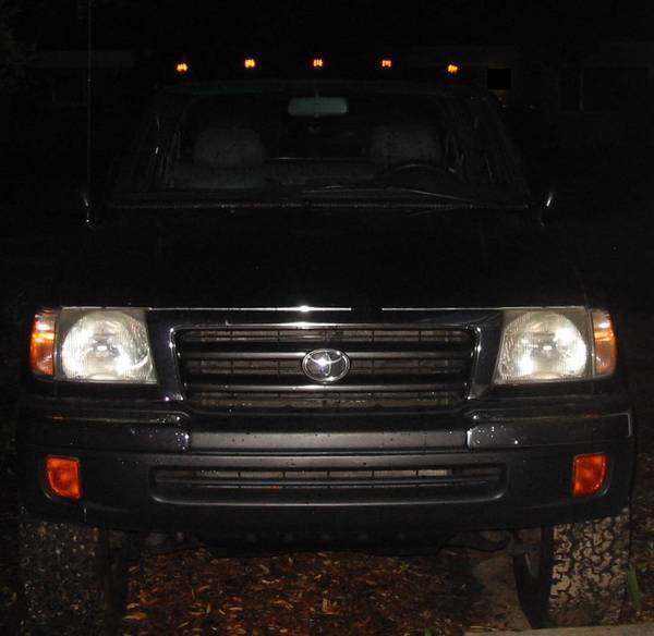

    First mod completed! Put my cab clearance lights on today! I think they came out pretty awesome. :cool:
    Update...night shot...

    Came out pretty good! get ready to get some shit from haters in their big super duty diesels at gas stations :D I take it you had to drill holes in the roof?

    Ayup. Holes had to be drilled. But I wasn't skeerd! Really! It was kinda of a biatch to lay out when I realized there wasn't a hard, straight edge on the whole roof to pull measurements off of. Ended up using the ol' Mk 1 eyeball and a couple lines of masking tape to pull straight lines off of.
