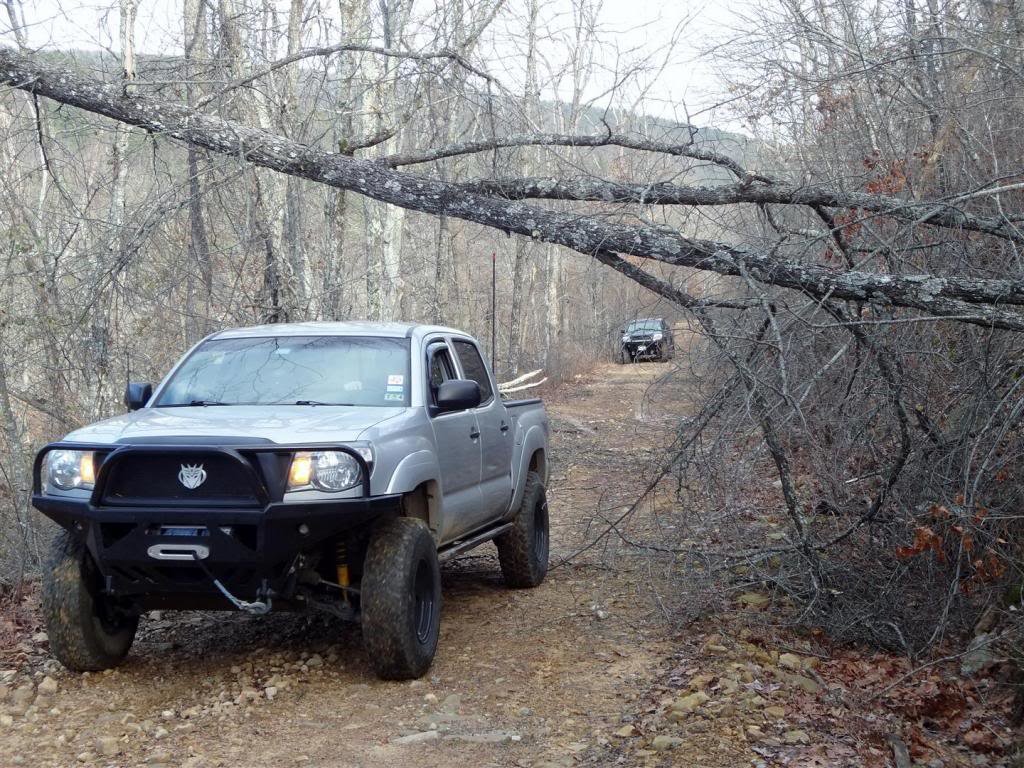

    Ran around with Tex in the Ouachita National Forest over the weekend.

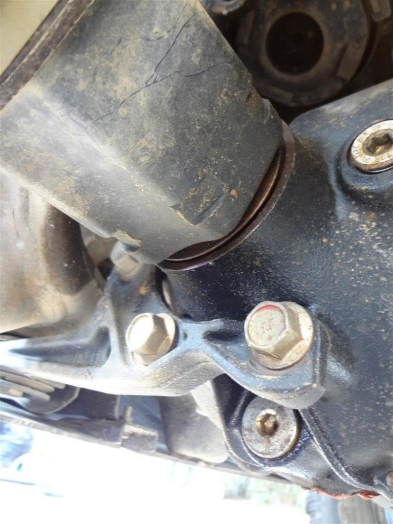

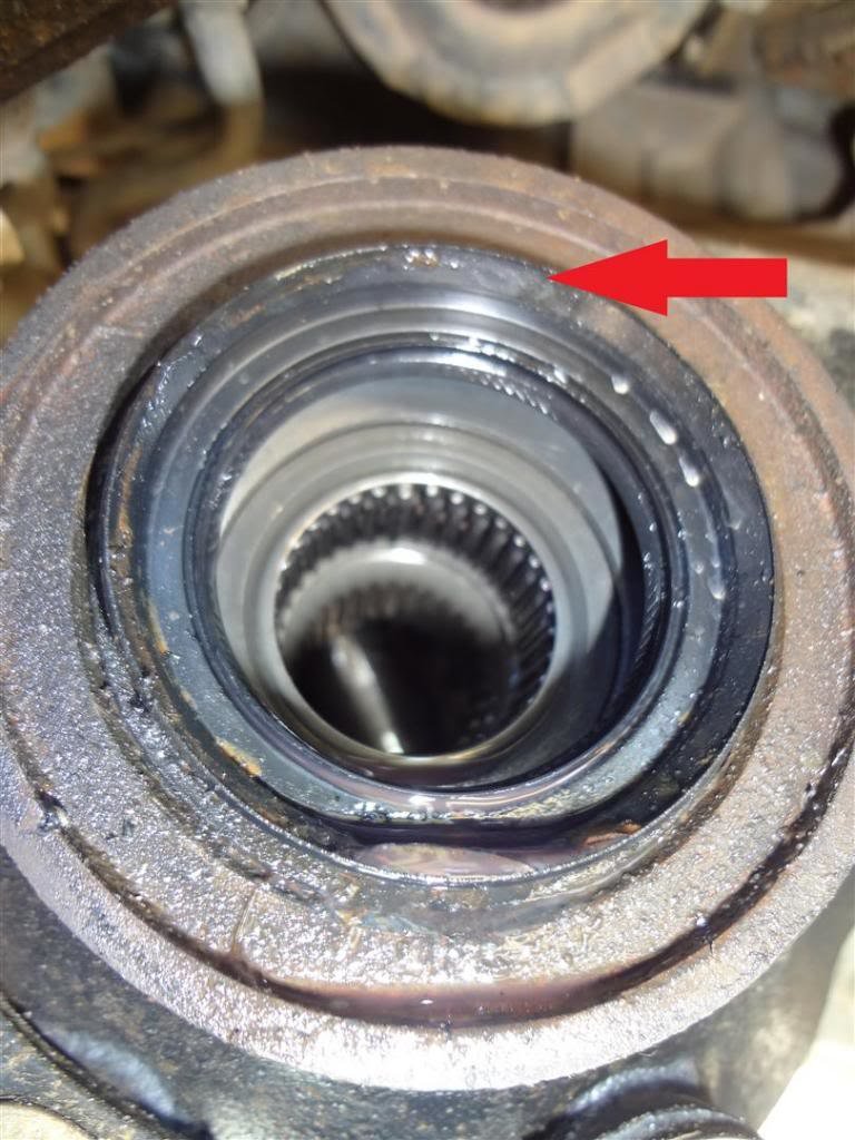

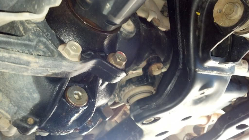

    Did some work today. I pulled the driver's side CV axle and replaced the leaking oil seal. A seal puller makes pulling that seal an easy job. Prying it out with a prybar or screwdriver wasn't working. The seal looked good, and I have no idea why the thing was leaking. Hopefully I seated it properly and it doesn't leak again.
    Leaky diff
    Oil seal (marked with red arrow)
    Then it was time to replace the rubber bushings on the driver side LR UCAs. Apparently when banging the bolt that connects the UCA to the spindle with a hammer I buggered up the threads. I know better...but it just wasn't coming free. I think this was the 3rd time for this bolt to get beat on. Luckily I had a spare balljoint assembly and I quickly swapped them out and put the truck back together. The spare isn't in good condition, but it'll buy me some time to either fix the threads or order a new balljoint assembly from SPC.

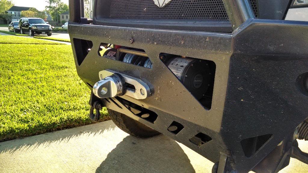

    Finally got my synthetic winch line out of the sun.

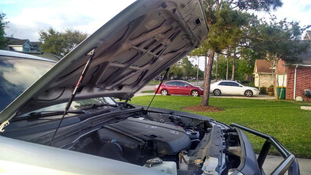

    Installed Redline Tuning hood struts. These things are pretty cool.

    Truck looks good! Where did you relocate your winch solenoid to?

    Behind the passenger headlight. I owe you a pic.
