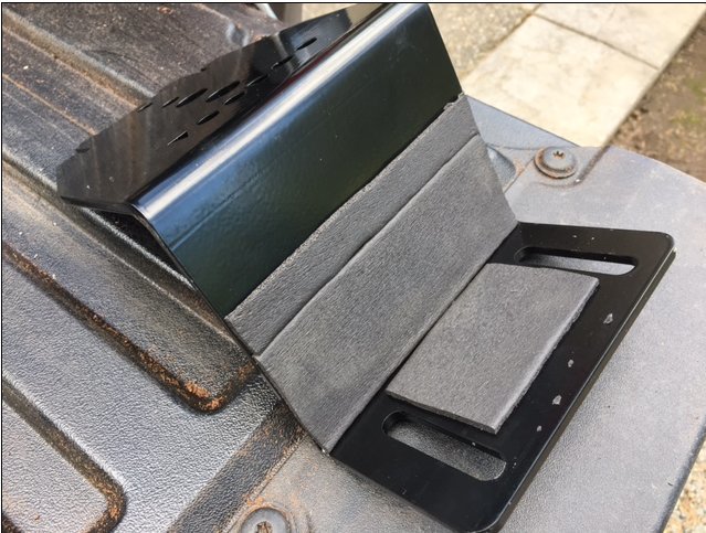

    Who said we weren't interested?
    We already have them designed, we just need to find time to test them.

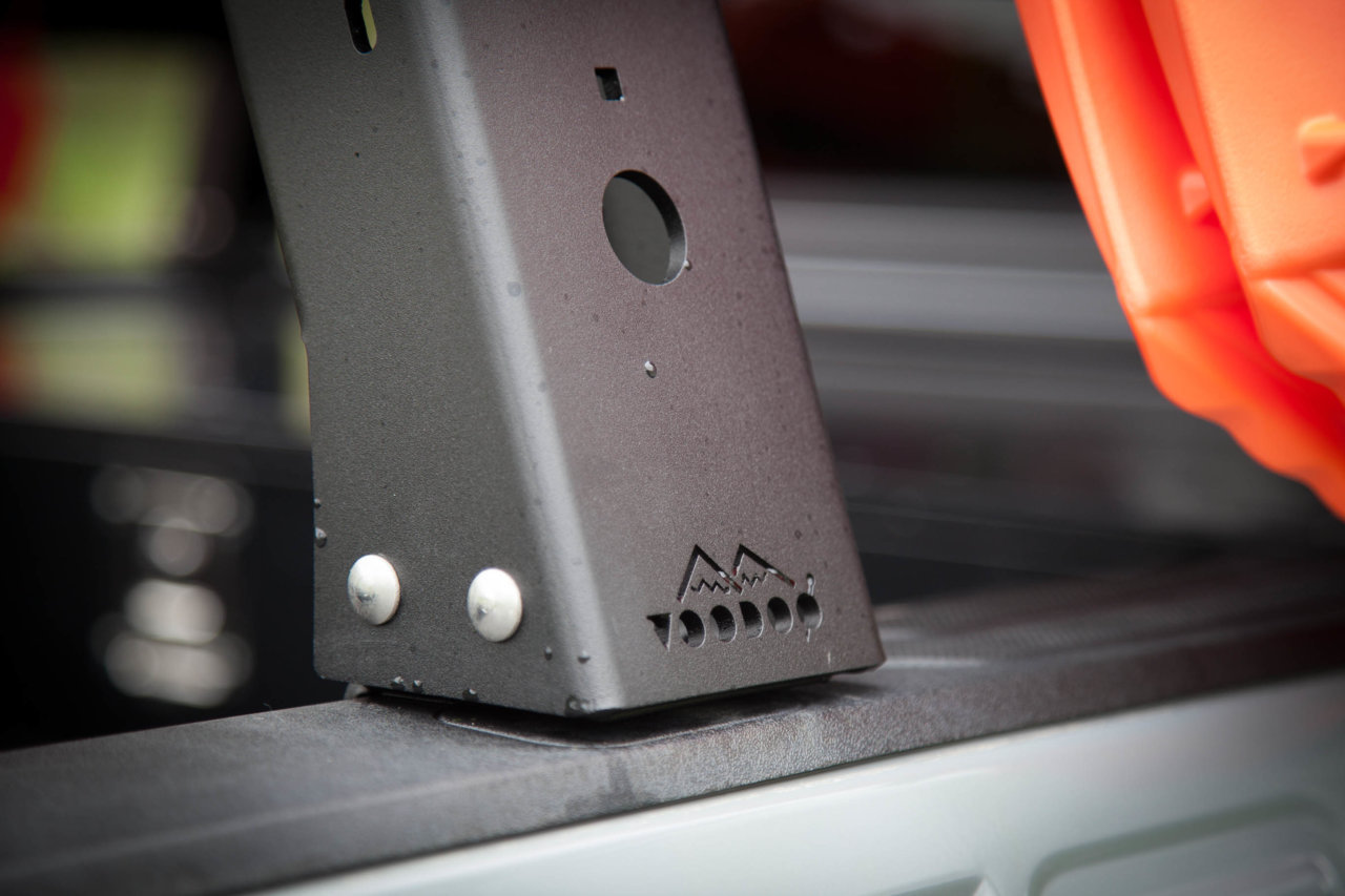

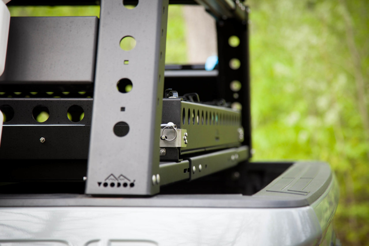

    Totally new textured powder coat.

    This is what it looks like:

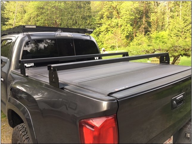

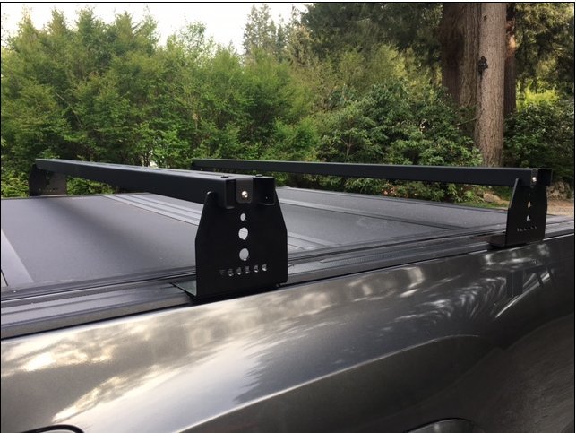

    Looks awesome. I had asked about 6 months ago but the response was not at this time. Didn’t hear much more even when others asked. Glad you guys have these made.

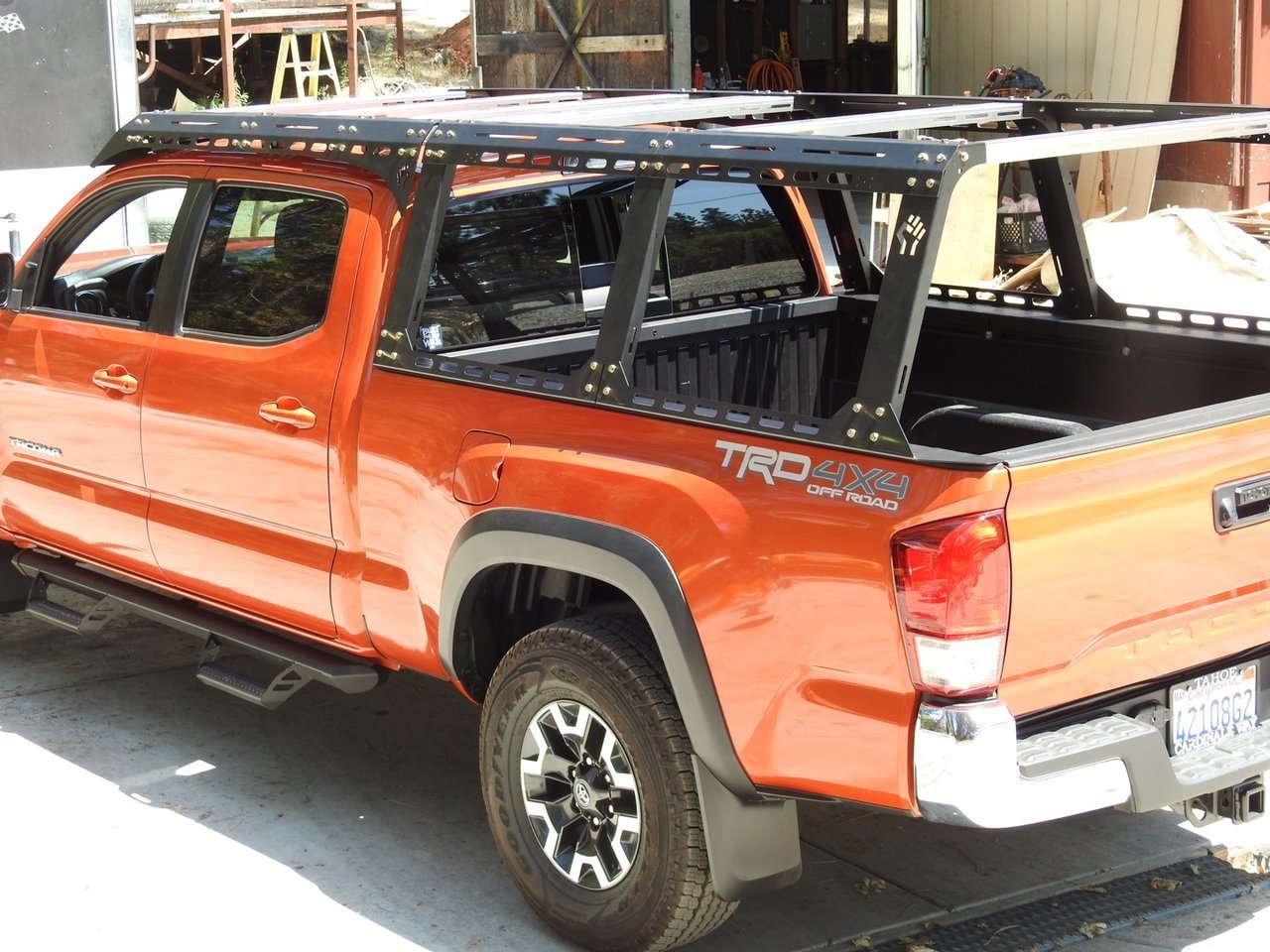

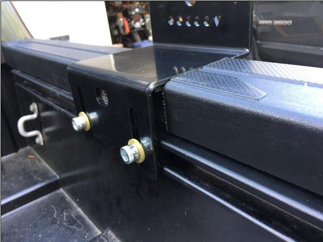

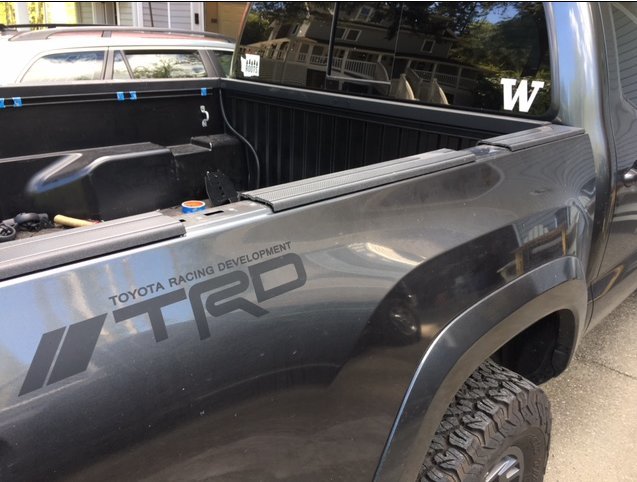

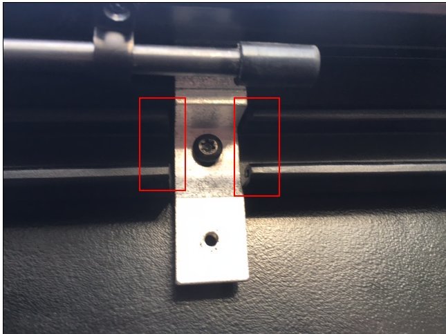

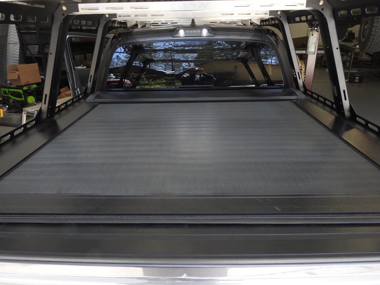

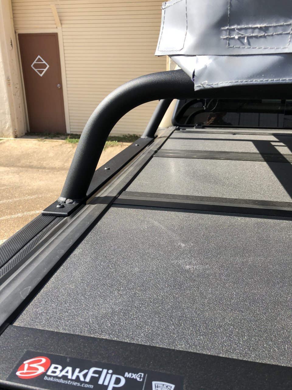

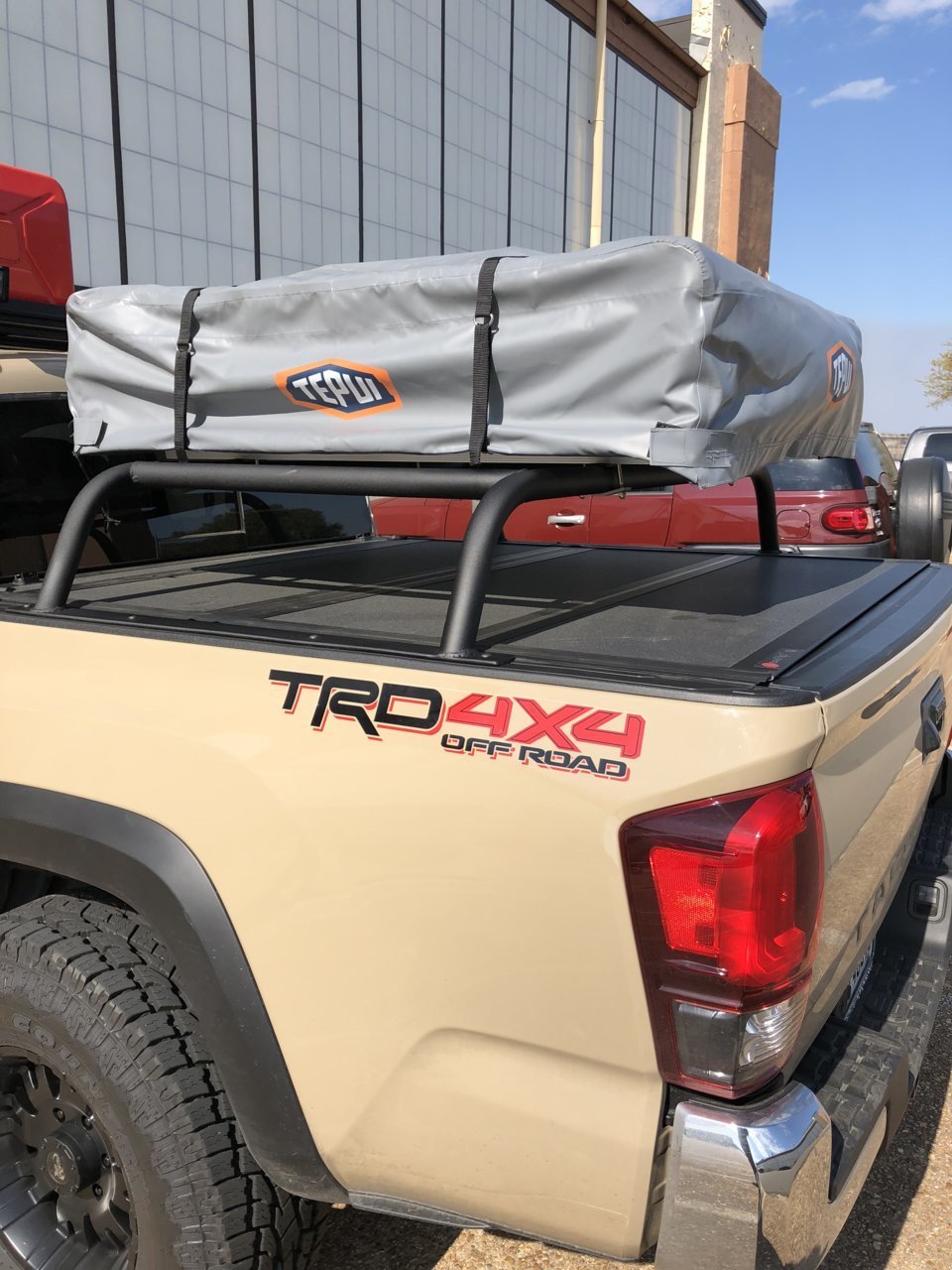

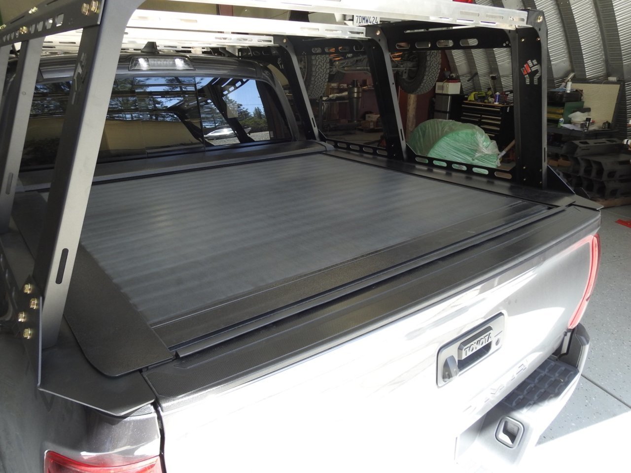

    To my knowledge, these are the only two guys to pull it off:
    Quicksand truck had a bed rack custom fabbed to bolt onto the top of the bed rail. There is some sort of a mounting plate under the bed caps that he said is easy to get to. I don't believe he utilized the bed rail system at all.
    MGM truck cut the bed rail caps so the MX4 would sit flush, under the bed rack mount. I think he had to extend the Voodoo mounts with customc brackets for to the relocation of the bed rail system. This is the route I plan to go with.

    About to post up when I saw my truck up there (the MGM). No custom mounts needed - I used the normal Voodoo mounts. Just needed to trim the rail as shown above, plus the plastic bed cap. Still have it this way and works well.
    @KB Voodoo - let me know if you need a guinea pig to test those new brackets. In the winter when I need the dry storage space, I swap everything out for a second set of un-modified bed caps and remove the rack. Would be nice to be able to skip that part.

    SOooooo clean, makes me want to do this and put my shell in storage.
