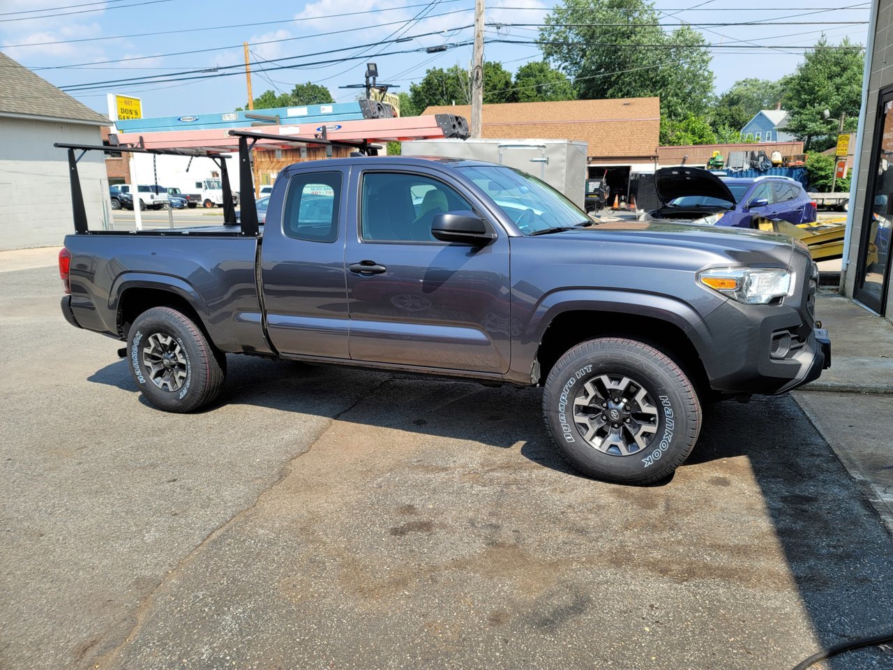

    It works with minor or major modifications depending on what route you decide to go. 2018 Tacoma SR AC 6' bed
    SouthFLTaco likes this.

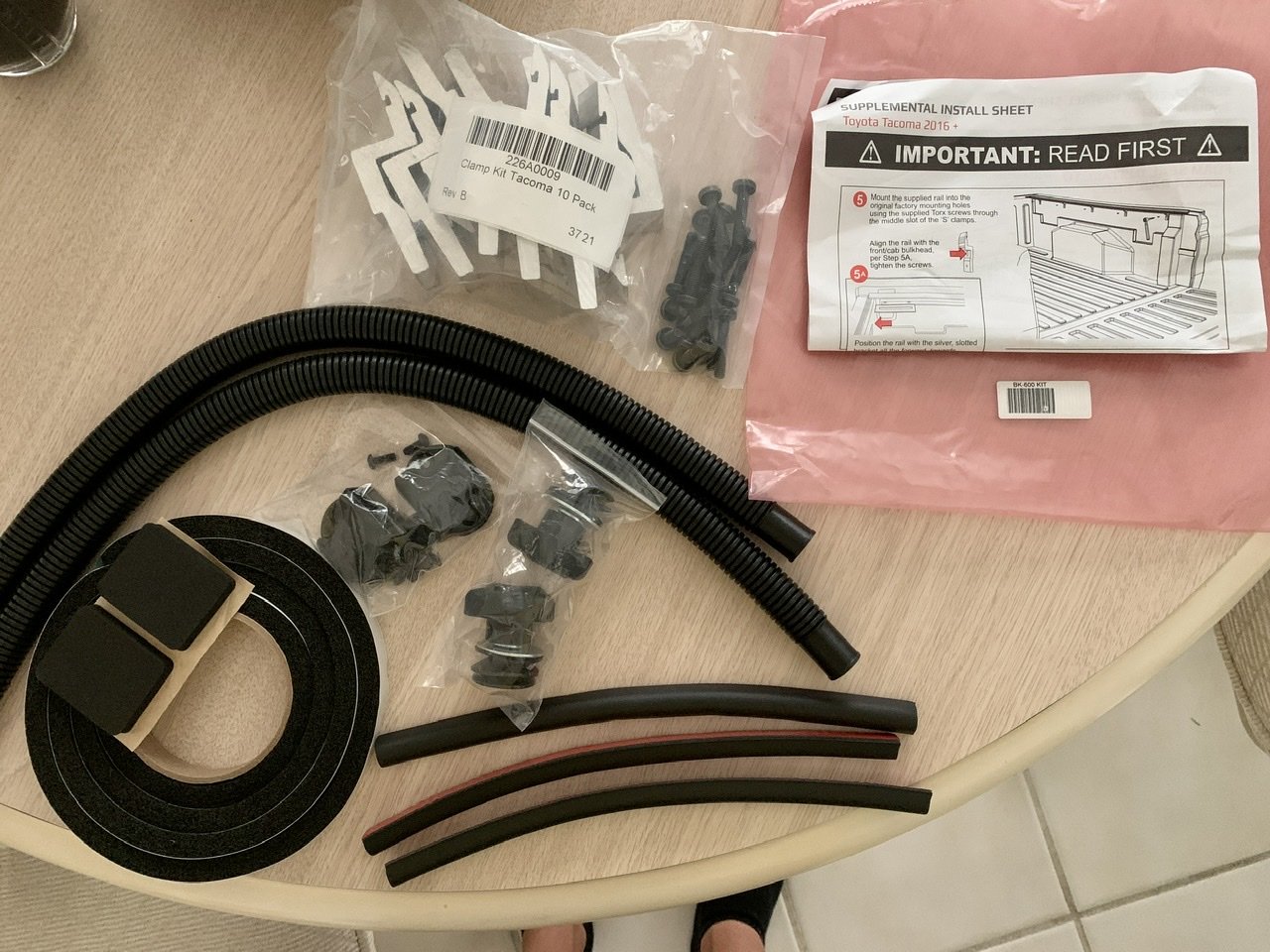

    That’s great information @Pariah1984 , thanks. I saw a few different varieties on Amazon, and wasn’t sure which to try… Now I have the 4 the previous guy was using on his GMC, and I just received the Hardware kit I bought from BAK Industries, BK—600, for reference. Ran about $50 shipped which O thought was reasonable. Came with gaskets, bumpers, drain tubes, clips for the straps, and ten (10) relocation S-brackets with the necessary screws.

    I’ve run into having to deal with a family member going through some medical issues so I haven’t been able to complete my project yet. In my case the Bakflip CS does not have the correct profile to slide into the relocation brackets for the Tacoma, and the cover is a slight bit narrower. The width is a critical dimension because the “locks” are a specific width and have to mate perfectly with the side rails in order to click in and secure.
