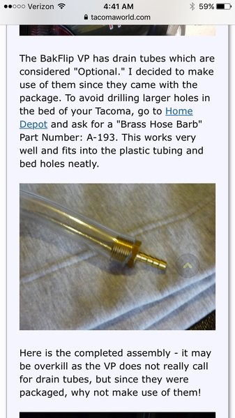

    I saw this on an old thread from the 2nd gen. I'm wondering if everything is the same size wise.

    Sweet, should be the exact same on our 2016's the beds are the same!!!!!

    I think I'm most likely going to go buy 2 fittings, do this set up, and then silicone around the hole once it's installed.
    That thread I got that off of said it fit but was a little loose. Maybe I'll see if they have another equivalent or something a hair larger.

    That's what I'll do, just measure the drain holes with a set of calipers and go to home depot or lowes with that size and the hose from the cover!!!

    Do you have it yet? I may just go buy the part used in the 2nd gen thread so when my cover comes I just install it.

    I do not have the cover or the part yet. But Im 99.9% sure its the same as that guy was referring to!!!
