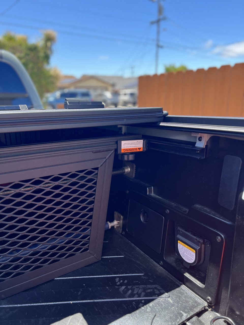

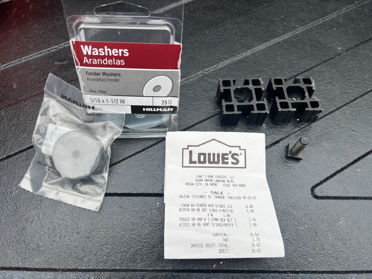

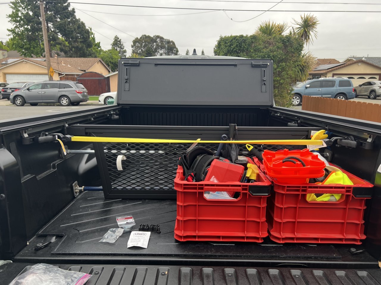

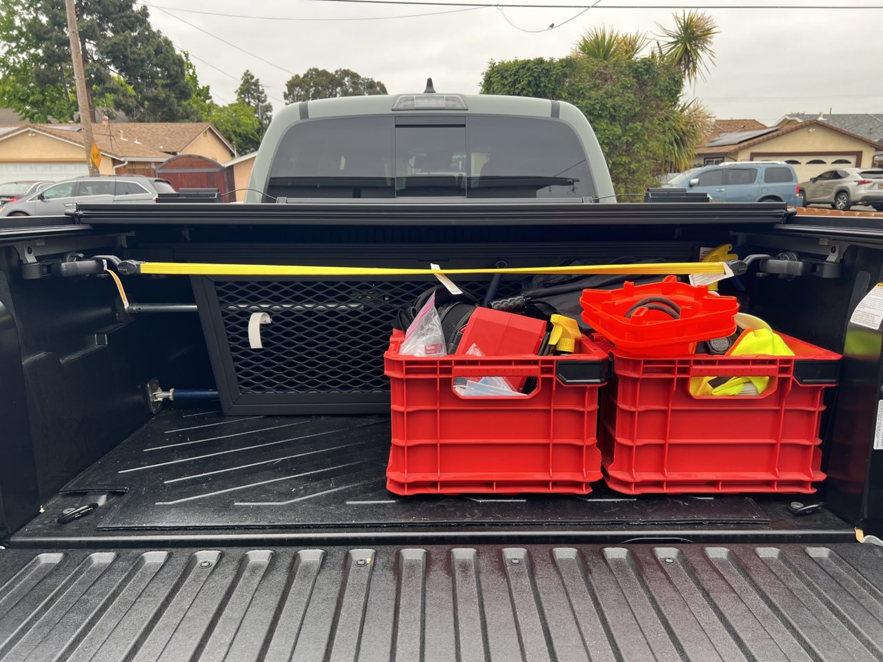

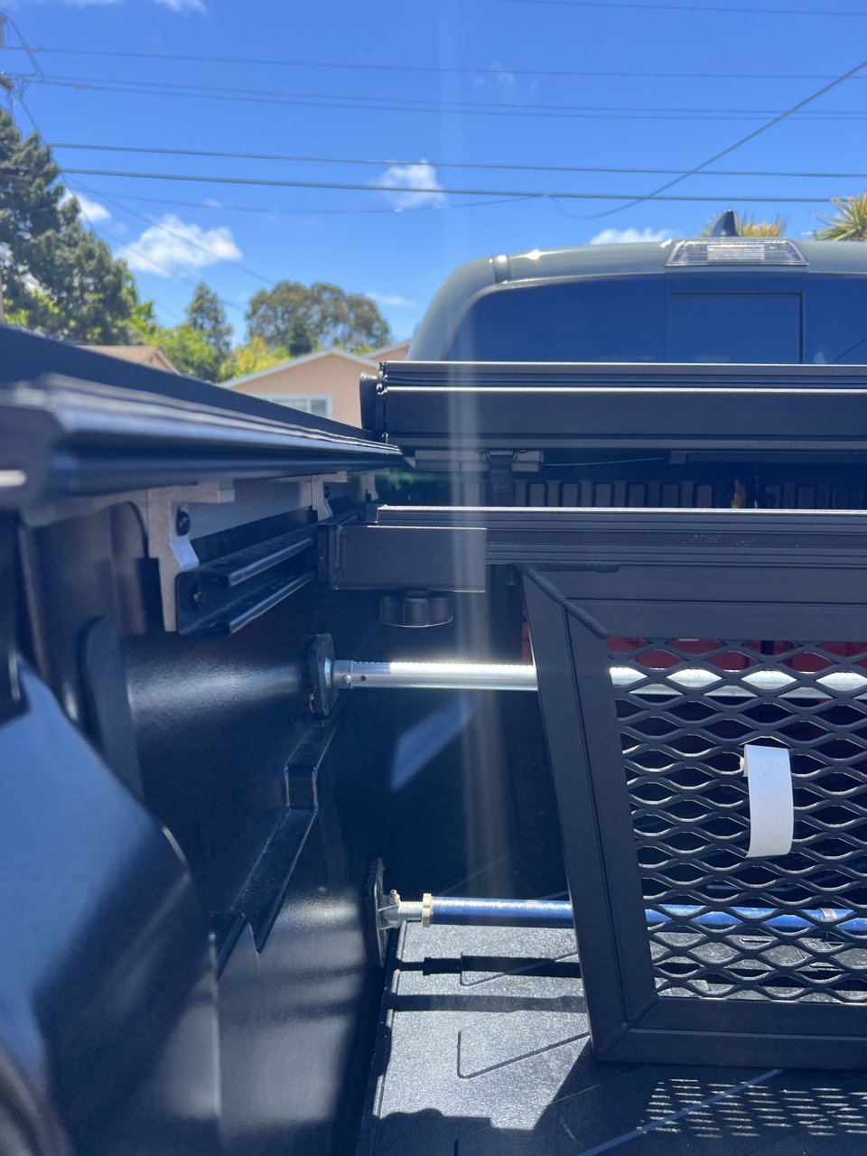

    See photos and parts list. Works like a charm. Trim ends of Cargo Divider about 1/2 to 3/4 inch. Use two washers to sandwich rubber grommets. Two longer bolts (see parts list), 1 grommet per side + two washers per side.
