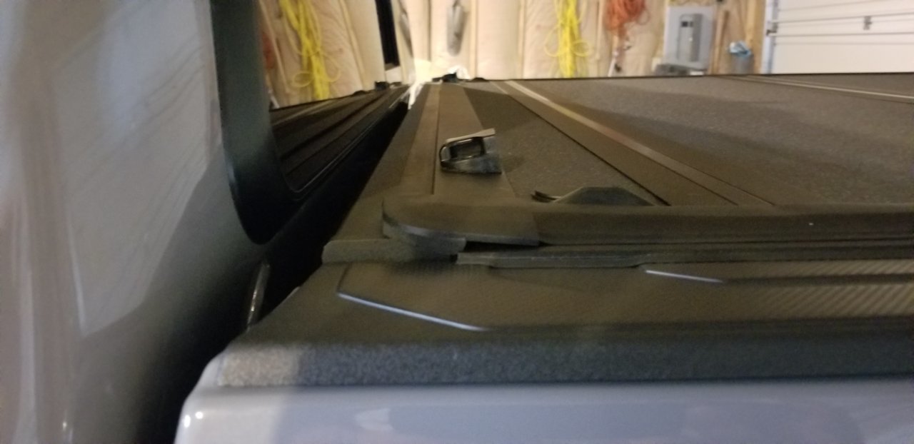

    Hi all! Hoping to get help on the MX4 install. The mfg supplied supplemental install instructions says to apply the enclosed 1/4" foam weather strip on the bulkhead. This seems to drastically increase the gap between the bulkhead and the short panel. I took the weather strip off and it seems way better, however the short panel still doesnt fit flush between the bulkhead and the MX4 side rails. Slight gap. Has anyone else experienced the same? What did you do? Thought I'd check here since bakflip tech help is closed until Monday. Thanks for listening.

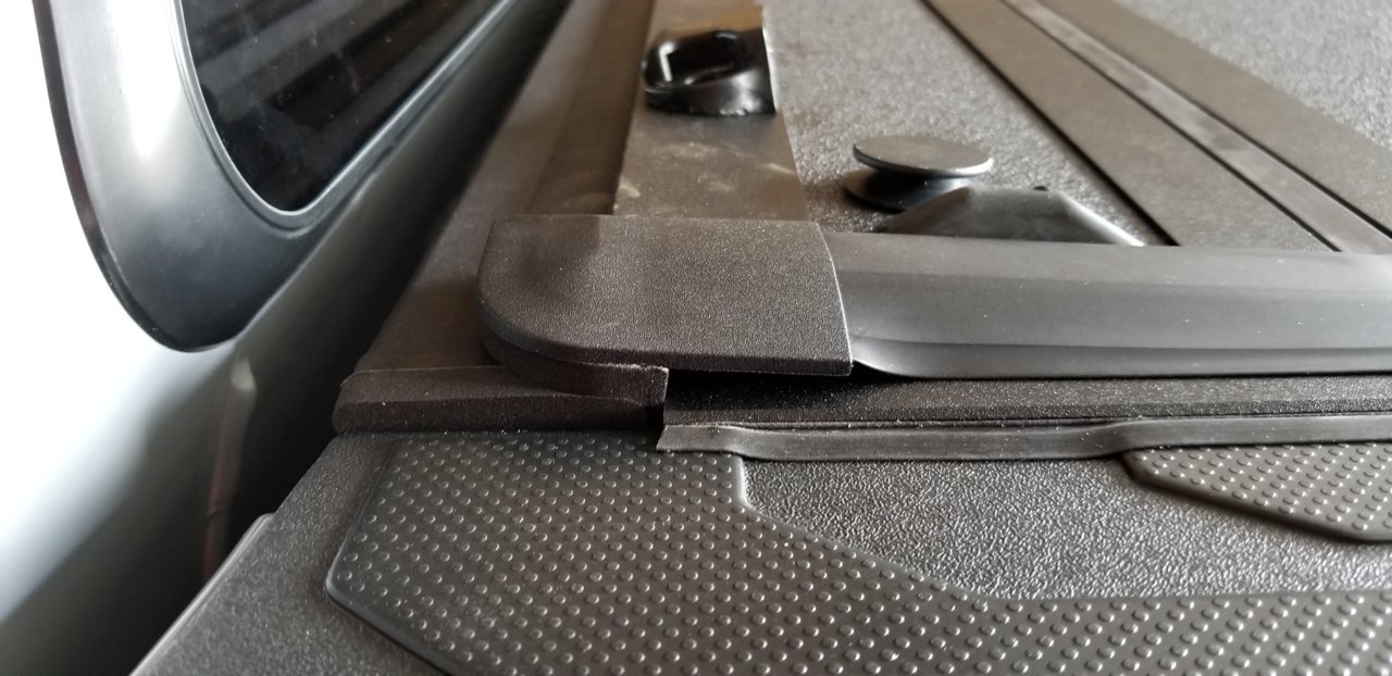

    Thanks for the pic. Likewise, deleted the bulkhead strip. Still have some gap, plan to set in the sun and then tighten down further. BAK Tech said to trim the 90 degree foam on bottom of the corner cap to get a better seal. I'm not going to do that yet. Wait & See mode for now.
