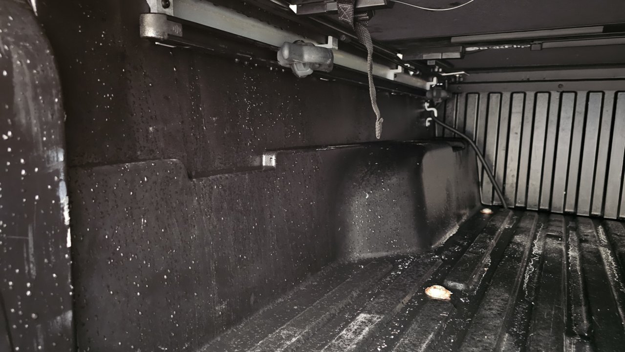

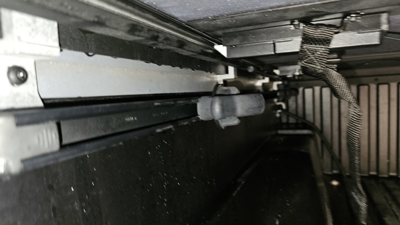

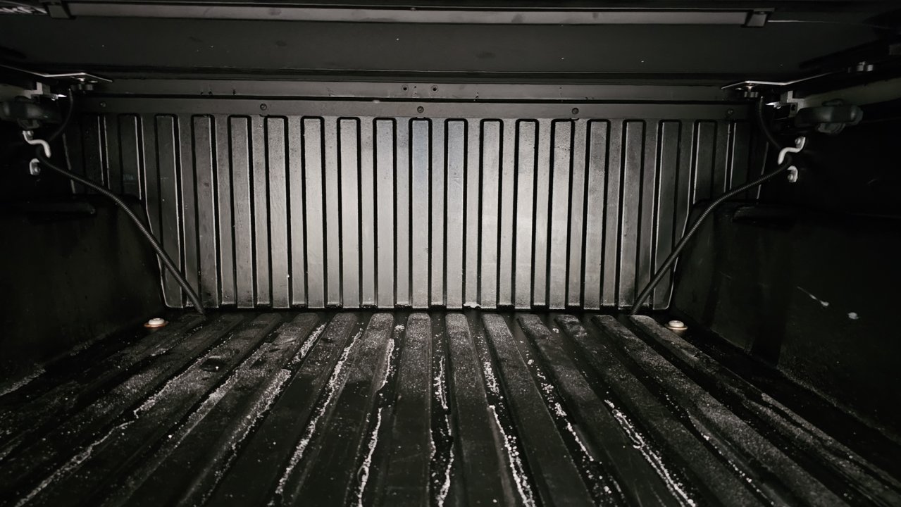

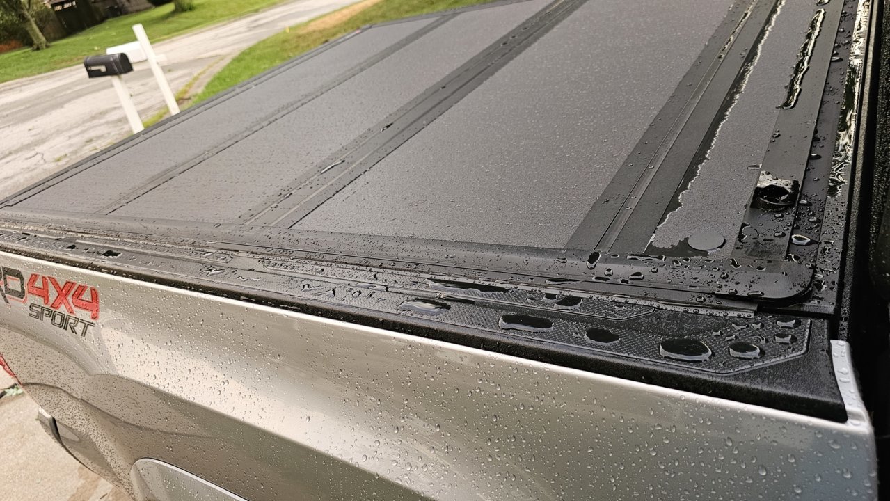

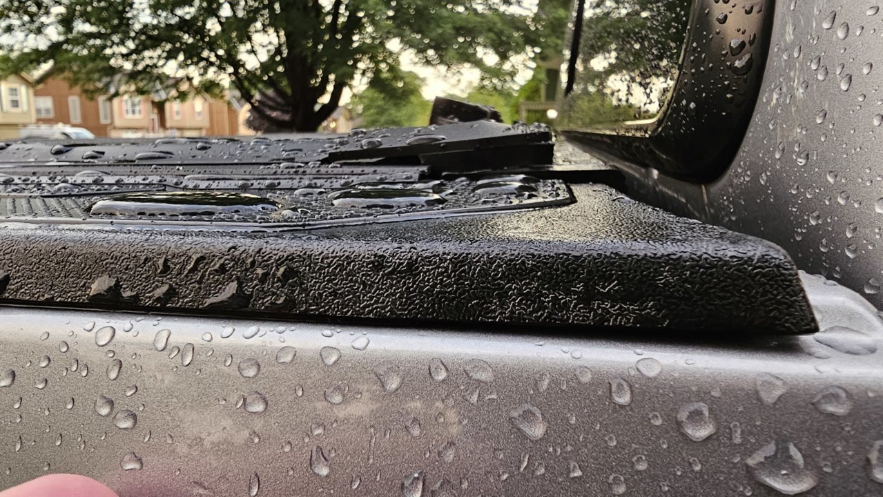

    I just got my new MX4 installed and double checked every install step. We had a pretty hard rain today for about an hour, so I just went out to see how it did. I am very disappointed... I didn't expect this thing to be 100% waterproof but it really let in a LOT of water.
    How much water 'should' this cover be allowing to enter the truck bed? Like I said, I'm not expecting a water tight submarine seal, but this is a lot of water.

    Water is hard to see in the images.
    But that second image seems to show quite a bit of standing water. If so, you shouldn’t be seeing that with a proper install.
    Watch some videos, ensure it was installed properly. Add some more seal from Amazon.
    If you’re still having issues, reach out to Bakflip for support. Is always possible something is faulty in the cover.

    The very first image shows all the water droplets that ran down the inside side of the bed, I'm thinking maybe the rain was coming down faster than the drains could work.

    I see the water, it’s more gauging how bad it is. My Lomax cover can leak at the 4 corners of the bed in heavier rains. Really depends on the storm and whether I am driving or not.
    Imo water is to be expected to a certain degree on the sides of the bed. It’s not 100% waterproof.
    But if you’re getting a significant amount of water in the middle of the bed, that’s a big no no.

    I have noticed with mine, if you don't park with front of truck slightly down hill. The drains can't keep up. Also truck bedrail caps allow water in. I removed sealed them, and as well as MX4 rails.

    I'm going to let it dry, take the mounting rails off and apply a bead of RTV under them. That appears to be the weak point allowing water in under the rails.

    When mine was installed a few weeks ago, I questioned the seal under the rail as it seemed to have gaps. His comment was to give it time in the sun. Well- it's 115 degrees here and it now looks like it seals better. I hosed it down & only water I have is at tailgate. Leaks less than my Leer on my 2nd gen does.
