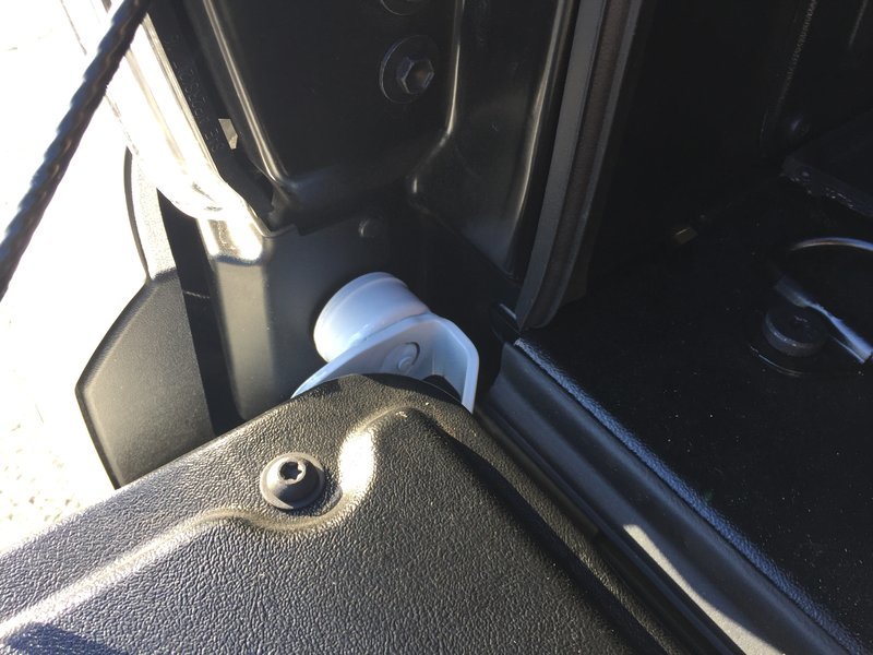

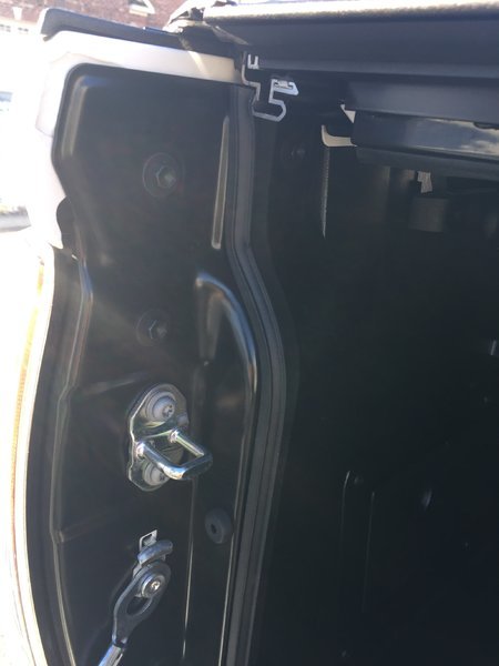

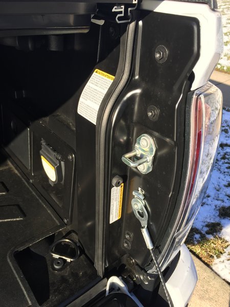

    He has the seal on the sides installed wrong. The bottom seal is correct, It goes on upside down. Look at the above link.

    He did install them wrong, but it seems more stream line than the way the instructions tell you to install. I installed them per instructions but seems weird the way it twists over the curve

    I never thought about installing the side seals like he did, maybe it is better to do it that way. I know my tailgate closed harder the 1st few times I closed it so I know I have a good seal doing it like the instructions state.

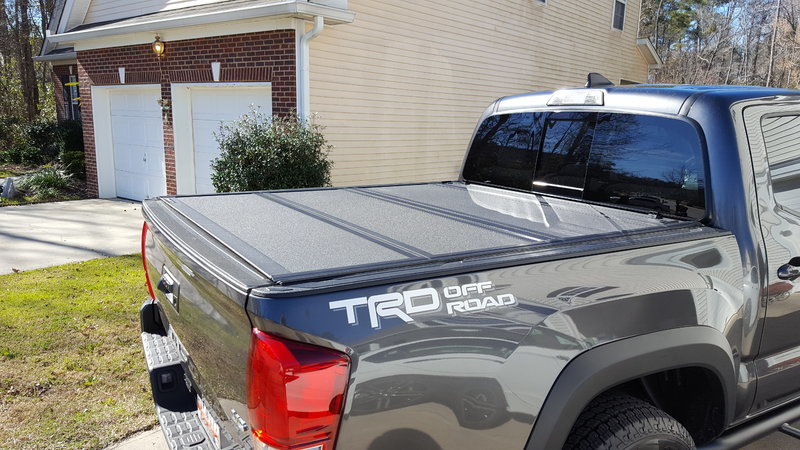

    The one I bought from Auto Customs looks great.
