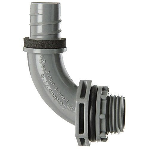

    So... much like what is posted on page 10, I'm going to drill my own hole and install out the side of the bed. But rather than going with all the various parts that were listed in that post, I found something of an "all in one" fitting that is curved to help promote drainage. I really like it. Came from Home Depot as well.
    Same 1/2" inner diameter, but no need for the metal locking-ring as it has an o-ring, and it comes with the plastic locking ring that goes on the outer side of the bed. Get these and just add drain tube. Presto.
    I'll be painting them the same Krylon "hammered black" color that I painted the metal attachment sliders that were in the tonneau kit. Should be pretty slick.

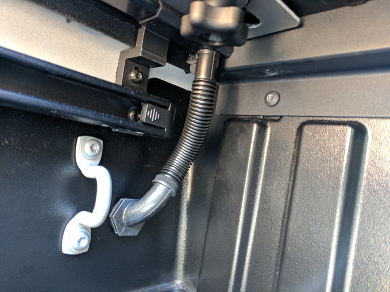

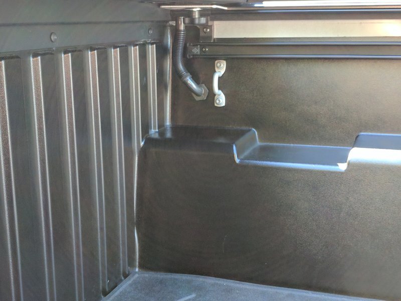

    Finished. And while it may look a bit tight in the photos, there's plenty of clearance to still be able to use the tie-down points. Turned out exactly as I had hoped.

    IMG_2398.jpg This is how I did my drain hoses. Used the brass fitting and caulked all the joints. Cut the tube a little shorter as well for a cleaner look
