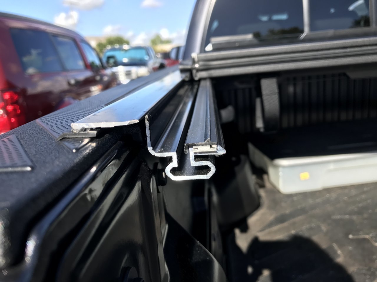

    I looked again and can't see where you would put those thin strips you are talking about. Also, is there supposed to be anything on the ends of the latch rail to keep water from running out of there??
    EDIT: discostu - your rails look NOTHING like mine!!

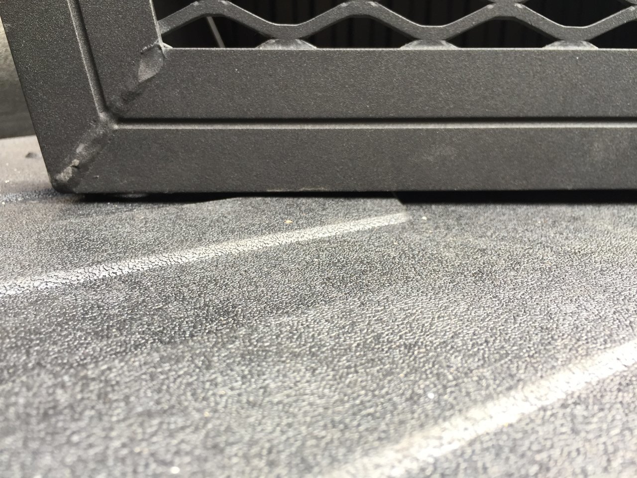

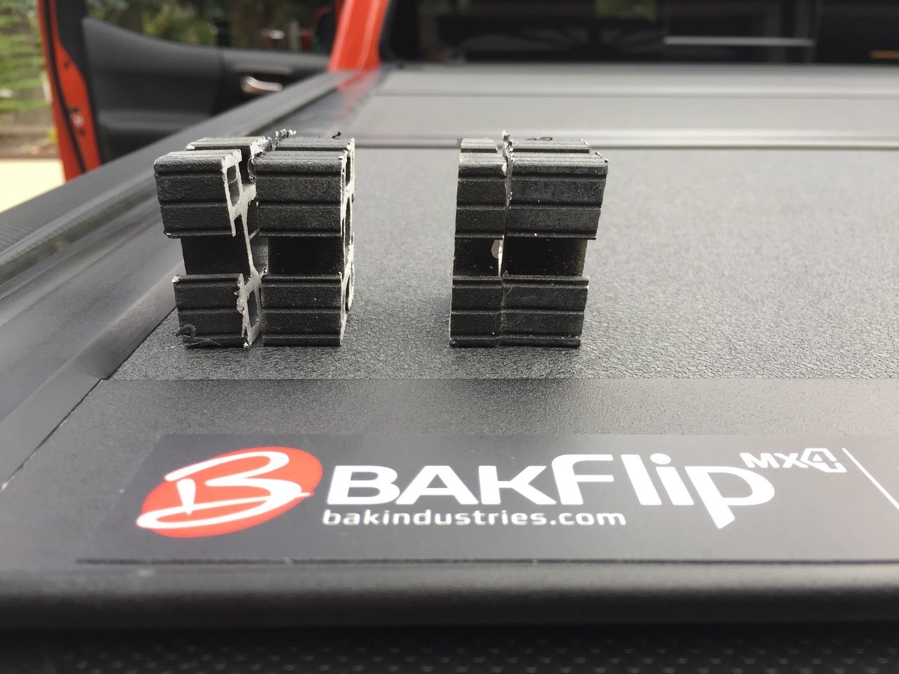

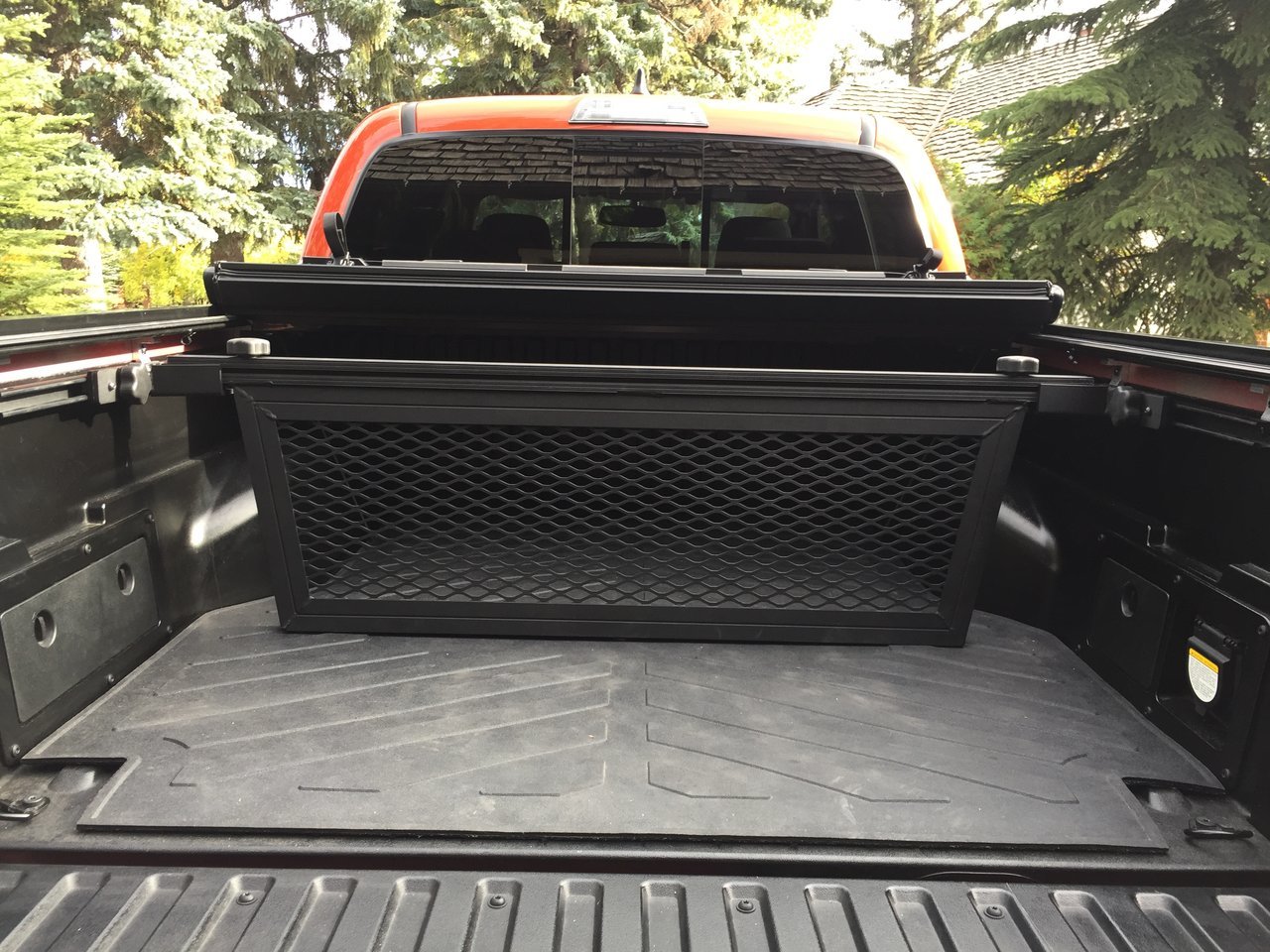

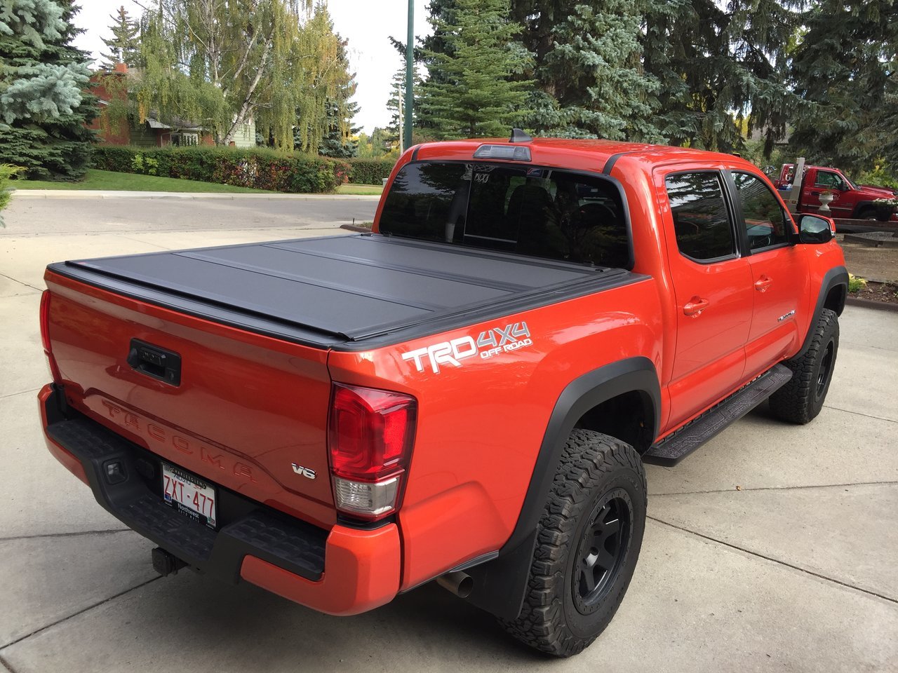

    1/ The BakFlip MX4 can be installed in a virtually water proof manner "Without Caulking".
    2/ The BakFlip MX4 allows uninterrupted use of the OEM Cargo Divider (with a little trimming and shimming...)
    I followed Tecoma's guidance, installing my MX4 using gaskets and weather stripping. No caulking. Took the Taco thru a high pressure car wash. Not a drop of water got in. I may still install a tailgate seal, but for now it doesn't seem necessary.
    I also trimmed the end of my Cargo Divider (took off about 1/2" on each end) and added 3/8" spacers to the brackets (with brackets upside down) to allow me to use the cargo divider. I've already had occasion to slide the CD back to front and front to back for a variety of cargo sizes and it works seamlessly. The only thing I need at this point is longer fastening bolts to accommodate the 3/8" spacer/lift on each side.
    See Pics ...

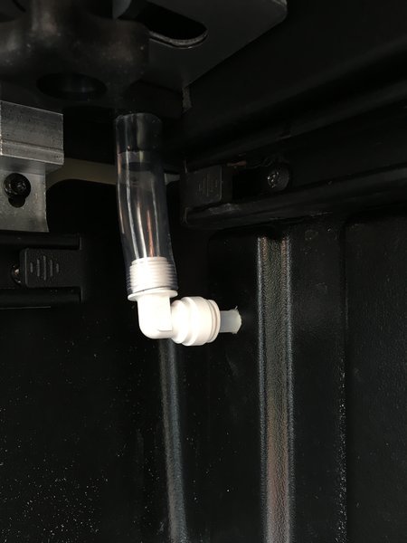

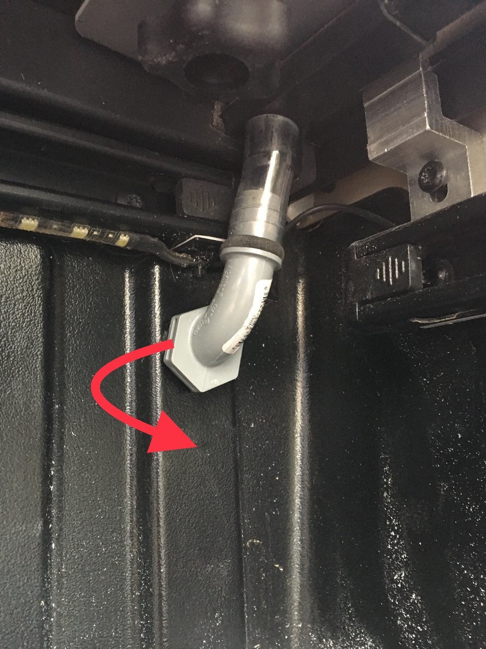

    I was trying to avoid drilling a big hole in my bed and originally installed a smaller drain (see earlier pot). In heavy rains when water can settle on the cover, the drain wasn’t large enough to handle the excess water and I got leaking. I recently upgraded to a solution recommended by another forum member and I’m very happy with the result.
    You tighten the elbow by reaching up between the cab and the bed and use a screwdriver in the nut usning the tabs on the nut I used a short piece of clear hose so I can check for clogs.
    The elbows can be found in the electrical department (with the conduit) at Home Depot:
    https://www.homedepot.com/p/Carlon-1-2-in-90-Liquidtight-Fitting-LN20DA-CTN/100404121
    Note that the offset of the elbow doesn’t match the exit of the drain from the rail. I suggest mounting the elbow and inch or two below where installed mine. I already had holes at this location from the previous drain solution.

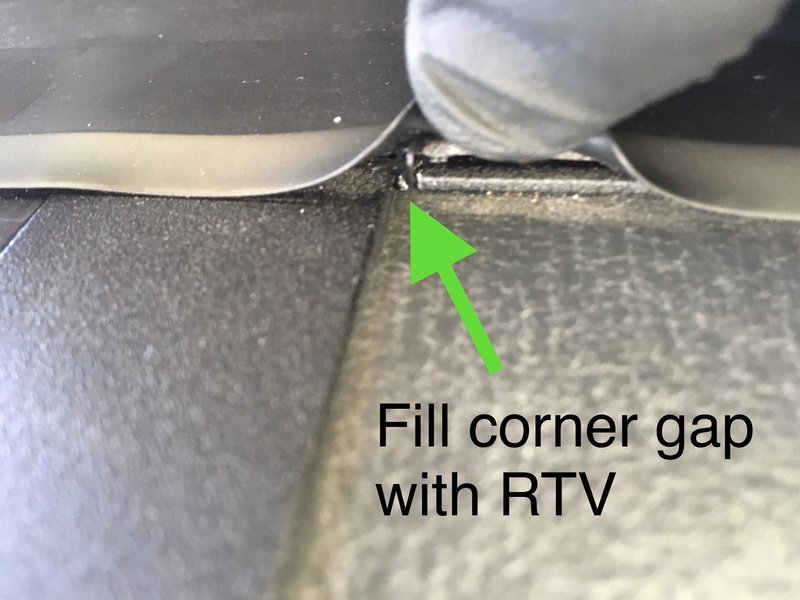

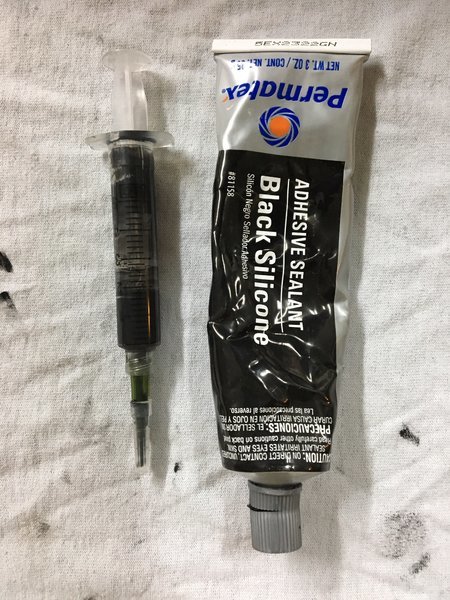

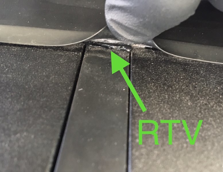

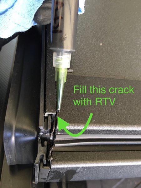

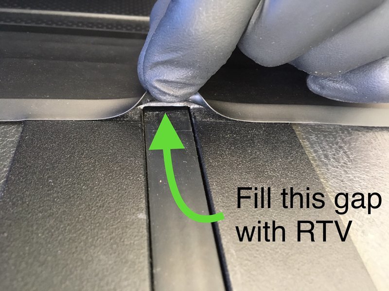

    K so I bought the rtv seal and but it down both sides as well as on the folds that was shown above. Still getting water. Anyone have ideas?
  18. Feb 22, 2018 at 8:44 PM
    #298
    Auroraboy
    Auroraboy Well-Known Member
    Oct 18, 2016
    #200108
    379
    Dave
    London, Ont., Canada
    2017 Quicksand DCSB Off Road
    Husky Weatherbeaters, BAK Revolver X2, front bedrail, Salex console tray, Predator Steps
    Get inside the bed (preferably at night), close the cover, and have someone walk around the truck with a light, and look for light leakage between cover and bed.

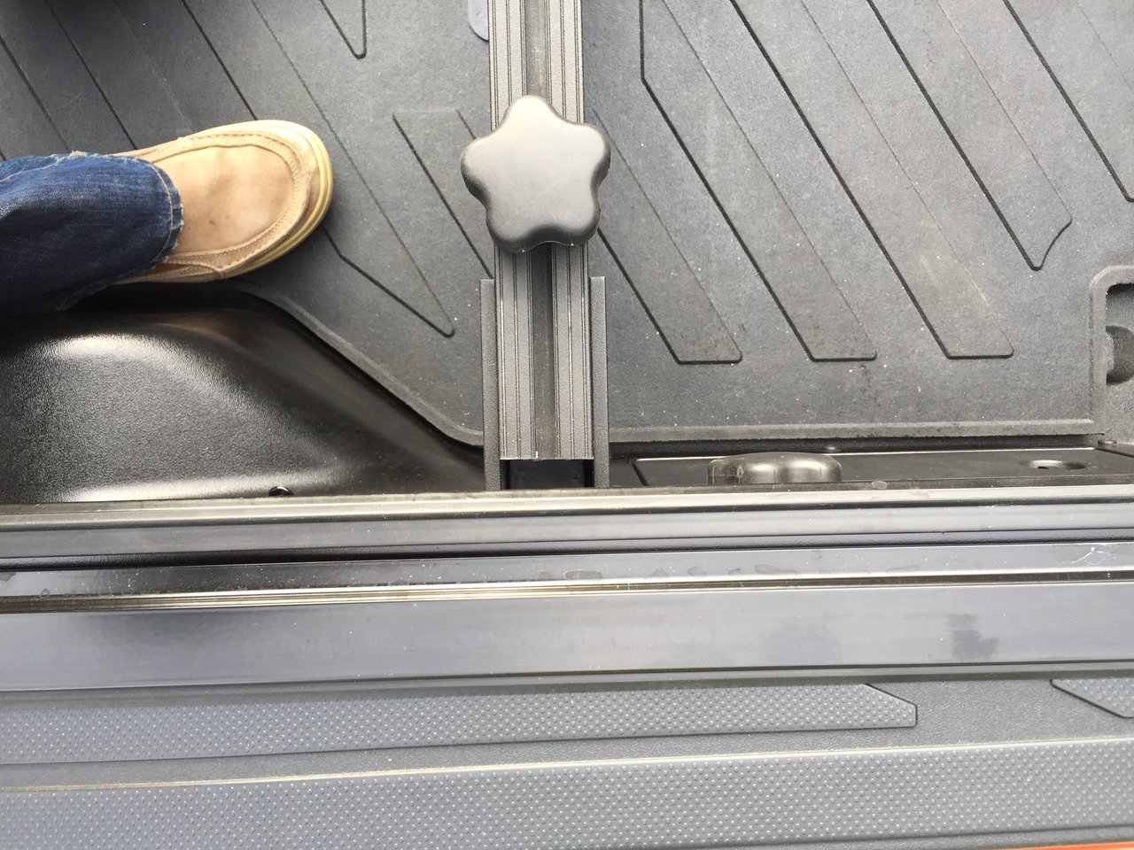

    Off topic but what hardware and knob did you use to mount the jack to the mount itself? Looks way easier than a 3/4” nut

    I think it's more then that
