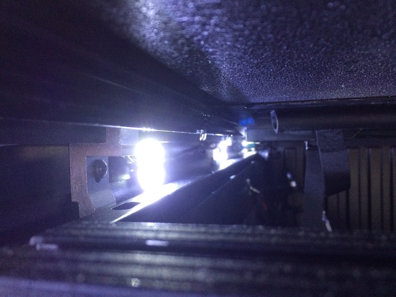

    Ok I'll look for one of those seals. I just took this. Looks like the drip is coming overtop of the backflip rail instead of in behind
