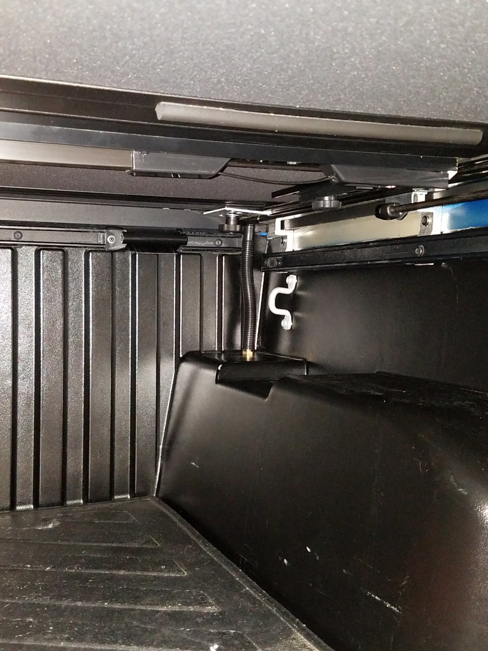

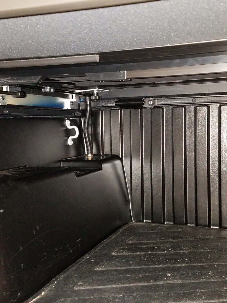

    So I want to get this drain tube problem fixed, but I want to keep the OEM drain ports at the front of the bed open (also because rubber bed mat interference). I'm considering drilling holes in my fenders just below the drains and installing a bulkhead fitting with a 3/4" barb. It's either that or kick it 90° to the between gap between the cab and the bed (I think this is going to be a more difficult option to install). If I put them in the tire wells, I worry about tire wash / mud getting up in and clogging them.

    I did it like this. The plastic inner fenders will keep the mud out.

    What size fittings did you use? Did you tap NPT threads into the bed? Or just interference fit it?

    3/8" I think. Just take the hose with you. I got the barbed fitting and drilled a small hole. Tapped it in with a rubber mallet...

    I know this thread hasn't seen some action in a bit, but just wanted to say thank you for posting this. This completely solved the leaking issues I had with my MX4 - much appreciated!
