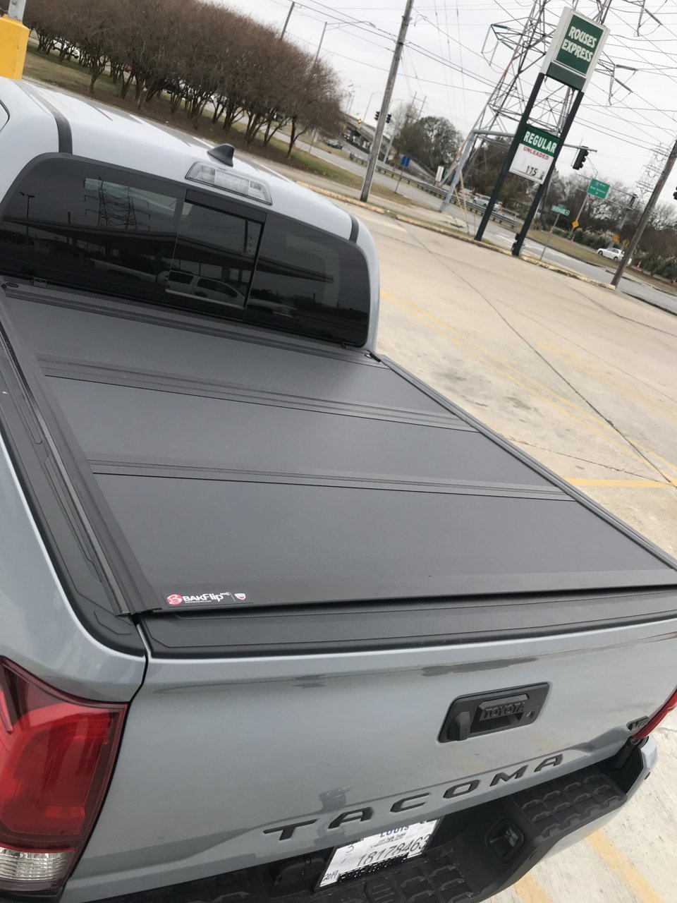

    2019 TRD sport cement
    OME med load 888 springs 285/70 KO2’s TRD pro grill Bed mat Bck flip max 4 bed cover All weather Mats LEDs inside and out Yellow fogs
    So far I love Mine also. But I do want a shell done the road.

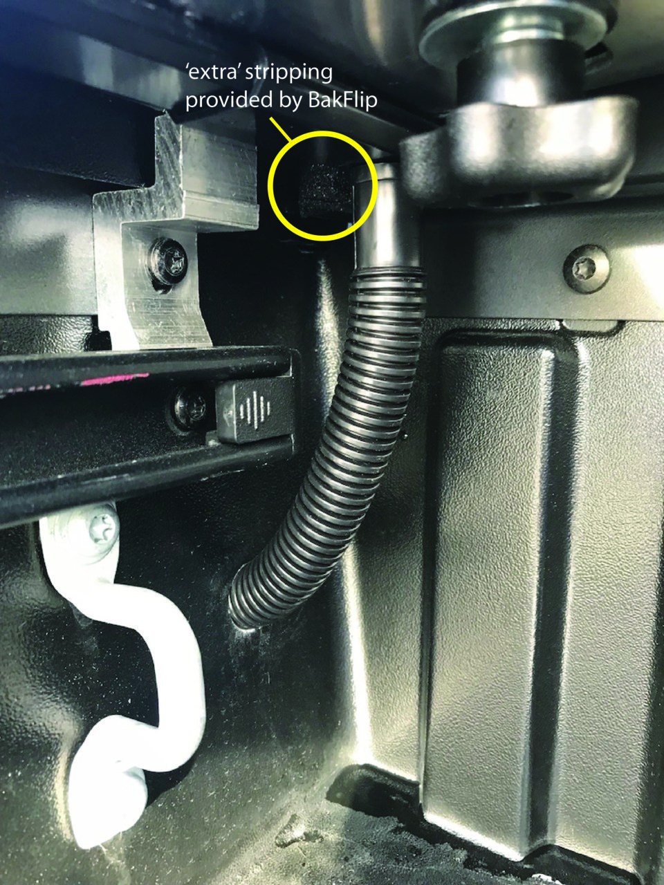

    I noticed there were gaps between the side bed rail caps in both corners in the front of the bed. The easiest way to find them is to install the cap and look for where the light streams in this area. I used some of the ‘extra’ stripping from the BakFlip install kit to seal the gap. I basically just shoved it in. You can barely see some of it installed in the corner in this photo (circled). @tekoma post #121 has a better picture of this gap with the cover off. The less than ideal, shoved in stripping has been doing an OK job keeping the water out, but I’ll probably replace it with something more elegant when I find time. Some of the others in this thread have used RTV or other sealants to seal this and other small gaps in this area.
    The photo also shows how I installed the drain tubes. I drilled straight into the side of composite bed like @2017TACOPRO and @discostu did (in posts # 181 and #263, respectively) using a conical bit. I did this for two reasons. 1) I didn't want the drain tubes going straight down to the drain holes in the bottom of the bed like Bakflip suggests as I was concerned they would get smashed by things I was hauling in the bed. 2) Also apparently the fuel line runs underneath the bed and there have been some instances where it was punctured when widening the drain holes.
    I actually bought plastic electrical conduit elbows like @17Blue_Taco (post # 202) and @tekoma (post # 290), and @Metonymy (post #226) to do a cleaner install of the drain tube. However, I had trouble getting the bushing screwed on the outside (fender side) of the bed. I’ll probably try again once it gets warmer out.
