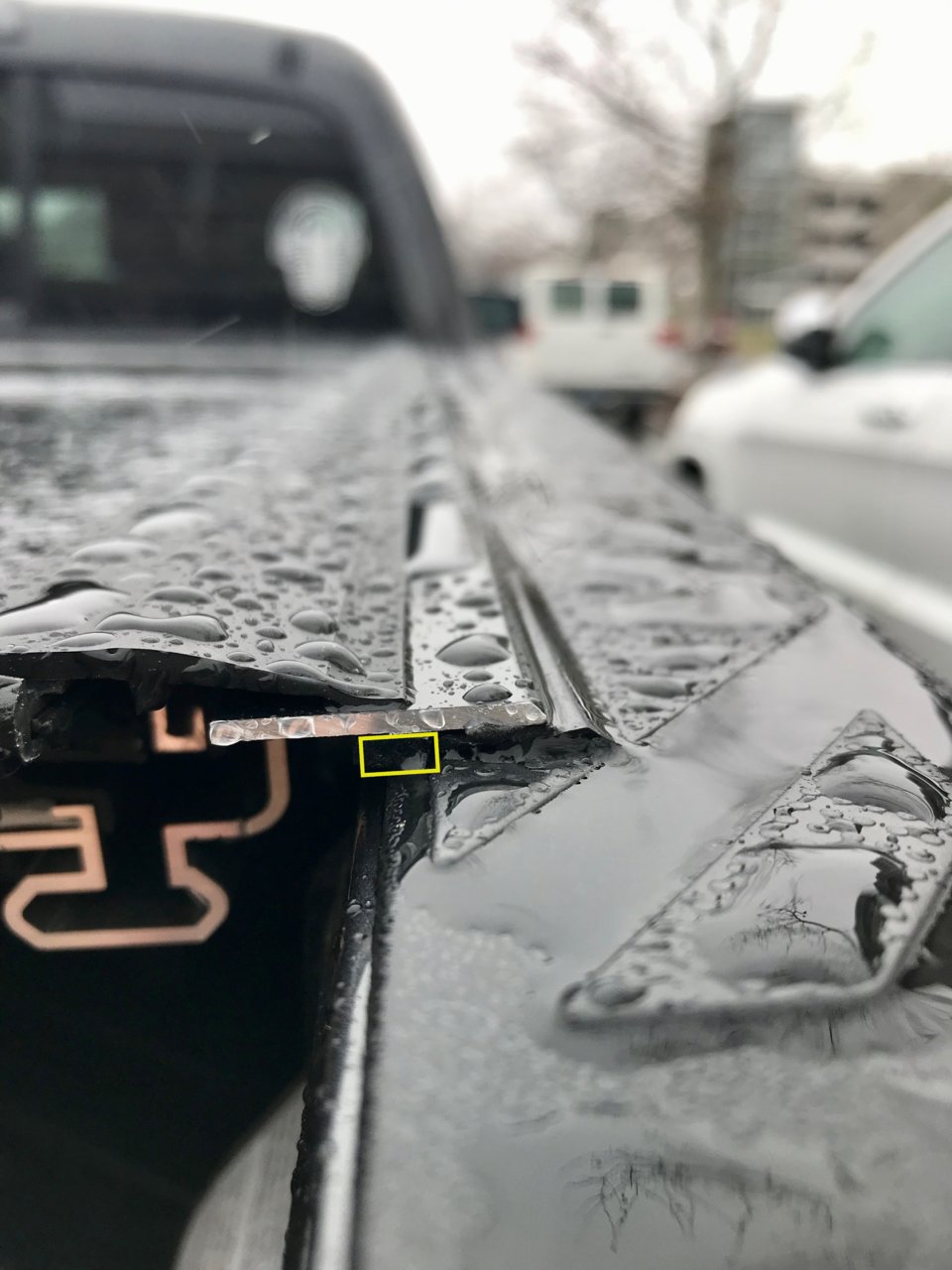

    I haven't had that problem with the size stripping that I used. When I tightened the cap rail down it compressed enough so the seal on the rail made good contact with the top of the bed.

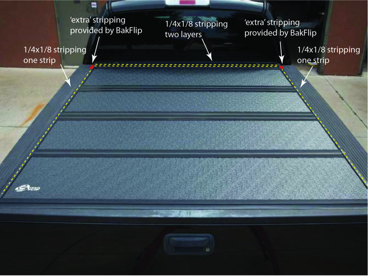

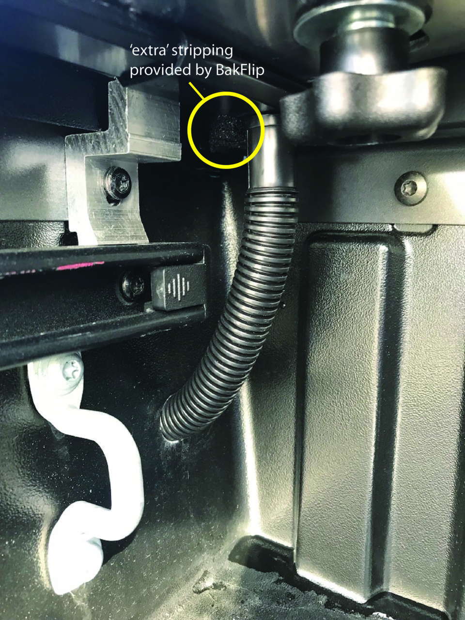

    From my experience, stripping definitely needs to sit in the 90 degree angle of the rail where it meets rounded 90 turn on the bed. There it basically fills the gap created by the rounded edge of the top of the inside of the bed. This is displayed well in post #114 by @tekoma in this thread. Here's a not great picture of the rail from the back on my truck to try and show where I placed the stripping on mine. I've highlighted the position of the stripping in the second pic since its hard to see.
    Also of course it was pouring when I went out to take the photos. But I can confirm, no leaks. Hopefully this helps!?

    That does help, I appreciate the pics. My seal for some reason looks a little more flat at the end and the stripping I used was thicker so that could have been my issues. I have ordered the one you used and will keep you posted on install later this week.
    Thanks bcgill for the info!

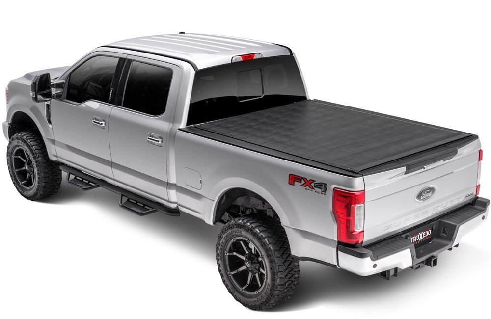

    I didn't go the BakFlip route... Popped on a TruXedo Sentry instead. Buddy has the Sentry CT which is the matte black woven fabric on his new Tundra. Like the functionality of the Sentry cover's.
    And again...Morrie gave me a heck of a rebate! :)

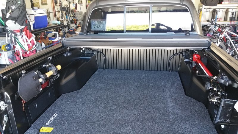

    Can anyone with a back flip tell me the amount of bed space available when the cover is folded on itself and flat against the bed rails. (Just as it is in the photo, SHORT BED) I am hoping to be able to have it in this setting and clear the back tire of my bike when it hanging on the tailgate pad. Maybe a measurement from the tailgate lip to the cover?

    About 34” from tailgate lip to folded cover as it sits in your photo. Short bed.

    I am assuming the tailgate lip your referencing is the lip facing into the bed towards the cab, not the farthest back point of the tailgate?

    Yes, to the inside lip of the tailgate, towards the cab.
