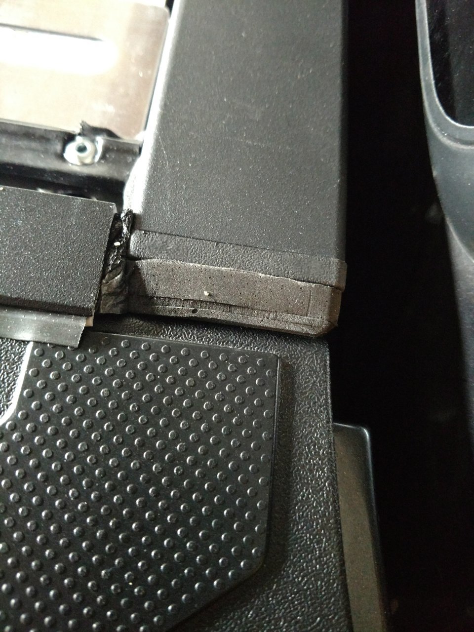

    The MX4 got installed on my 2019 DCLB today. The only remaining task is to drill holes and run the drain tubes. I was going to try the install without any additional seals, but thanks to all the advice on this thread, I opted to use some small window seal during the initial installation.
    A few issues popped up during the install...
    I painted the bare aluminum tie-down rail mounts a couple days ago. But when I removed the rails, the metal behind the rails had some primer overspray which would have been visible, so I took the time and that got painted too, causing a couple hour delay.
    The bulkhead still had a gap on the passenger side even after the block seals were added. To fill it up, I added some layers of adhesive foam sheet. I also stuffed some of the useless BAK weatherstripping foam in the other gap to fill that in as pointed out in previous replies.
    When I added a seal to the bulkhead area, that front panel appeared to be tilted upward. The cover is installed with no seal on the bulkhead. If it ends up leaking there, I’ll take it off and add some.

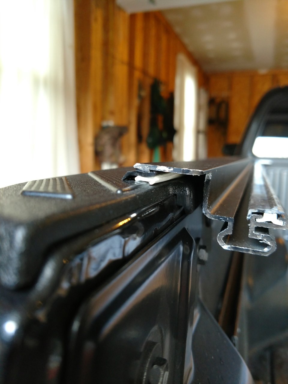

    Here is the type of window seal I used:
  15. Mar 20, 2020 at 8:27 PM
    #455
    tayb0w
    tayb0w Member
    Feb 2, 2020
    #318027
    13
    LT
    2019 Tacoma TRD Sport
    Whoops, pic didn’t post. It is a white, D-shaped seal that is hollow in the middle and very compressible. 5/16 wide on the adhesive base, and 1/4 high (but compresses down to 1/8). I stuck it in the same location recommended by Tekoma in reply 119 of this thread. Here it is after tightened down...

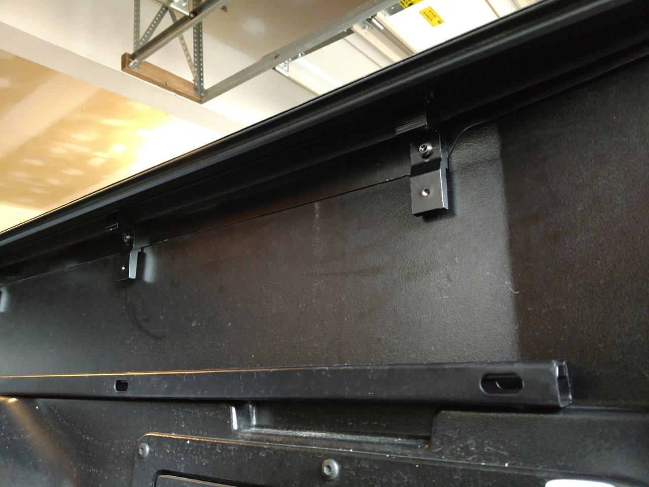

    Here is the painted rail brackets installed on the newly painted metal as mentioned above...

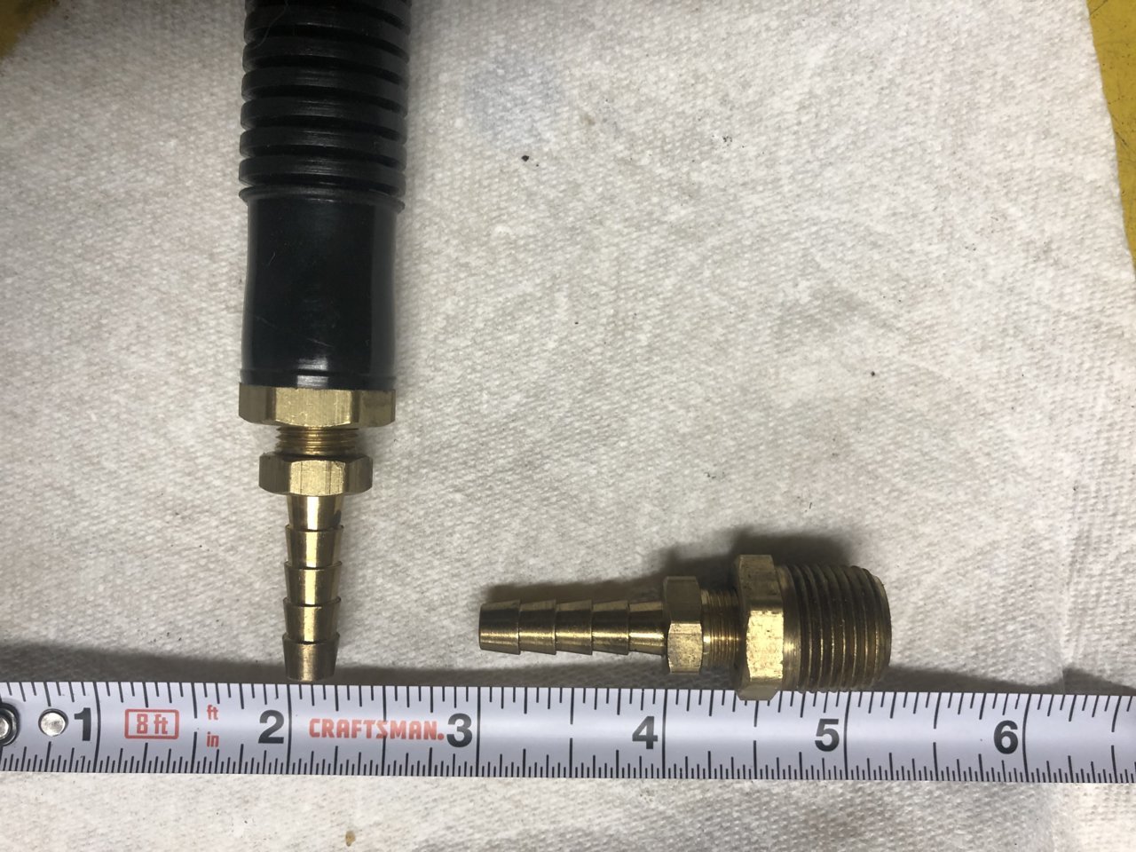

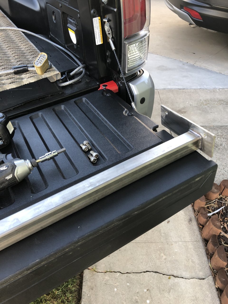

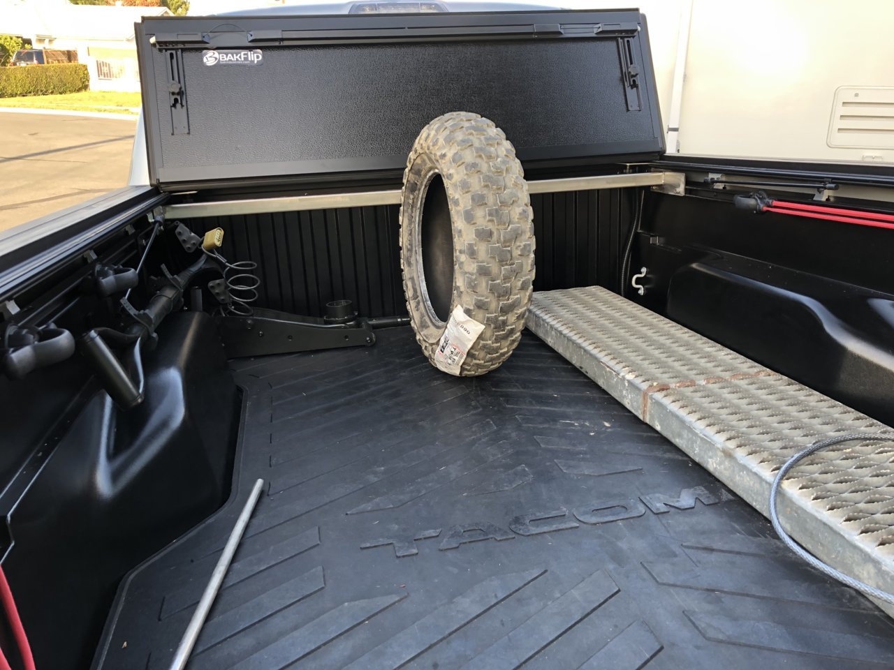

    I’ve installed the BakFlip and routed the drain lines through the existing bed drain holes by adding a fitting.
    I used a 1/4” barb x 1/2”npt fittings to reduce the 1/2” bakflip hose to fit the existing 10mm drain holes in the bed. They fit the existing holes loose enough that the bed will still drain too.
    A bigger issue for me was the Bakflip is promoted as a M/C hauler but you can’t load against the folded cover, so I started fabbing up a bed bar. It mounts on the rails and if needed I can mount a kicker going forward.
