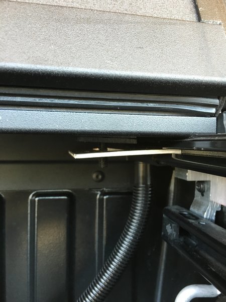

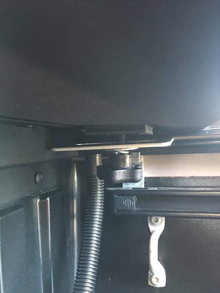

    Installed on Saturday. Paid $939 only because I was able to pick it up same day from 4 Wheel Parts in Compton. Only real issue I had was the last part with the knobs that clamped on the metal plate and held down the very front flap. I had to have someone push down from the top so I could get the screws low enough to get any bite. Not sure if this was something I caused but after that it all fit snug. I still need to drill holes for the drain tubes

    Did your elevator bolts go straight down into the holes or were they going in at an angle? A new cover and I had to have someone hold down the top while I pushed up to get any bite on the bolts...Very difficult.....If at an angle, the rubber washer and flat steel washer may end up moving and go into the oval hole....not good.....stress could snap the bolts.....

    The bolts did go straight down. It was the plate on the rails that seems to be off, angled down a little bit. Maybe I tightened down the rail at an angle. I will be going over it again to day and see if there is anything I need to do differently.

    This what I am working with. Maybe someone can help

    I am getting a completely new system...BakFlip has been great with my problems and issues....they know there is a design issue in the side rails not keeping water out...Also, there maybe water intrusion on/around the panel folds when you raise and fold them back.....The cover really looks great but.......
    with your pictures, they show an obvious distance and bend from the cover....this when tightened up, will really put pressure on the rail flap and maybe one issue of the leaking problem....I believe the hole for the elevator bolts should be 9/16" dia and closer to the bed, thus relieving more pressure on the flap.....the bolt should also be ¼" longer.....the gap in the flap is bigger to allow easier inserting....Just my 2-cents.....I ope the new system works...I would hate to have to get the $1495 OEM cover....I like this one because it allows you to fold all the way back to the cab window giving you more access to bed.
