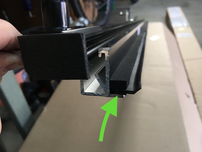

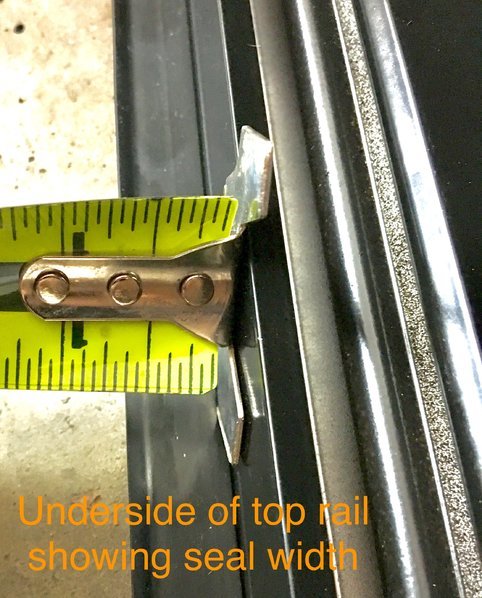

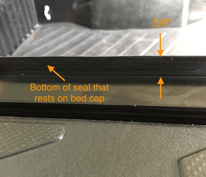

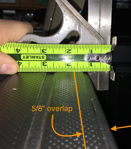

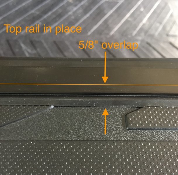

    Received my MX4 week. The cover looks even better than I was hoping. Unfortunately I wasn't able to install it - the box the rails were shipped in was ripped open and there was damage to the rails. I decided to scope out what may be the source of everyone's complaints regarding the leaking issues. It's pretty clear that it relates to the textured bed cap and minimal overlap of the BAK cover top rail.

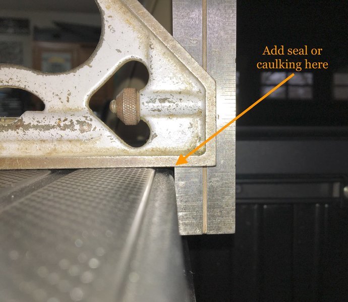

    There is only a 5/8" lip with an integrated seal that sits on the textured plastic bed cap. When you take into account the radius of the edge of the cap, only 3/8" remains. Further factoring the texture and recessed areas along the cap, it is seems that there just isn't enough overlap to provide a suitable seal.
    See pics below, hopefully this makes sense. I think there could be an easy resolution by filling the radius between the bed cap and rail seal. I will buy an extra seal from McMaster.com. I'm trying to avoid Adhesive. The cover came with a thinner "double width" bulkhead seal and a thicker seal. The instructions don't have a description on what to use the thick seal for. I called BAK and they said it's just "extra".
    I'll update everyone later on what solution I choose.
    See below for some pics for anyone that may be curious.

    "I'm trying to avoid Adhesive." Been there, done that. Tried to add weather stripping types of seals to fill the gap but it still leaked. Now reinstalled with silicone and all is dry. Hope you have better luck than I did.
    I've let BAK know that if they had just tossed a tube of silicone in the box and updated their instructions to read "some vehicle applications require the use of silicone sealant to minimize leakage" there would be much less drama.

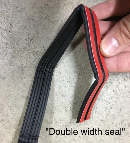

    You only need to use the thinner "double seal" for the bulkhead.

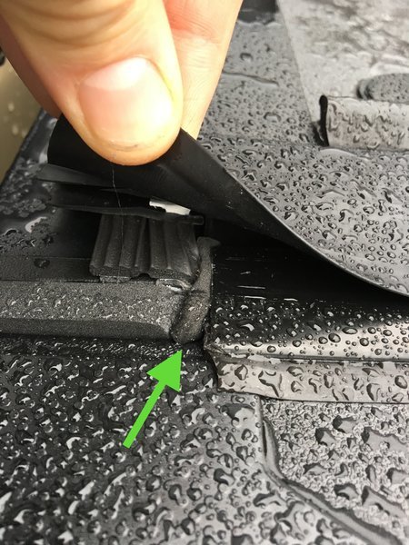

    The thicker seal is just "extra" according to BAK. I ended up purchasing and installing another seal under the rail seal. As noted in my previous comment, there is barely any seal contact with the integrated seal. This is what I did (it is working very well btw although if someone copies this idea I suggest using a slightly thinner closed cell foam - I suggest using 1/4" wide by 1/8" thickness...I used 3/8" wide by 3/16" tall.)

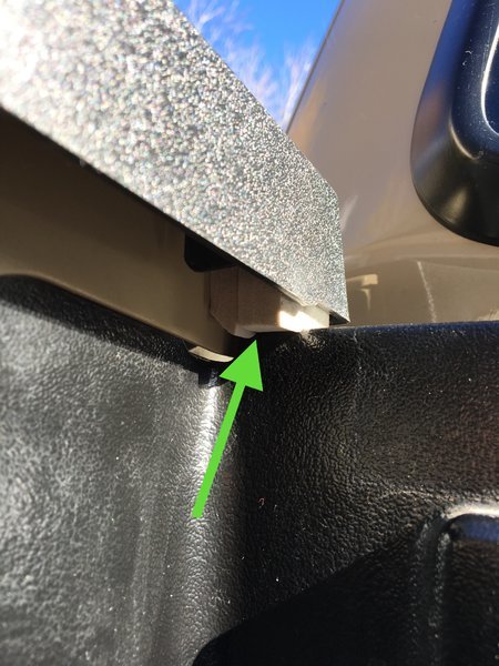

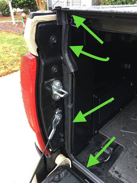

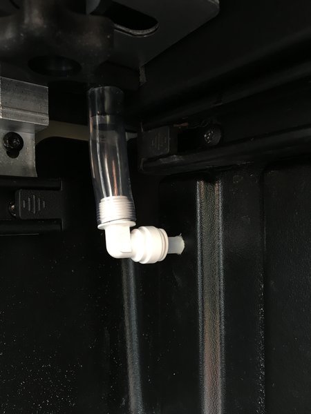

    Here are a few other things I did for my install:
    Stuffed 3/16 EPDM seal into gap at front (could have pre-installed on front of rail):
    Stuffed gasket under bed rail cap at front:
    Tailgate gasket kit:
    Then even though it was already raining, I pulled out the hose. No RTV, minimal leaking:
