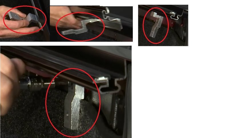

    The top of the bed rail sits higher on gen 3 versus gen 2. That said I'm pretty sure the stock position of the rail at the same height (from the bottom of the bed) for gen 2 and gen 3. Therefore using the gen 3 brackets would end up making the rail sit even lower in the bed if used on a gen 2. Does the gen 2 rail have the track that's accepts the brackets?

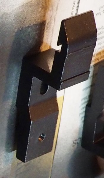

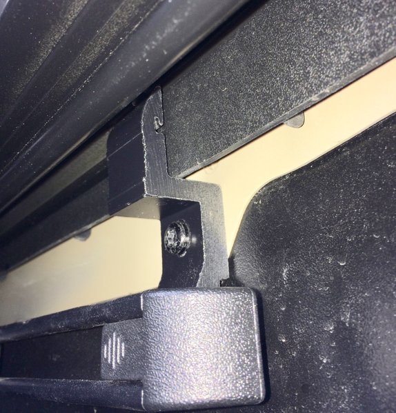

    Here is what the bracket looks like. Mine is from a Bak Revolver X2, but I believe the brackets are identical for the MX4. I painted mine black, before installing. It is shown in the orientation it sits against the bed wall. The lower threaded hole is where the Tacoma bedrail mounts to. The middle hole is where the bracket is bolted in to the threaded female fitting in the bed wall. The very top is tapered, and also has a notched channel, and it slides into the Bak rail for 3rd gen. Unless your Bak rail has a matching male profile to the female notch on top of this bracket, I doubt it would fit. I also found a close up picture of the bracket mounted to the Bak rail.

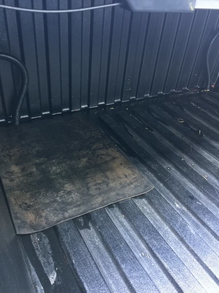

    Bakflip MX4 is just a mess! It finally started raining hard here in Cali and bam check out my pictures. Did some of the options here to help with the leak but still no success. I really dont want to put the sealant. I want refund!

    Sealant is the only way to really fix it. I have the G2 and using sealant and some thin rubber window weather rubber gaskets under the OEM bed cap took care of my leaks.

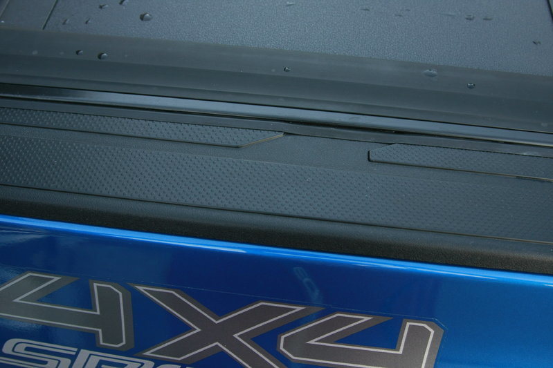

    I don't know about the tailgate gasket, mine is a G2 and did not come with it. With the design of the Tacoma plastic bed rails, it is pretty tough for any bed cover to be leak free. I had the OEM one and there was no way to seal it like the BakFlip, that is why I got rid of the OEM in favor of the G2. I knew it would leak but at least I knew could seal it. I still have to add a little silicone sealant at the front left corner because I still get a few drips there, but the rest is dry! I love the cover now but you just have to put in a little extra work to get there. I don't have any gaskets on the tailgate and I am leak free there.
  14. Jan 12, 2017 at 12:00 PM
    #134
    BruceH
    BruceH Well-Known Member
    Jan 30, 2016
    #176575
    54
    Bruce
    Dallas/FT Worth Texas
    2016 Blazing Blue Pearl TRD Off Road 4x4
    Here is shot of the gasket I used that I bought at LOWES. Before I took my BakFlip off, I marked the edge of the overlap of the cover with Blue painters tape so I knew the boundary of where to put my bead of silicone. It also made cleanup easier where the sealant oozed out.
