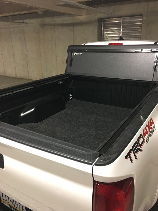

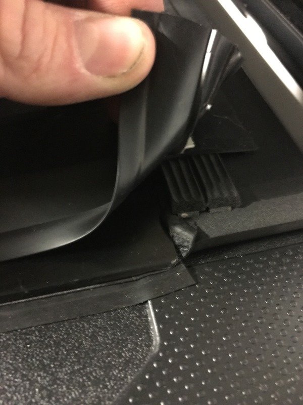

    Just wanted to bring this thread back incase anyone is still looking to pick one of these up. I installed mine today using a few of the tips i found in this thread, mostly from @tekoma . I added a strip of some epdm along the side rails, and put a nice sized piece of the "extra" seal that bak sends between the side rail and the bulkhead. I also did use the bulkhead seal. Also added a picture of how i did my drains. i didn't feel the need to go out and buy anything different, i just put them out the side of the bed so they didn't interfere with my bedrug. Ill report back after it gets wet, fortunately for me i do park in a garage though so I'm not SUPER concerned with a little leakage.
    174D2BEC-F8EA-4CA4-ABA2-87662730604E_zps_3eae845fcaa7081d28e11c9e2cbc769975a18f27.jpg
    134A89A3-F24F-4741-AF8D-3F4CCABBEFAD_zps_3711ccb7db946adfaf06cfa206e9fa315a885bbf.jpg
    8D56E235-4884-4433-B2CD-B93893FB58DA_zps_c4c7f3e9035648aa468bafaac613dbbfec32bc91.jpg
    605C46A7-6DF2-46DB-A165-B8D85B71FEDE_zps_7de160f1b300d3b48323c4f5176e6b2e0d79fb72.jpg
