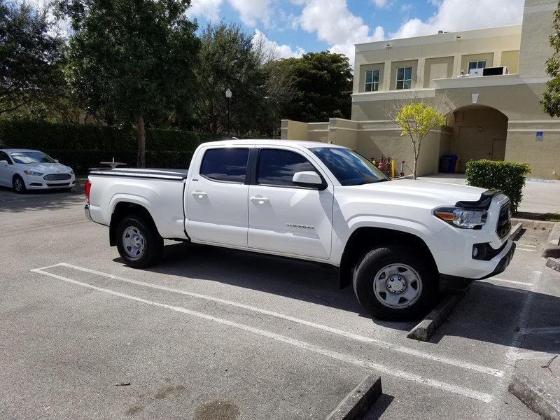

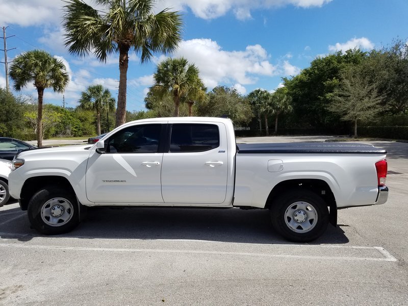

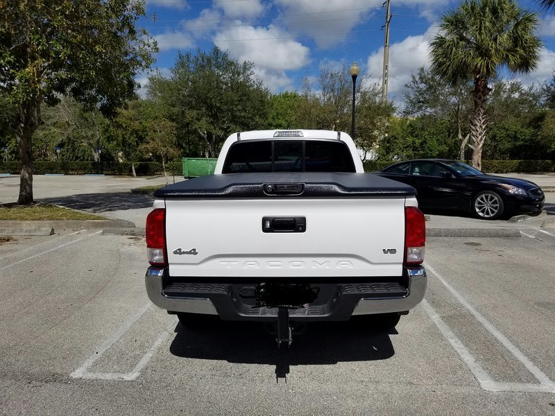

    Agreed...may be out of my budget also. I am waiting for wholesale pricing from a friend. Can you post a picture of your elite on your truck from different angles. It would be great.

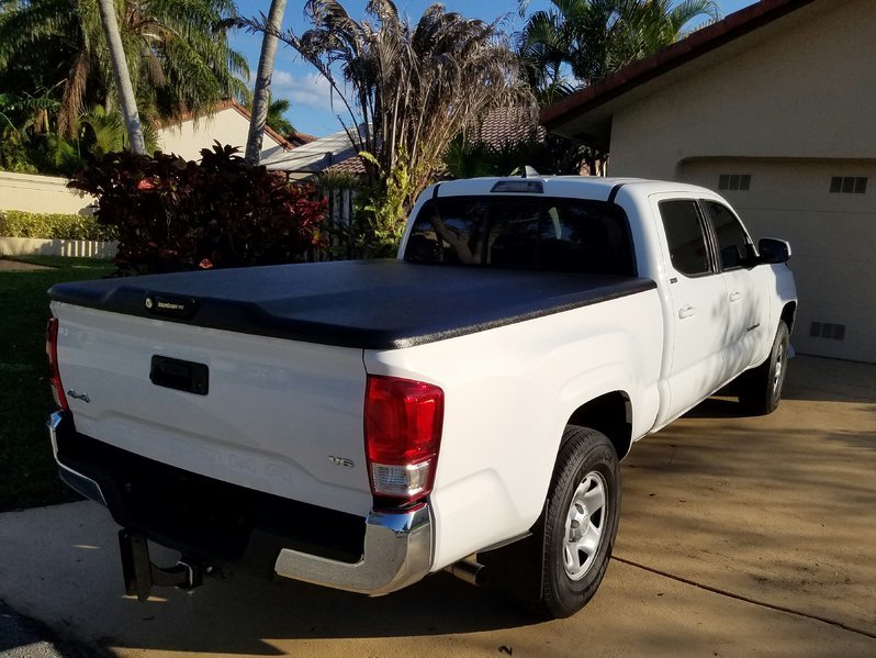

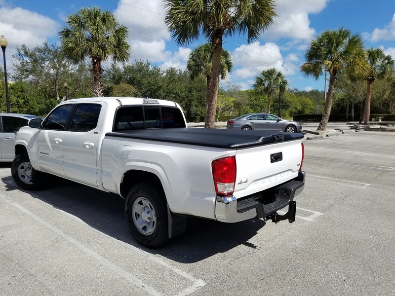

    It's dark out now, but these 2 pics can give you an idea. Not the nicest of angles, but will give you a general idea. I can take more tomorrow if you need.

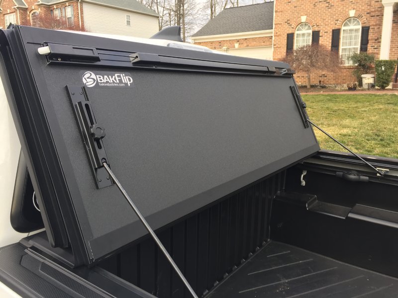

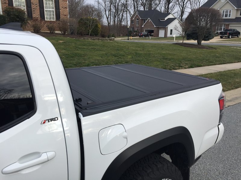

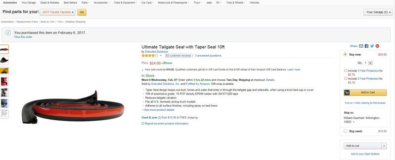

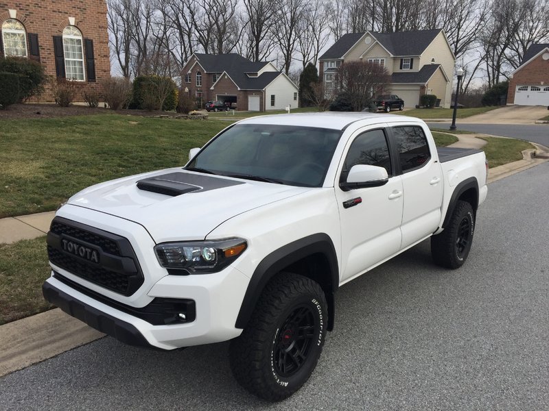

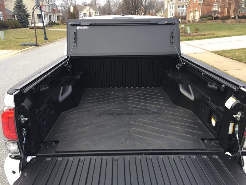

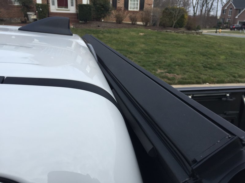

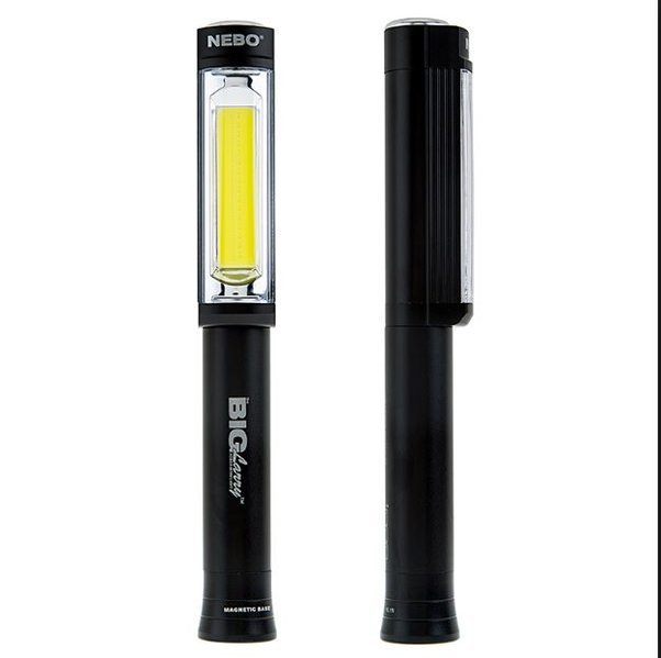

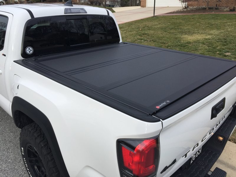

    I Pulled the trigger on the BAKFLIP MX4 based purely on the look and ease of operation. The issues I read about water getting in did scare me however most tonneau covers I have read about do not seem to be completely water proof. I learned enough from other guys on this forum that water intrusion in fixable. I had a local shop "Audio Works" order and install the cover in less than 24 hours from time of contact with them. A co-worker recommended them and they did the deal for $899 installed. They didn't drill holes into the composite bed because I was not sure where I wanted to run them. I may choose to use the kits black tubes and them directly to the sides a few inches below the top so there is less of a chance of tubes interfering with cargo. I carry two "Big Larry" LED flash lights with built in magnets so they work perfect when the cover in flipped up since the bed light is of no use now. The front corners of the bed have flat corners that serve as perfect mounting locations for the bad boys.
    As soon as I got home I climbed inside and observed light visible in the both front corners. I used the listed black 100% water proof and flexible silicone purchased from Home Depot and pumped a generous amount into the crevices. The top rear corners where the tailgate connects to the bed also had light shining through. I ordered a tailgate seal kit from Amazon and plan on installing same when it arrives. I will post the results when its gets it first car wash or heavy rain. So far I love the way this cover functions and I believe it will serve my needs. I like the low profile look, heavy duty aluminum construction, ability to be removed in seconds, soft pads to protect the cab and window, Prop rods for security and ability to lock cargo using the tailgate check most of my boxes.

    Thanks for the pics. If you have a chance sometime today some more pics would be great.

    The Bakflip MX4 looks great, Love your TRD PRO.
