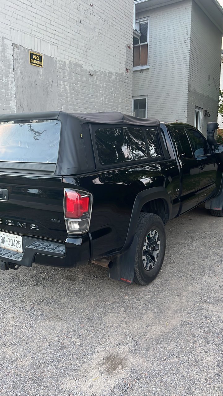

    Softtopper. If I did get another tonneau I’d go for a cheaper hard tonneau. Can’t be worse than the Bakflip. I really like the Softtopper.

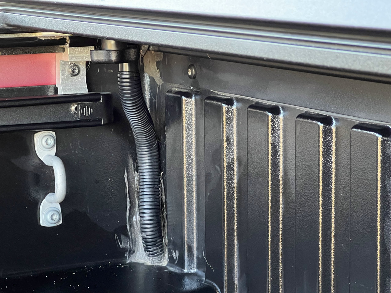

    Drilled mine higher so I could still use the bed, went with the front wall. Used a grommet. Nothing to it.

    Now why didn’t I think of that

    Wow, I’ve never seen it done that way before…super smart!

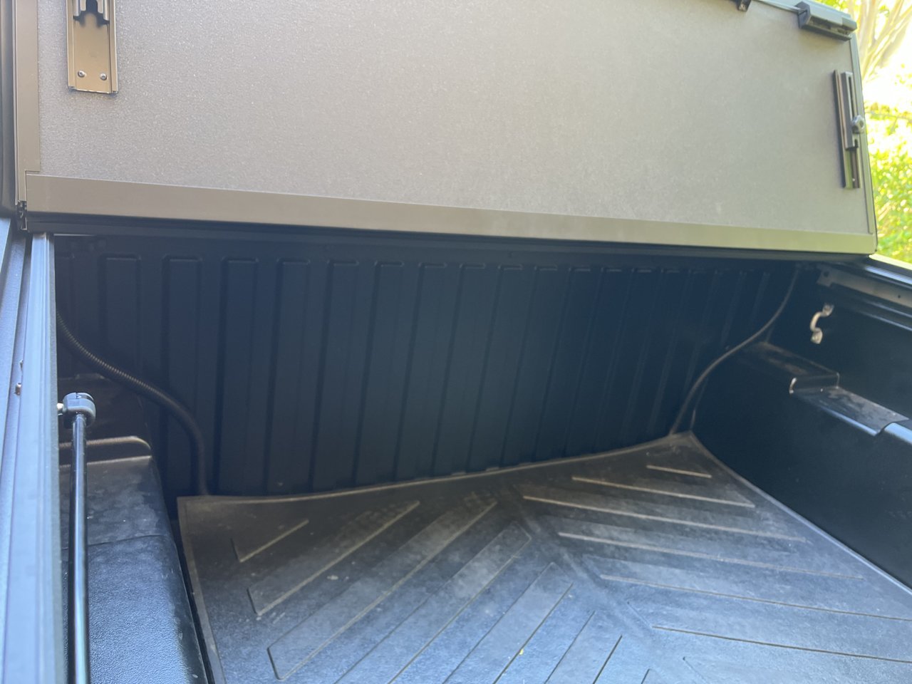

    I drilled on top of the inner fenders and installed the drain tubes where they don't interfere with anything. If anyone has anxiety about drill a couple of holes in the bed, try installing a winch bumper... Cutting away part of the front bumper will cure you quick...

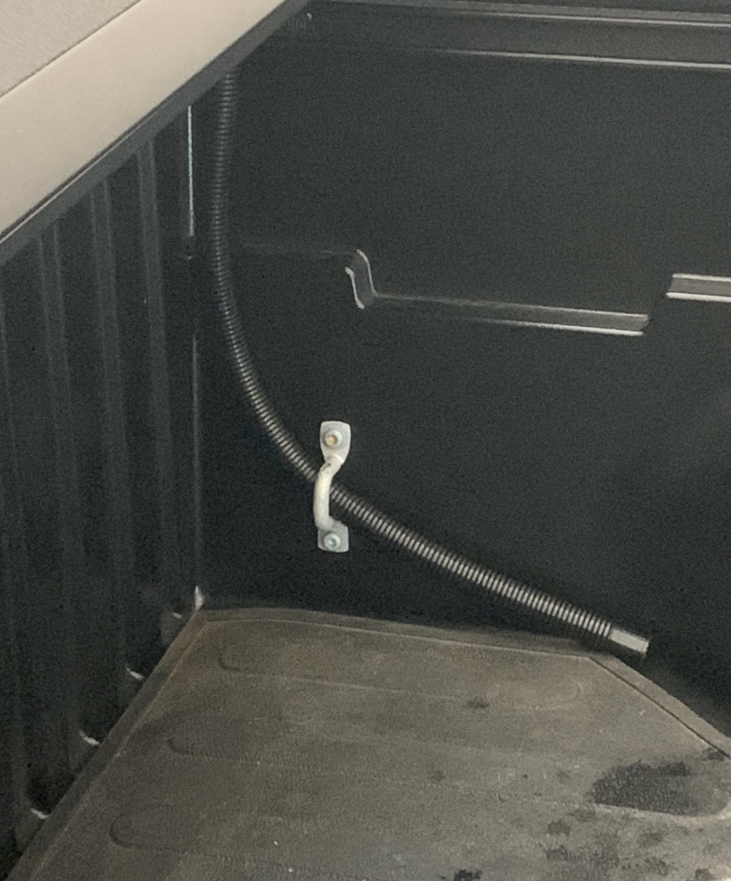

    On my Bakflip I just have the hoses tucked under the rubber bed mat I have. I used some foam blocks to direct water towards the drains in the front of the bed.

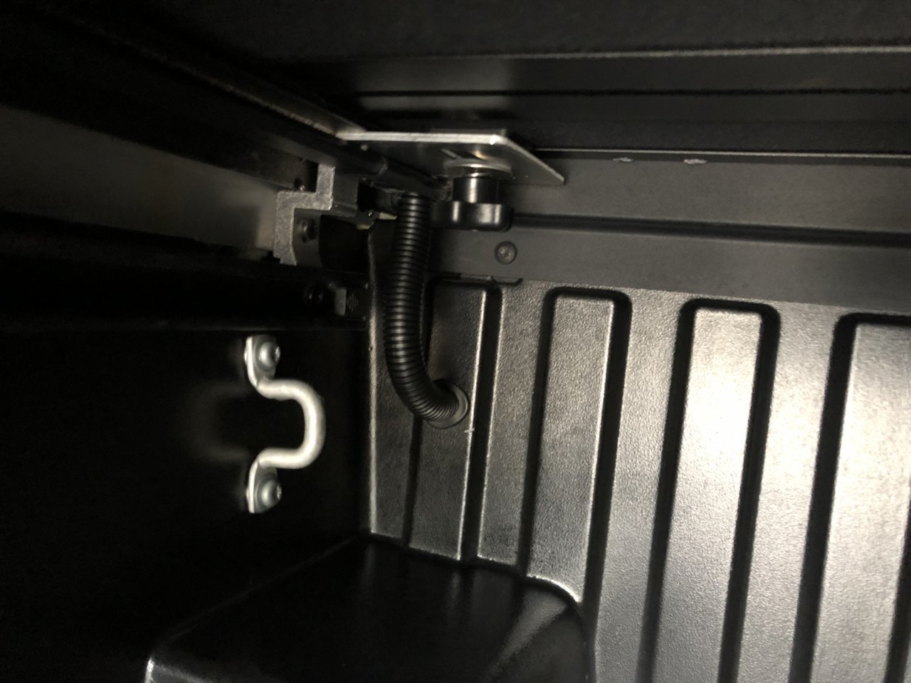

    This is what I did, I drilled a hole in my bed mat and it holds the brass fitting in place in the drain hole
