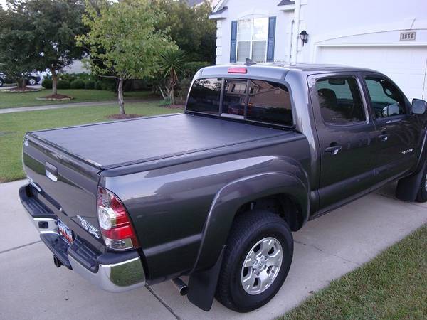

    Here is the Bakflip BP installed.

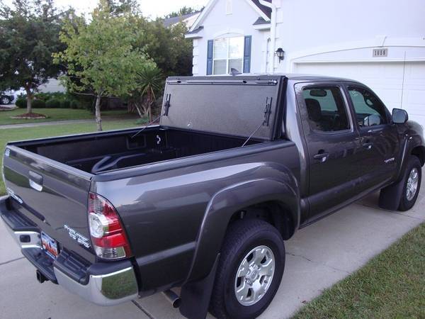

    Fully open
    The mounting bracket I mentioned is at the end of the rail. You can see the screw knob just below it. The bracket has a slot that runs front to rear. The cover/screw is pushed all the way forward in the slot.

    That cover looks really good! How well does it keep water at bay and what is your overall impressions of it now since having installed?

    The reason I want the cover to sit a little more forward is that the seal sticks out over the top of the tailgate amd it could stand to have more overlap at the cab end to better direct water between the cab and bed.
    I didn't install the drain tubes (optional on the VP) initially to see how it worked. I get just a little leakage into the bed, but nothing worth concern. I have a bed mat any any water that comes in goes down the side of the bed and under the mat. Nothing on the mat has gotten wet.

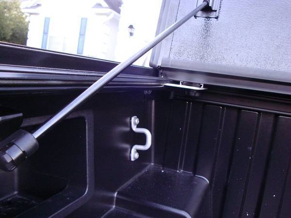

    it has D rings so you can use bungie cords to hold it or if you open all panels it has an adjustable support rod on each side to prop them open and hold them to drive with it open it does block view out rear window when they are all open
