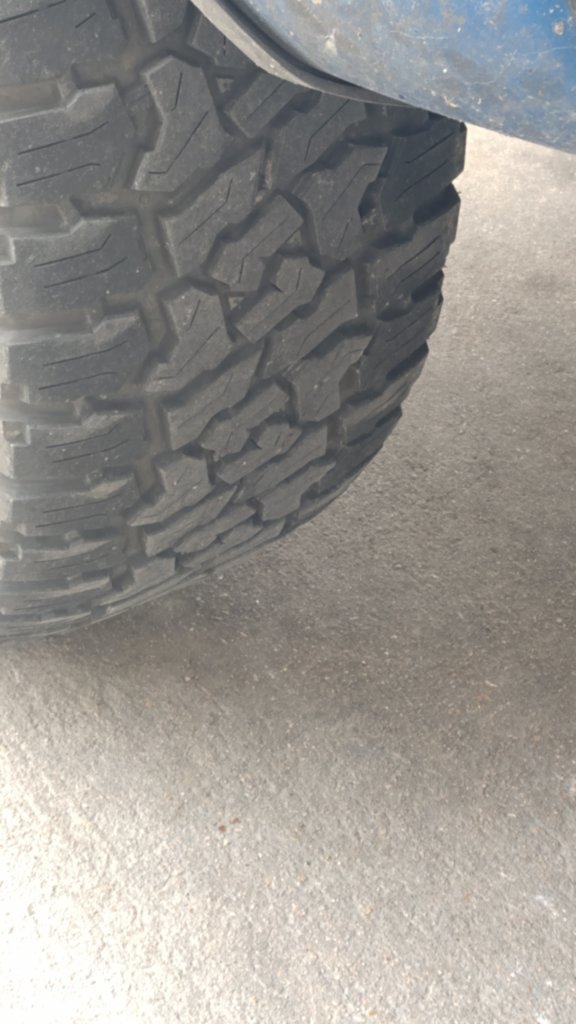

    I got a problem with my tires I balance them ,IMG_20250303_134649832_MP.jpg IMG_20250303_134649832_MP.jpg for some reason can't keep them balance, I replace lower ball joint, upper ball joint ,lower control arm bushing, tie rod and shocks on the front, I don't know what else to do

    On the photo I post you can see how it's wearing out , I don't get it why it's doing this

    I would go back to alignment shop, ask for the numbers, printed out.

    the only reason would be alignment. Something is out of whack and I do not believe its the tires. Have you tried swapping rear tires to front and see if it continues? You could rule out tires that way...

    Let’s see those alignment numbers. Since components have been replaced would like to see the caster #.
