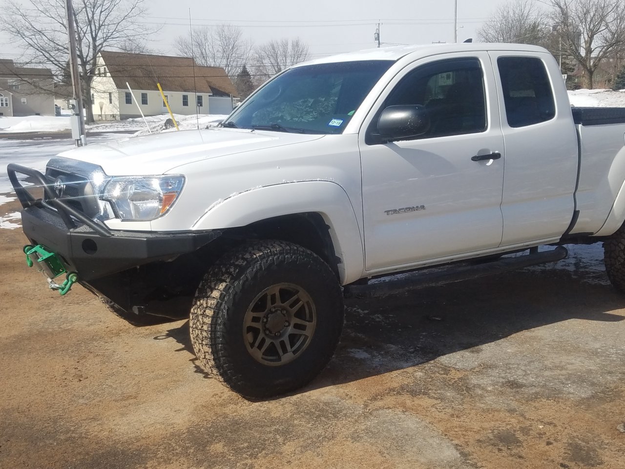

    Got a question, I bought Falken Wildpeak A/T3W All Terrain LT285/75R16 tires. Had balancing issues after they where installed so took it to another shop and still had balancing issues. So I read about balancing beads and decided to give them a try.
    I went to this website: http://www.innovativebalancing.com/mobile/chart_spec.php?4x4=1 To find out how much ozs I needed and bought 0.3g 6mm BBs to put into them. Put 8.8 oz in each tire since some people said go heavy on the weights.
    After completed, most of the steering wheel vibration went away. But some times they come back pretty badly if I turn one direction, but if I turn in the opposite direction the vibrations will go away. I am running 32psi in the tires. The tires are rated to a lot higher but the higher the psi the worse the steering wheel vibrations get.
    Tried doing searches but not much pops up. Was wondering if I added more beads to each tire would that help or has anyone had this issue before with balancing beads. Because since it comes and goes that when turning or speeding up to fast that the beads are not lining up properly in the tire. Anyone else had an issue like this? Or should I just take the beads out and try road force balancing?
    Thanks for the help in advance.
