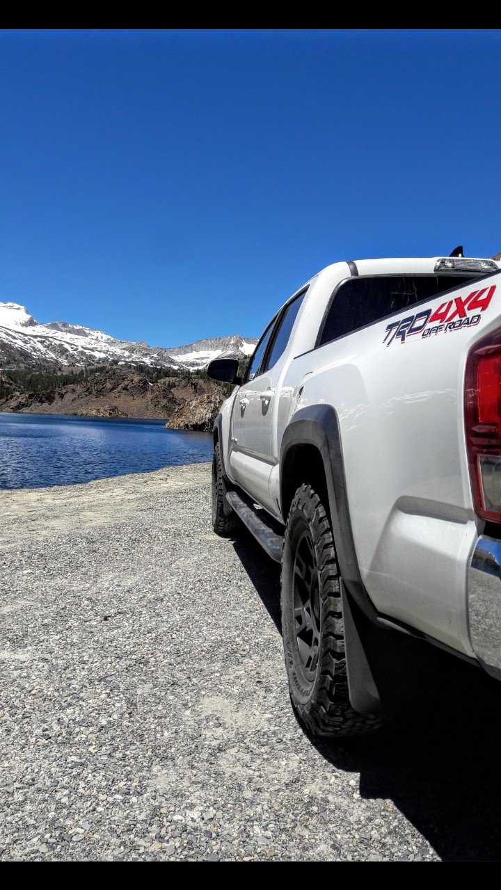

    Screenshot_20180618-180038.jpg I have KO2 c load... same tire size as u. I had issues getting it balanced when new too. Americas tire knew me pretty good. I went in 4 times till they got it buttoned down. Since then, no more vibrations/steering wheel shakes. I'm at 24k miles with them now. No noise and rides smooth as silk from 0-95 (as high as i've driven). Just put 1500 miles last week driving up to the eastern sierras, and over to the tioga pass through yosemite, and back home to socal. I'll most likely buy another set when the time comes.
