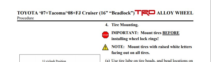

    I assume it is because they are taking off the ring to mount the tires. This is how the instruction say to do it. Then the ring should be reinstalled before balancing.

    Page number in manual please?

    Top of page 5

    It doesn’t say balance before installing the rings, it says mount the tires before installing them.

    Ah ok, can't see the rest of the instructions.

    They’re not my instructions, they’re Toyota’s! I also wasn’t the one that posted them....:thumbsup:
