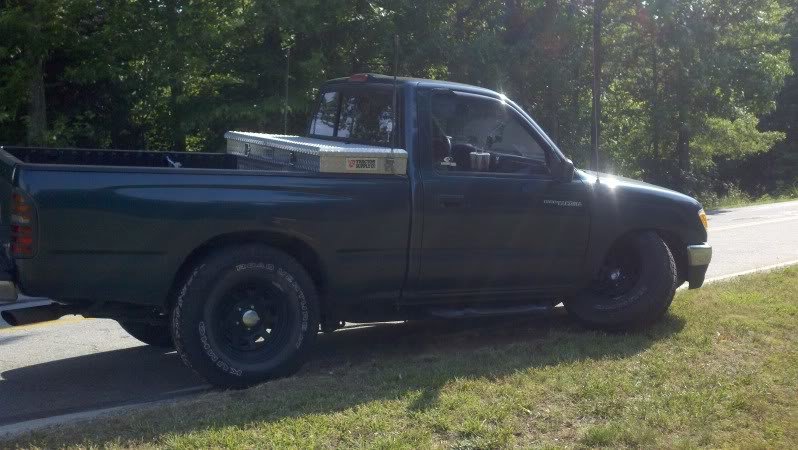

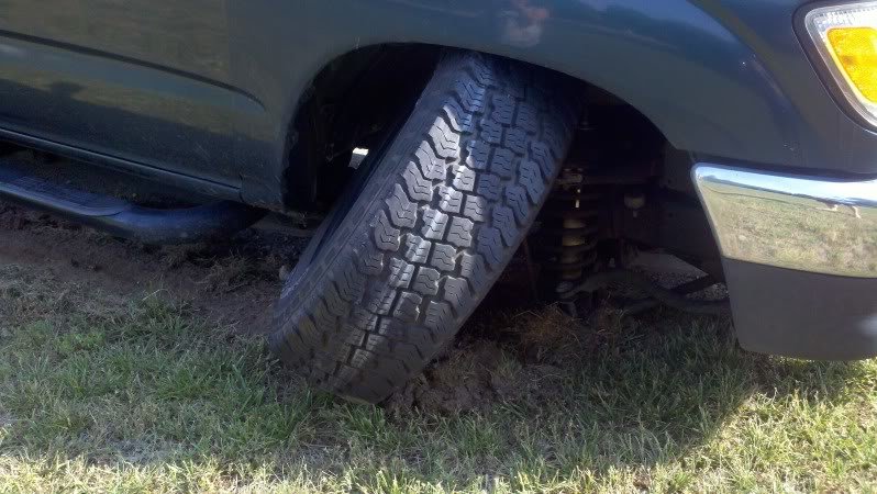

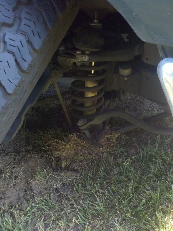

    First post here, but I've read other posts for a few weeks...
    Today while driving I had the front right ball joints blow out....resulting in this:
    2011-05-23_17-30-55_346_ec64749274d20dfc4378119efd19df229b1d5c80.jpg2011-05-23_17-31-04_152_1d0ea026f5bf2bb3ed9a8cfd7a743366f5d79709.jpg1306186419291_aa8e83cc766c2d8314533c60dc5375b3f4b1f304.jpg2011-05-23_17-31-12_830_9c3f38e33794abb218f66addb74d65562ae1b392.jpg
    It was towed to a mechanic...won't find out the details until tomorrow morning. :-\

    Just heard from the mechanic, they're quoting me $360 for the ball joints and apparently my brakes are almost gone and they're quoting $570 for brake replacement?

    Steve o, I would think jacking it up and just testing them for looseness should do it before throwing money at it. Also, what year/month was your truck actually built?
    The recall (not TSB) was only for certain batche(s) that got scratched during manufacturing, and this leads to wear and failure.
    So far, I have seen mostly 2001 and 2002 affected.
    My 2001 was built in August 2001, putting it at late in the model year production.
    My guess is the bad batch affected trucks built in late 2001 and early 2002.
    Anyone else have any evidence to support (or contradict) this?
