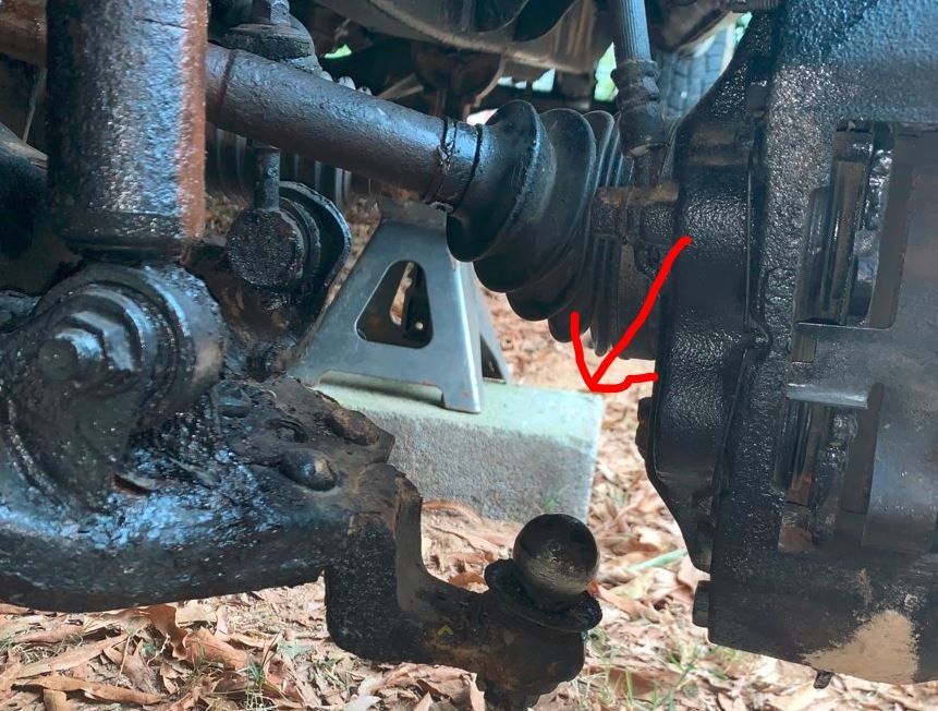

    Any advice on the CV axel? It appears that it’s “popped out” or something. Somehow the boot has slid up and it appears twisted?? When I try to line up the assembly with the LCA, the cv is preventing this from happening. I could post more pics to give you a better understanding if needed. Somehow I actually got the LBJs off!!!!! . Now I just gotta figure out what I’m gonna do about this cv. I really don’t wanna replace it
    I have really no knowledge or understanding on how these work so pardon me if I sound like I don’t know what I’m talking about haha

    Ball joints aren't too tough to replace, but having access to pneumatic tools can make the job go much faster and easier. How fast were you going when it separated?
    Not trying to nitpick here, but if you're going to do any work under/around that truck, please use a more secure method of supporting it than the landscaping block you have under the jack stand. These things will crack and crumble if you look at them wrong. Just making sure you're working safe!

    Azusa, CA
    yeah that's a disaster waiting to happen lol. My old driveway has cracked under the weight of my floor jack a couple times, scares the hell out of me. Early 20th century homes are cool in a lot of ways, and not so in others.

    Beats putting it in the mud. The area I had it towed to is sorta muddy and I really can’t move it. You can’t see it in the photo but I have a jack on the front of the frame as well for extra support.

    I’ll figure something else out then. Like I said I’m not the best at stuff like this. I do have a jack supporting the front as well but the area they towed it to is extremely muddy and I figured it was better to throw a block under it then just put the stand directly in the mud. Anyway to move this thing? I should of had them tow it to a better spot but I wasn’t planning on doing this job myself till I got a quote for $1800... without an alignment.

    Your best bet for blocks is always wood
    In the soft dirt I use a 12"x12" piece of plywood .
    I had a truck fall when the ground thawed and the jack stand sunk on one side

    Hmmm, it appears that the 3 bearings have popped out. But just the top one? I felt the boot and it feels like a circle coming out of the housing that’s right behind the boot. I’m gonna try to pop it back in tomorrow

    I think I got it under control for now. I was having trouble at first but I rented one of those pullers that you were talking about and boy that thing works wonders! I was able to get the driver side lower balljoint off completely and the tie rod end as well.
    I’ll get a good picture of the CV tomorrow, I’m thinking that one of the three balls has popped out of the housing they were in. At least that’s what it looks and feels like. Illnpost a pic tmmrw
    I ordered the uppers as well and a kit to press the old ones out and in, wish me luck with that I think this will give me a real challenge. I’m gonna have trouble keeping the knuckle from moving but my plan is to bolt in the new LBJ and use that to help hold it still a bit. Will this damage the lower bj?
