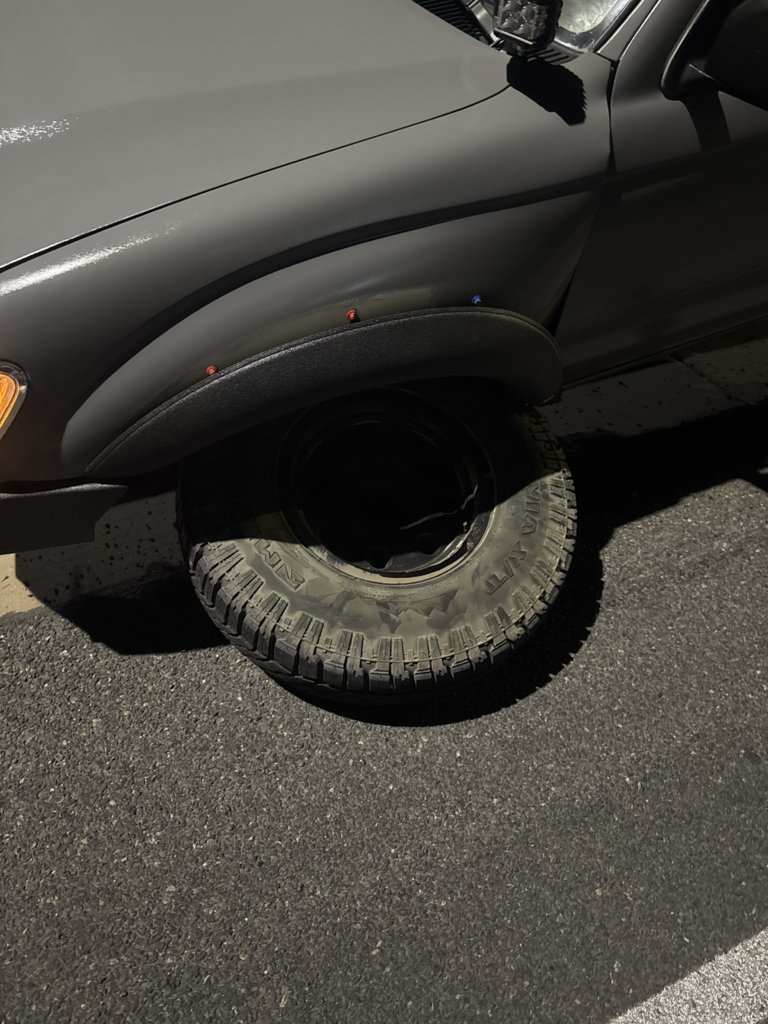

    Recently bought a 2003 crew cab 4wd and had the ball joints and front end aligned after doing a steering rack as well as some bilstein 5100s. I’m running 285/75r/16 with a 2inch spacer. Had the ball joints replaced end of October and had the driver side fail going about 35mph and completely caved in my fender. I read that this is a common failure on these trucks but should they last longer than 2 months?

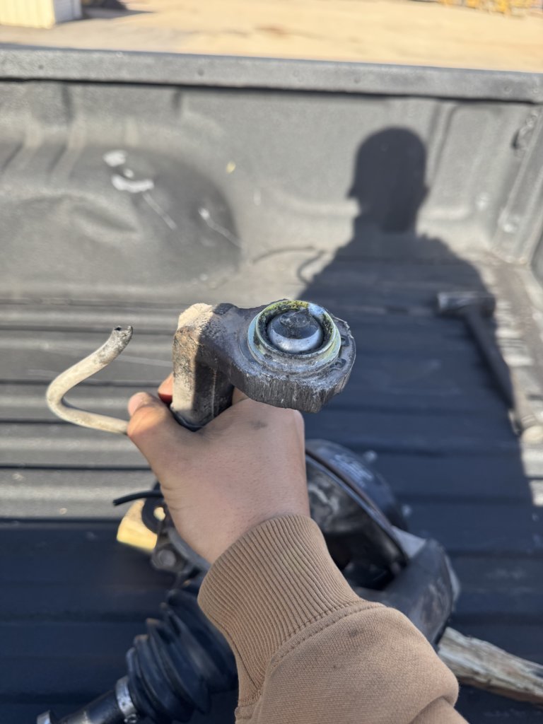

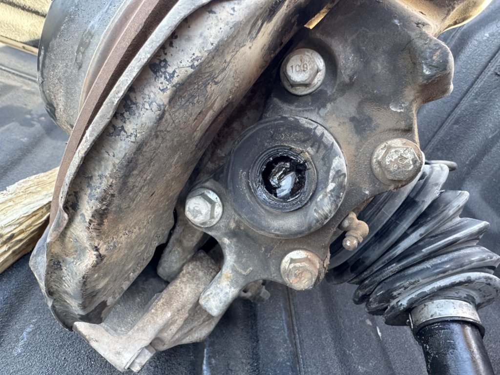

    Damn! Glad you didn't total your Taco and yourself. Unless I am mistaken, the actual ball-stud did not just pull out but broke on both the LBJ and UBJ. The Zerk grease fitting on the LBJ tells us that it is not OEM and the 10.9 marked LBJ bolts don't match the LBJ bolts I have seen used with 555 JAPAN LBJs. Do you have any idea what brand LBJ was used or where it was purchased?

    +2" is not "level", it's +2".
    I see a zerk fitting- so not OEM. Also.. only 2 moths? they look way older than that.
    Either way- @ 2 months for any new part (OEM or otherwise) is likely an installation error.

    I have no idea where they are from. Both lbj and ubj on both sides were replaced two months ago.
