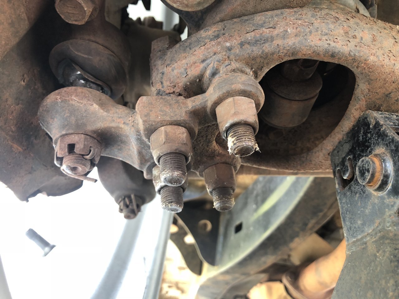

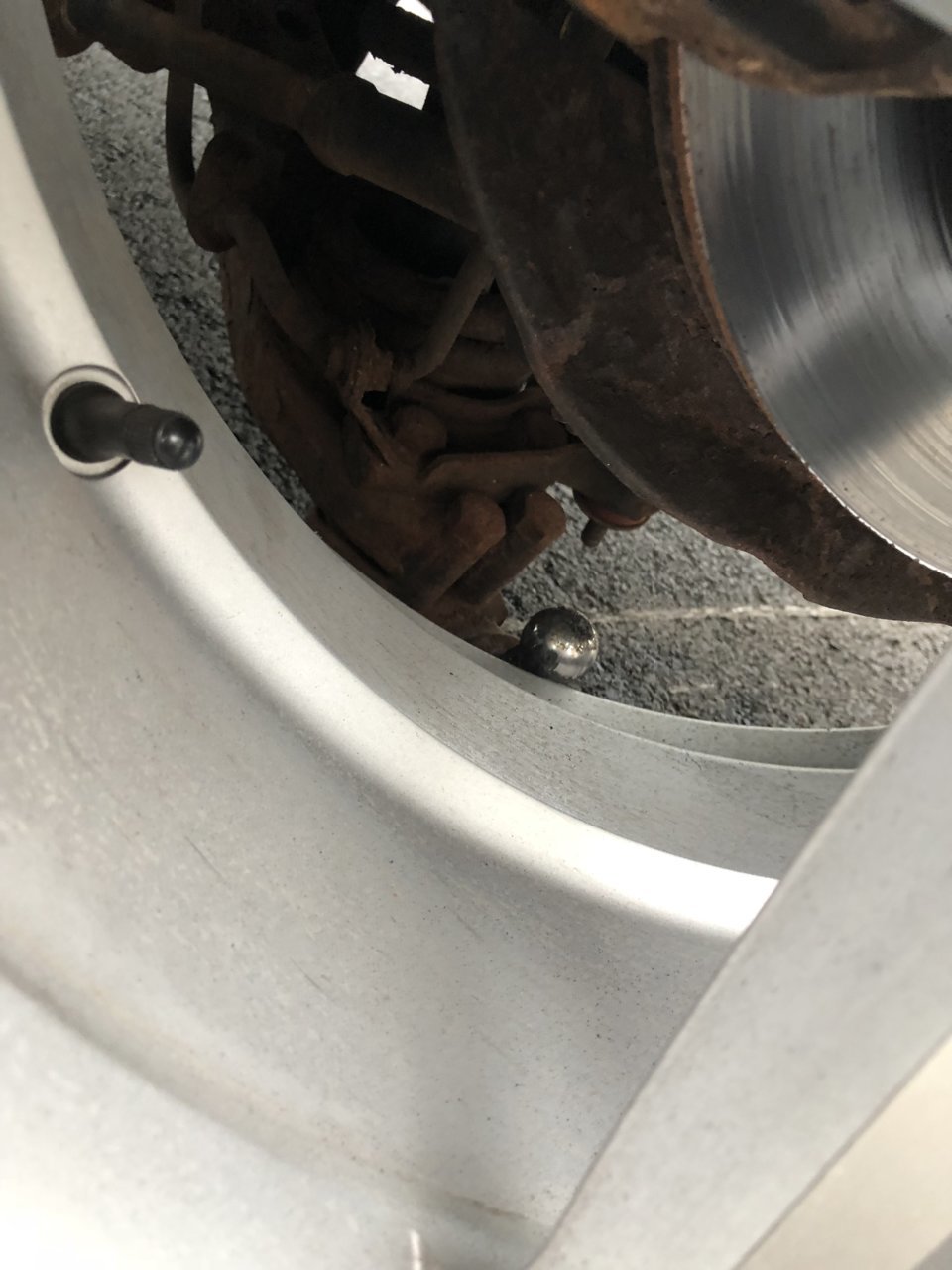

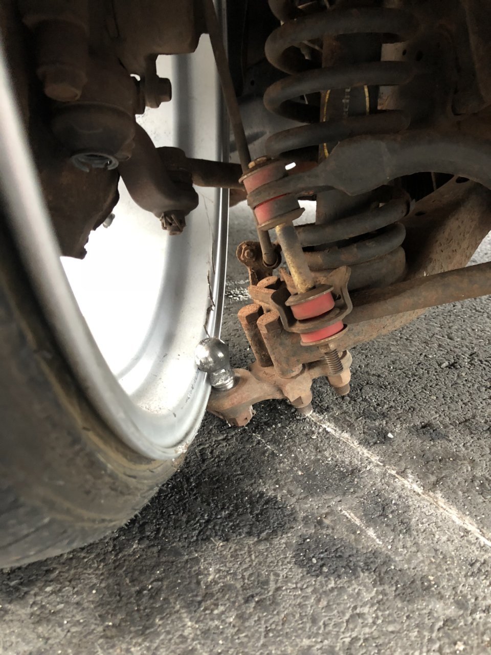

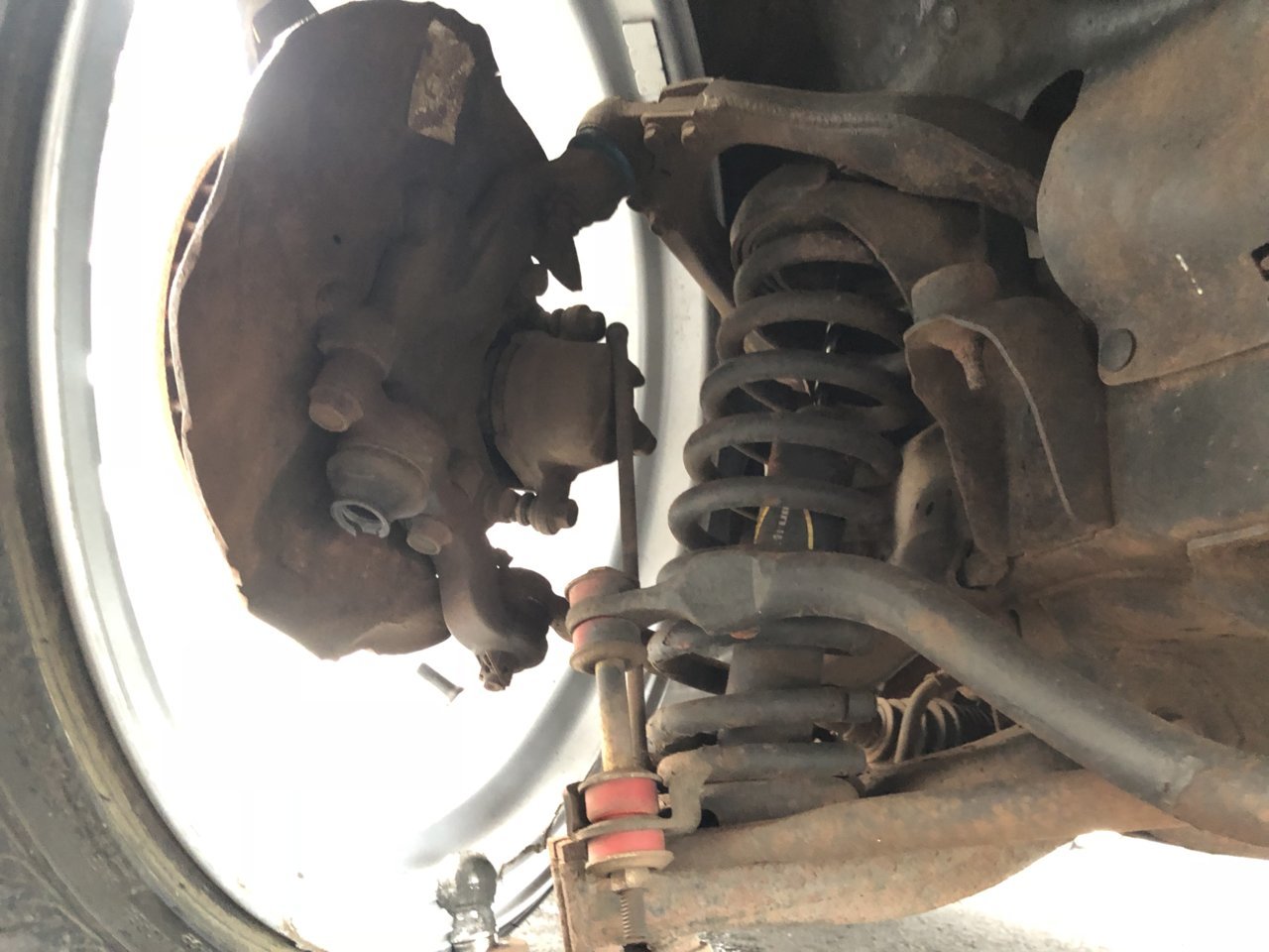

    So my ballpoint gave out while making a u turn, after setting up an appointment for the repair at my buddy’s shop he told me to go to the local Napa auto parts and get the replacement part. After buying the lower ball joint which I thought I needed I came to find out that it’s not the same one that’s on the truck! I also thought maybe they flipped the ball joints so the lower would be the upper and vice versa, but that’s not the case. I figured the truck has a drop so it could be an after market ball joint? So I’m not sure what to do? Any help would be appreciated!

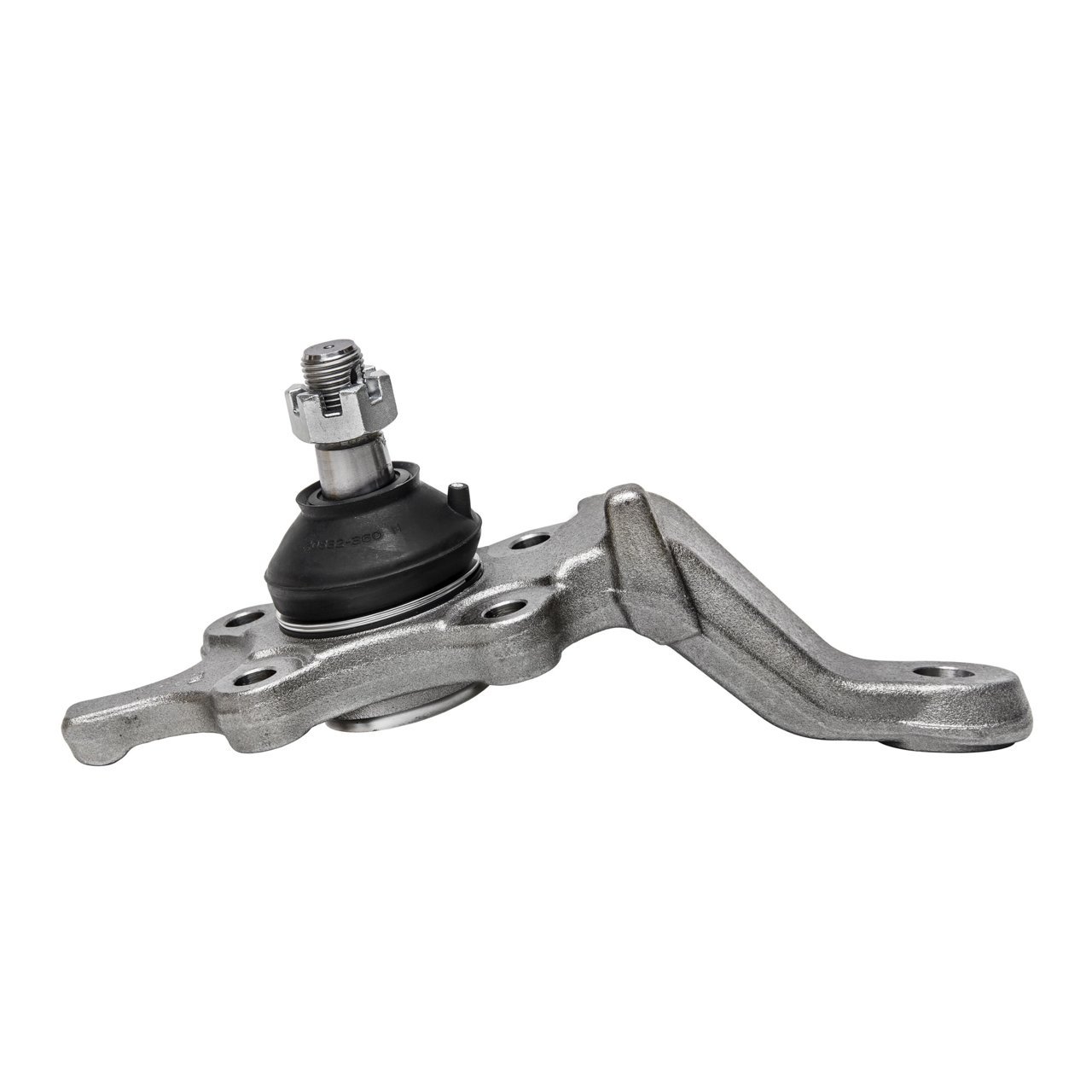

    Here’s some pics of the part I need if anyone can help thanks!

    The 2wd ball joint is differant then the 4wd or prerunner ball joints.

    Yes I told them mine was a 2wd still did not match they told me maybe it’s an aftermarket control arm but can’t find any replacements online that match
    They sale you this? prerunner joint

    No but that looks like the one I need if I’m not mistaken that one is for lower or upper?

    I've heard that there are aftermarket ball joints for lowered trucks (a flipped LBJ or something)....maybe you have one of those kits

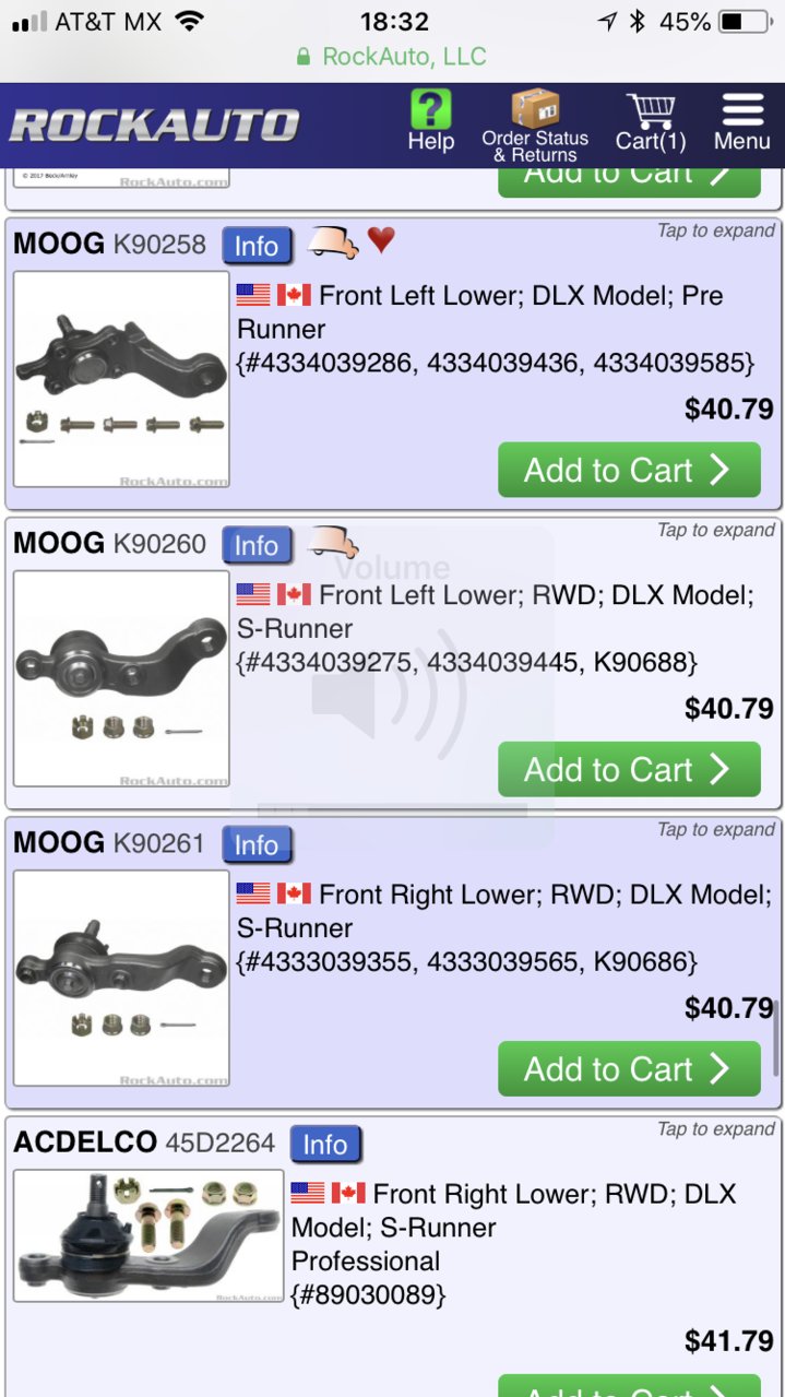

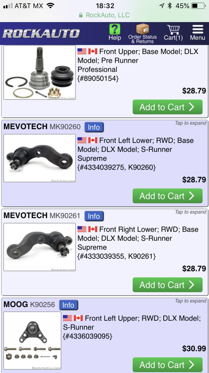

    Go on rock auto, let me see if i can find you part numbers

    Here, the parts that say s runner is what you need

    5 lug suspension parts are completely different then 6lug. Go over to the street truck or 5 lug section if you ever need suspension help. Most guys here are 6 lug guys
