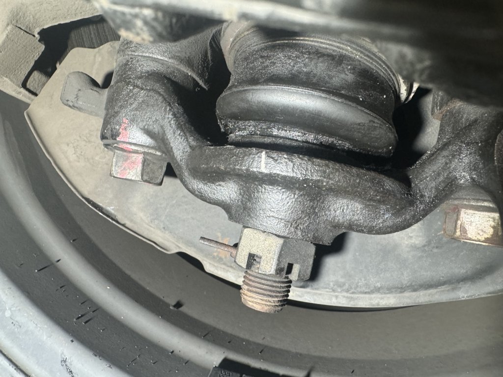

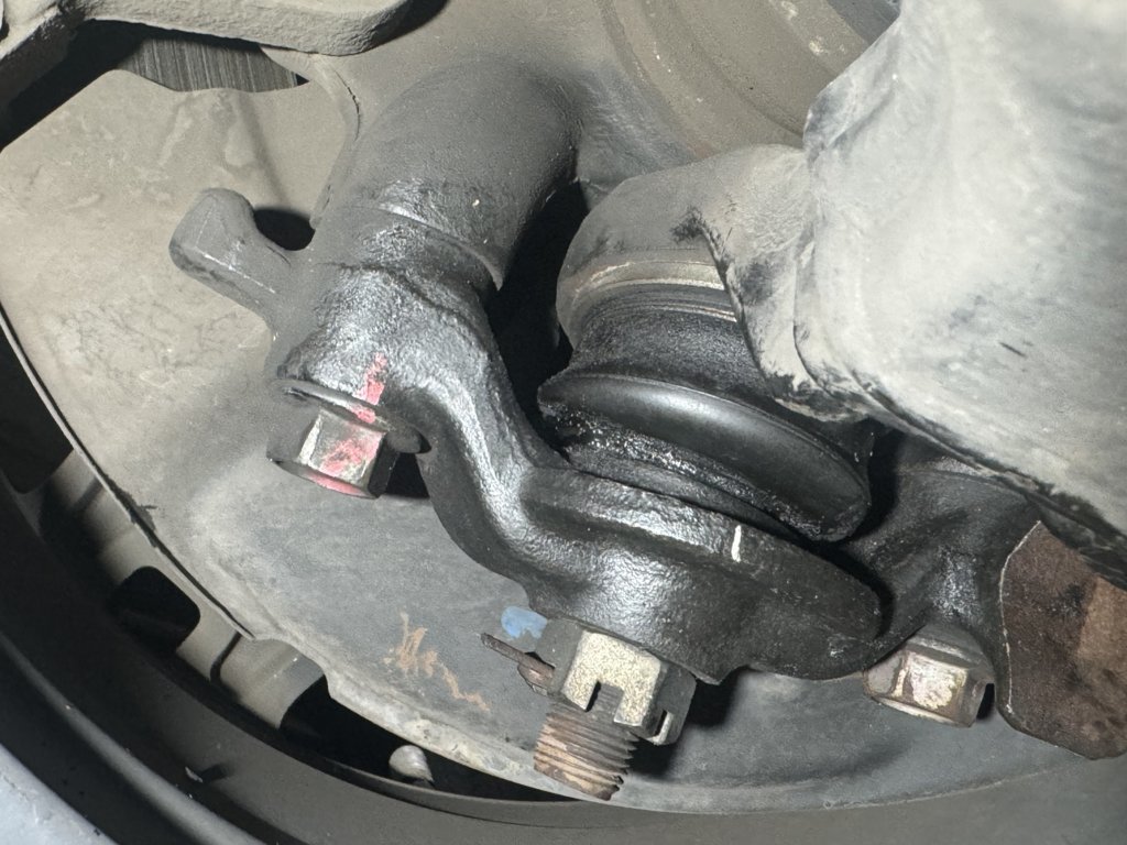

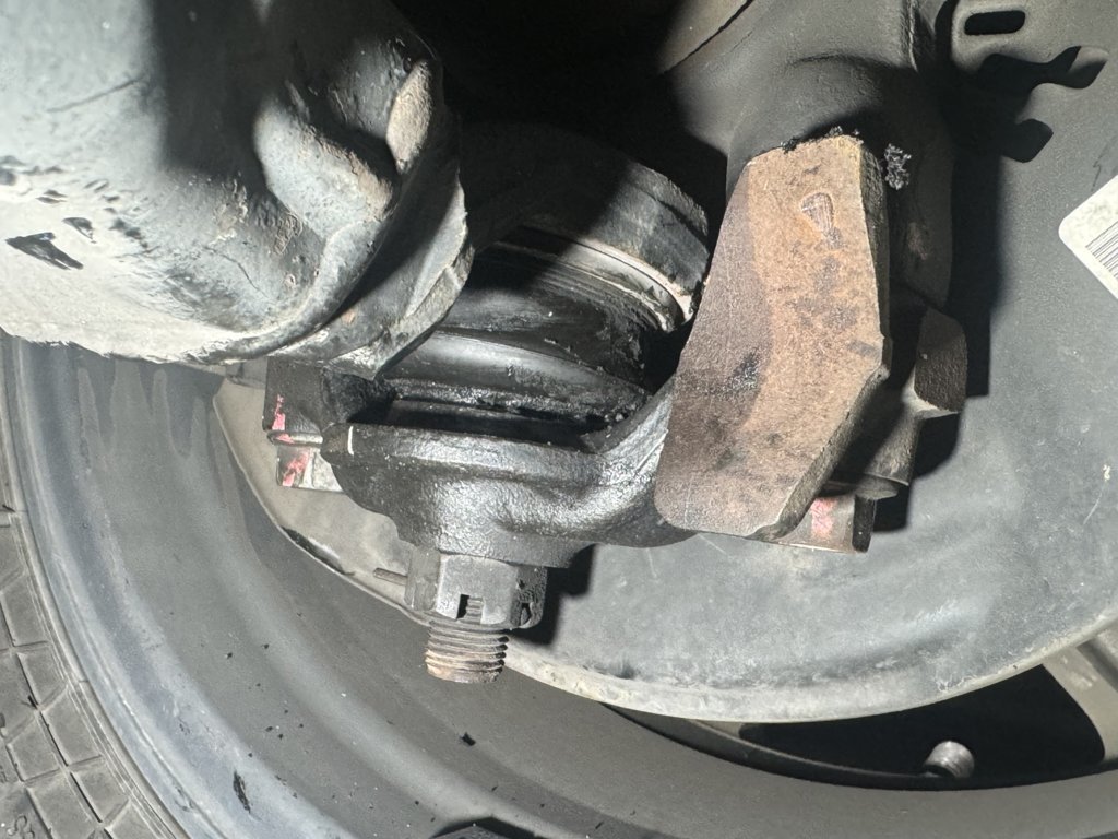

    It is time to replace? Under 40k miles

    that one looks perfect……
    of grease is leaking from a split in the boot, then that’s an issue

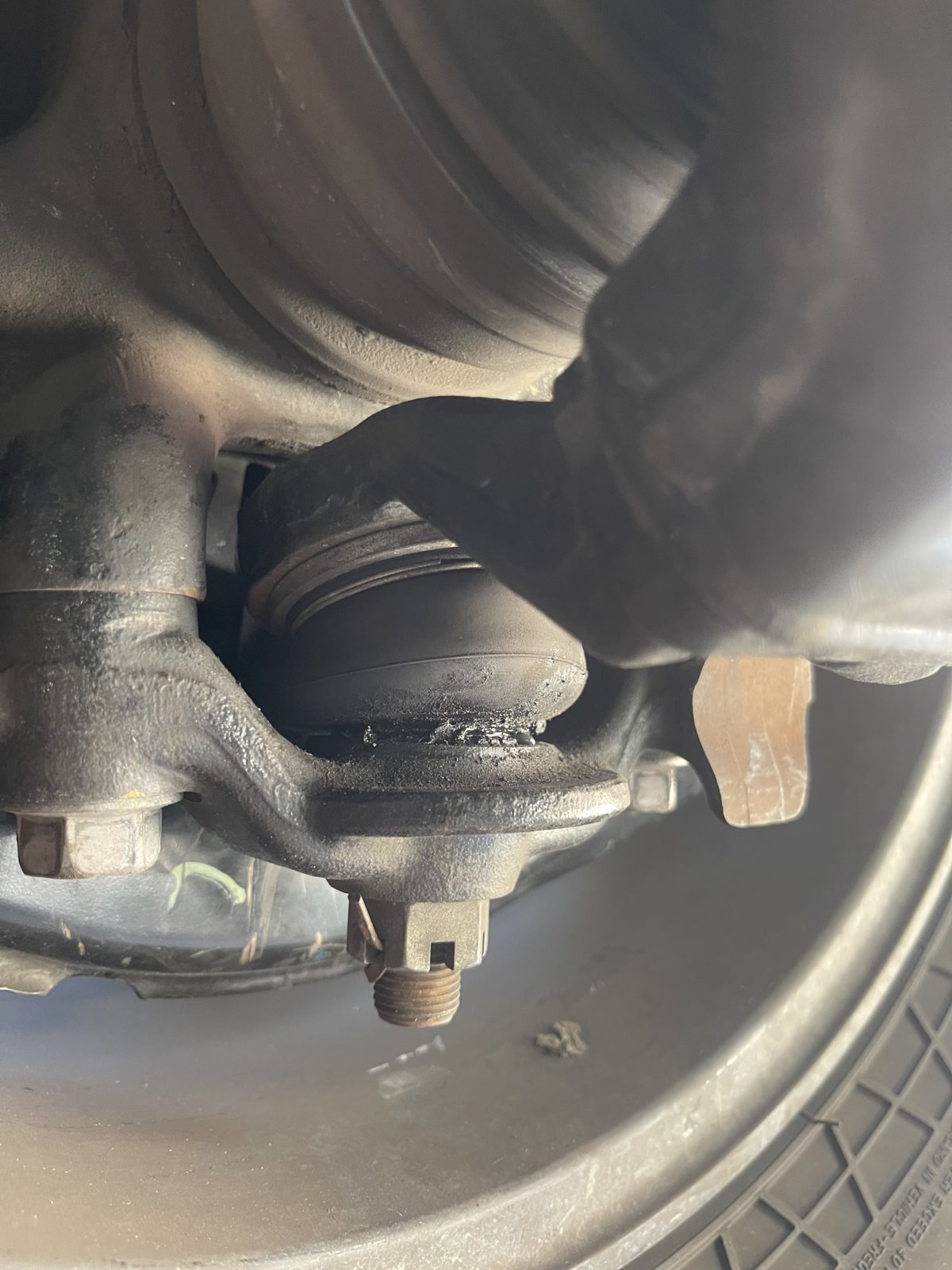

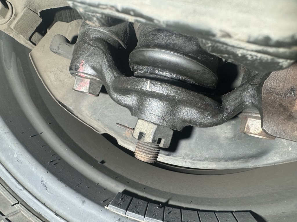

    Could you guys help me if this need replacement? This pics was taken after cleaning some old grease. It seems like it seep out from the bottom of the boot. I couldn’t see any puncture or tear. There is no play and it was solid when I check for any play. These pic were taken when the truck was on the ground. TIA

    Looks ok to me visually and per your comments

    Sounds good thank you! I have 2018 80k mi on it.

    2-5 years left in all the ball joints I have seen in this thread. If they dont have any play then they are fine.
    A little leak is not a concern. If you replace parts like that you will put your mechanics son through college.
