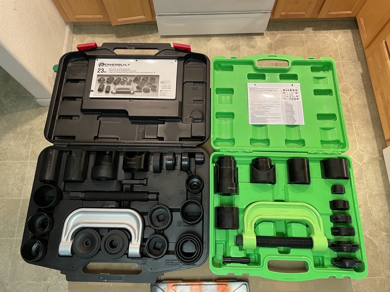

    Update -- I ordered both of these sets from Amazon in order to do a direct, hands-on comparison, because the price difference was so large:
    OEMTools™ #25104 21-piece Master Ball Joint Press Kit, ~$85
    Powerbuilt™#648617 Ball and U Joint Service Set, 23 Piece Tool Kit, ~$215
    TL;DR: If you're a DIY-guy doing ball/U-joints maybe once or twice a year, the OEMTools version is fine. If you're a mechanic doing 10s to 100s of ball/U-joints a year, the Powerbuilt version looks like it will hold up better due to higher surface hardness & slightly denser metals of the parts.
    These two kits appear to be functionally identical in the type, number, and sizes of various install/remove adapter tubes, and therefore they should allow you to do all the same operations on the same variety of makes/models of vehicle. The only difference is that the Powerbuilt™ version includes 2 large impact sockets. Adjusting for the $45 cost (for both) of the impact sockets, the Powerbuilt set is still $170 vs. the $85 OEMtools version.

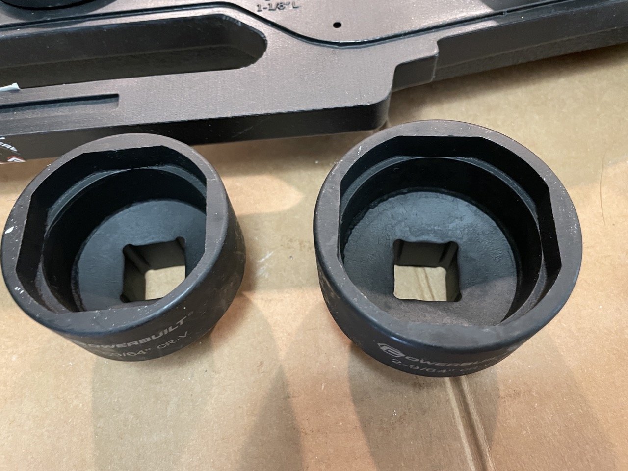

    There were occasional 1/16" nominal diameter differences on some of the parts but I would think that these are "within the range of acceptable tolerances" in order to get the equivalent functionality.

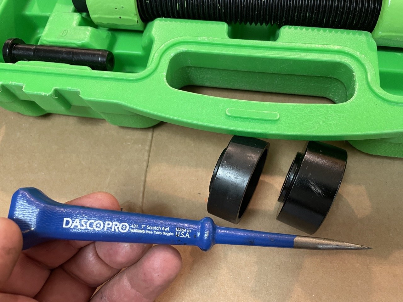

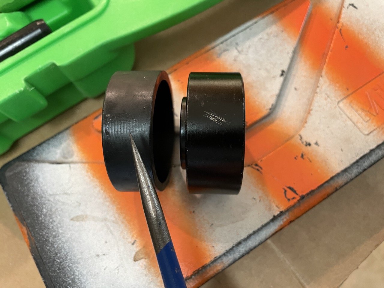

    Overall, the Powerbuilt parts averaged about 4% to as much as 15% heavier for identical-sized parts. Also, the Powerbuilt parts had a notably higher surface hardness. (In the photo below w/ the scratch awl, Powerbuilt is on the left, OEMtools on the right. I used maximum possible hand/arm strength to scrape with the awl point.) Whether this is due to heat treatment or harder base metal or both I can't guess. The threads on C-clamp press shaft looked identical & calipered out at "same size" to within reasonable tolerance. (Powerbuilt thread OD measured 1.10", OEMTools thread OD measured 1.08".)
    I did not weigh the 2 C-clamps as they exceed the range of my digital kitchen scale. Interestingly, to the eye the OEMtools version looked marginally "beefier." Both rang with exactly the same tone when struck. Scratch-awl to the inside of the smooth-ground (non-threaded) showed about the same subjective level of surface hardness.

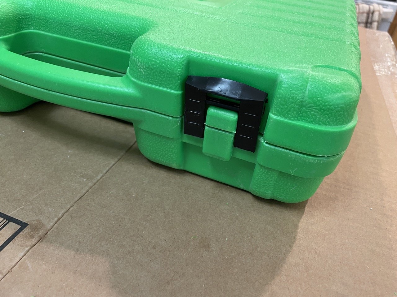

    Powerbuilt storage case is larger with higher-quality latches and includes a multi-page laminated instruction card with photo illustrations. Interestingly the Powerbuilt case does not use as much nesting of the parts, making it somewhat bigger than the OEMtools case. Maybe that helps the pro mechanic by making it quicker & simpler to find & use a specific part without pulling out & possibly losing other parts, but it also takes up quite a bit more shelf storage space. OEMtools case latches arrived broken due to shipping damage. If they hadn't been broken they would probably be just adequate to their task.
    Amazon reviews on both sets are uniformly high, in the 4.5-stars range, with thousands of reviews for each product. Since I am a DIY guy who will use the set maybe once a year, I'm satisfied if it has the number, type, and size of parts needed to get the job done, not whether it's going to last 500 or 1000 uses. So I returned the Powerbuilt™ set to Amazon for a refund.
