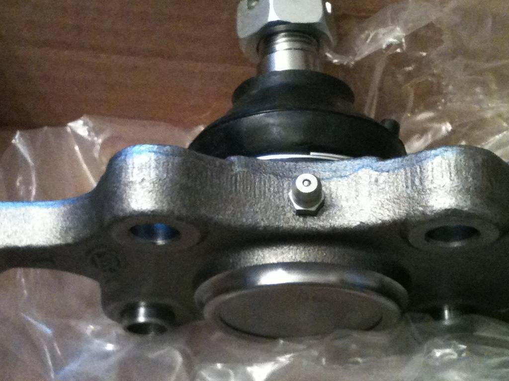

    I'm having issues with my lower ball joints. I have replaced the driver side once and now its about 3 or 4 months later and its about to pop again. Is there any suggestions to permanently fix ball joint problems. I actually looked at greasable Moog ball joints. I would appreciate some help i don't want it to come apart while goin 70 and surely die on my way to work. :bananadead:

    Actually with mine it sounded dry and no matter which way you turn or bumped it you could hear it squeaking like a ford explorer! :rolleyes:

    Its a lot easier if you jack up the truck by the arm, then put the crow bar under the tire and pry up. The ball joint will lift up and down in the arm if its loose. No need to wedge anything in your $2400 LCA's

    1/4", 1/8", or metric zerk?

    8mm zerks for the Moogs

    yea they are nice and come with the zerks

    Anyone every used Sankei ball joints? After all my reading I am most likely going to buy Moog upper and lower ball joints, order tonight so I can have then by this weekend to install.
    With the Moog's do you have to grease them before install? When you fill from the zerk do you have to worry about over filling, or does the excess flow out somewhere?
    I'm also going with Energy Suspension Poly control arm bushings for my stock LCA/UCA's. Thinking about drilling/tapping the LCA/UCA's while I'm at it and installing zerks for easy greasing later. Any opinions on this or seen anyone do it before? This is on a 1995.5 Tacoma w/225K miles.

    I have them. Put them on when I changed out my lowers for moogs.
