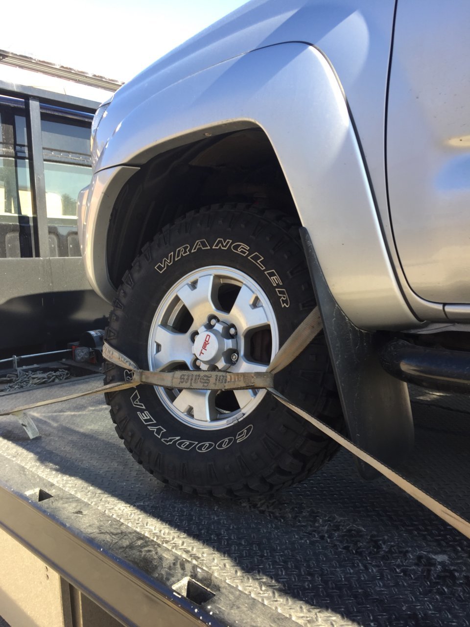

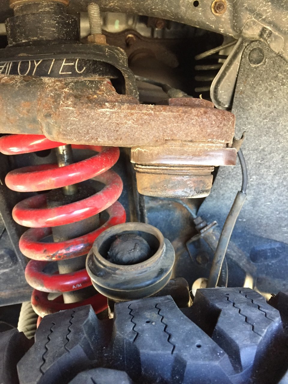

    L/R uca. Broke backing out of a parking lot.

    35k. Have to have it towed to the house. See if I can’t fix it. Not really a mechanic had someone else install them for me.

    Hope I can find a replacement today. In the tow truck now. Call around when I get home. Stores might be closed tomorrow for the holiday.

    how old are the upper control arms? Did you break the ball joint or the upper control arm? The first gen Light Racing uca's had a washer on each side of the bushing and were known to bind and break at the weld. I broke one 6 hours into the Golden spike trail in Moab and had to make it 6 more hours to get off the trail

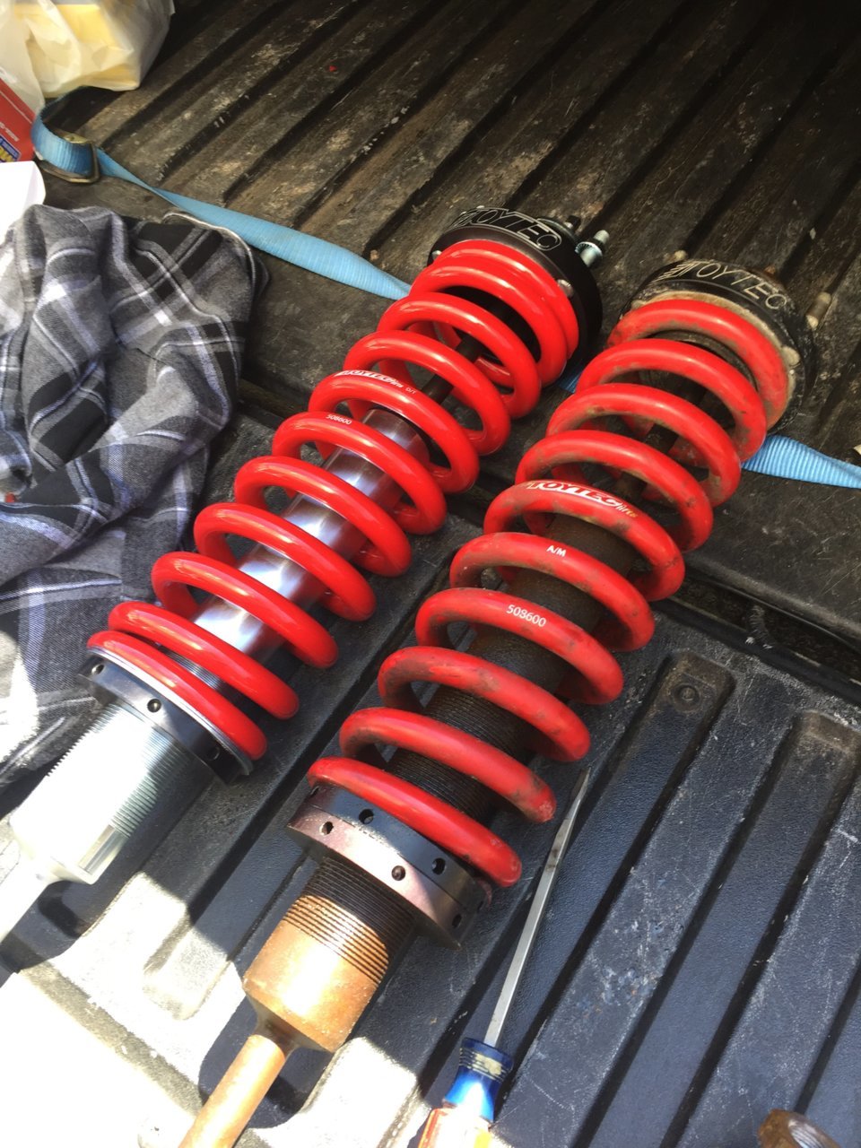

    Those are Boss Coilovers not a spacer lift

    That is one extremely unlubricated ball joint. New ones come with grease fittings. I would suggest replacing both and buying yourself a grease gun. Send that pic to SPC as well.

    Like others said those are the old style LR balljoints, the only way to grease those was to pull fown the rubber boot or replave it outright. 35k miles is quite a bit for those without maintenance. There should have been warning signs before they totally failed... vibrations, uneven tire wear, roadnoise, excessive wheelplay etc. Lucky it happend in a parking lot.

    Trying to put it back together today. Thought while I’m in there with the ball joints out might as well put in new coils. These ones have about 50k on them.
