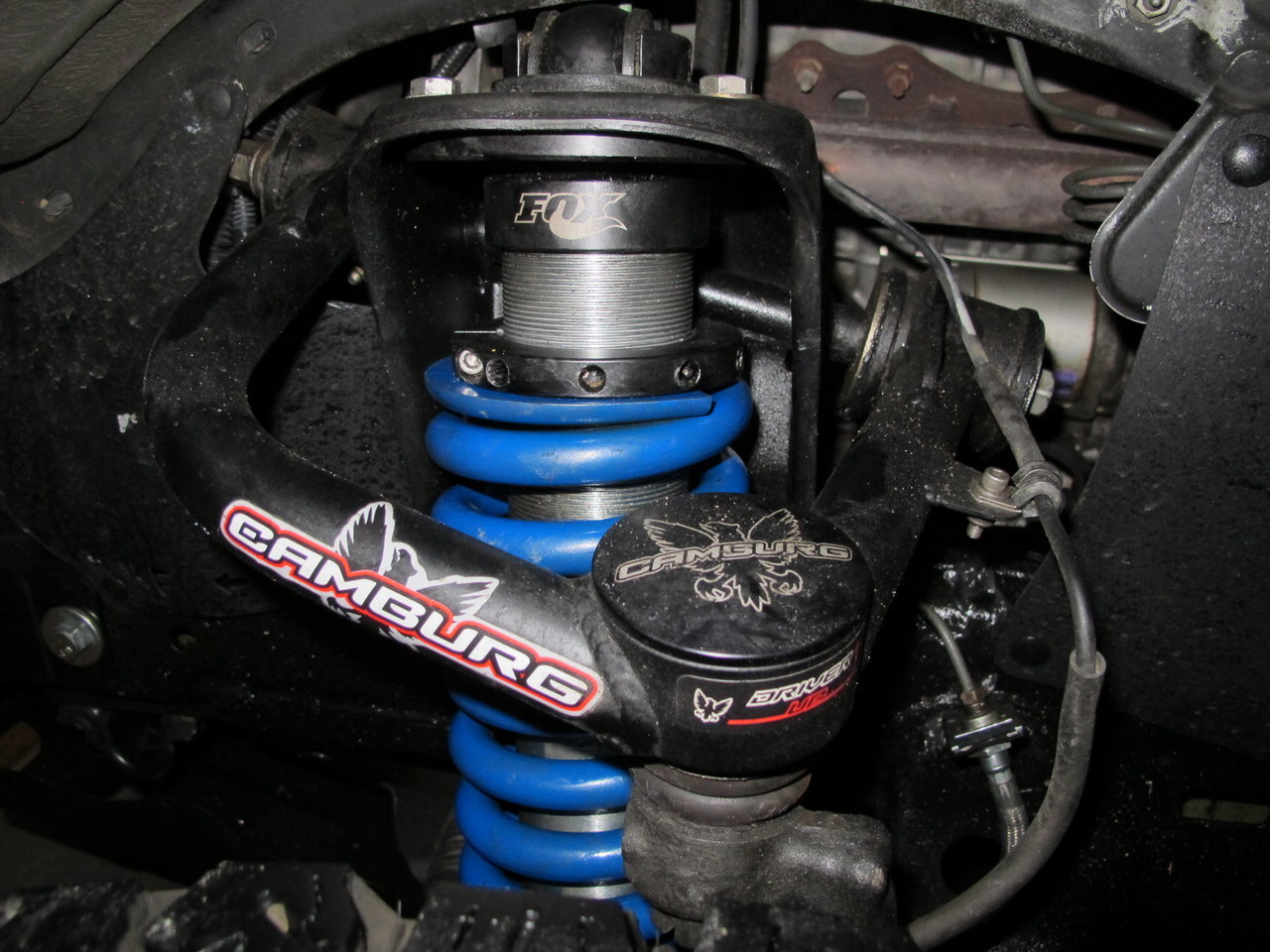

    The guy I think to ask is @motoxscott. I have BJ Camburgs paired with extended travel FOX coil overs but that's not because I know one way or the other.

    All our arms regardless if they are uniball or ball-joint are designed for extended travel FOX, King, and Icon coilovers. If you're going to spend the $$$ on coilovers, always get extended travel versions and make sure the upper arms you're using were designed for them.

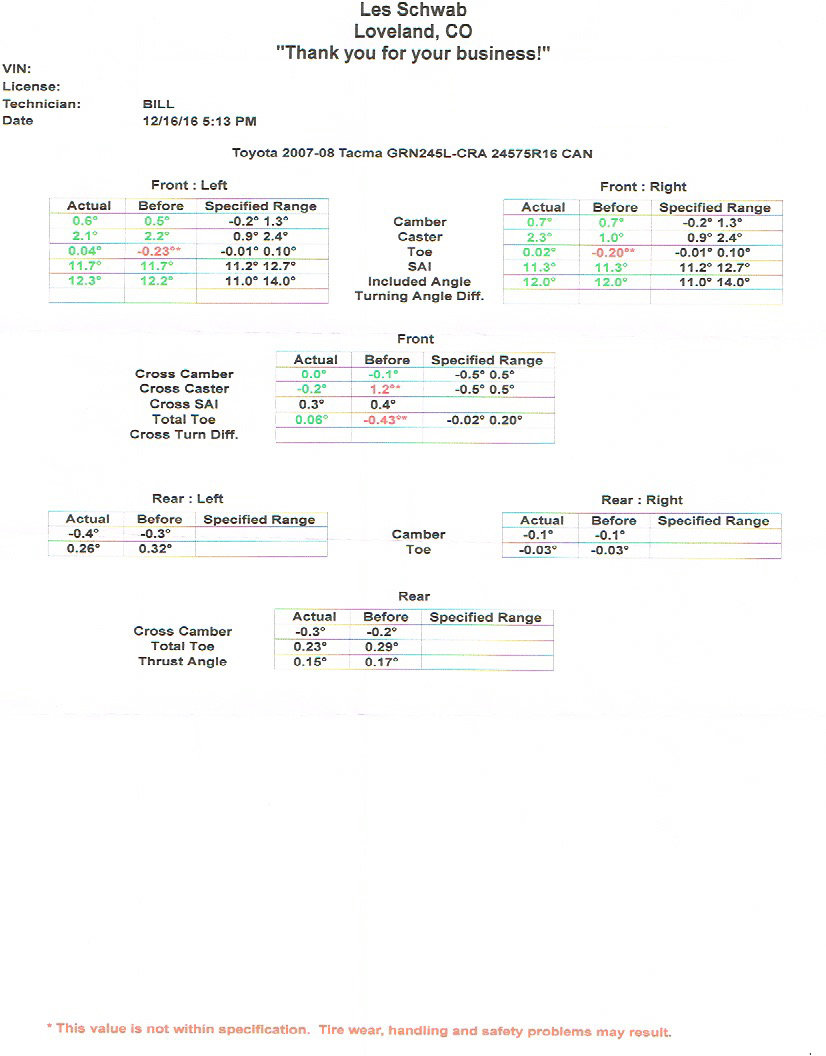

    UCAs can add caster. A camber measurement of 3.3 degree sounds like a lot. Is that positive or negative camber? Camber and toe have the most impact on tire wear, caster has effect in how twitchy the steering is, how well it re-centers, etc. It doesn't really have much impact in a straight line on wear.
    Here were my measurements after lifting about 2" with those Camburgs, which I believe have +2 degrees of caster built in over stock. IOW, I would have zero caster without them presumably.

    That's exactly what we did, zero toe, zero camber and put in as much caster as could be adjusted in. I never had an alignment done stock so I don't know for sure how much could be put in. I had a touch over 2 degrees with the Camburg arms at my lift height, which I thought built in additional compared to stock UCAs. Maybe more could be dialed in but I just wanted at least 2 degrees so we stopped futzing with it when we got roughly 0/0/2.
