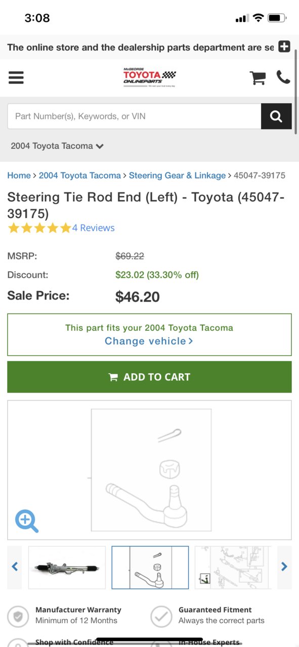

    Yes. McGeorge’s are cheaper at $46.20 a piece

    Yup that will do the trick!! Thanks for the link!
