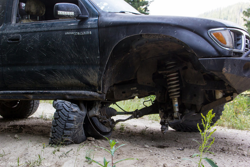

    Why go with OEM? is it really worth the extra money?.....15005721185_2cab79126f_b.jpg
    At the very least I would go with the moog/555. They don't last as long as Oem but they are not total junk compared to the other aftermarket/China lbj's out there.
