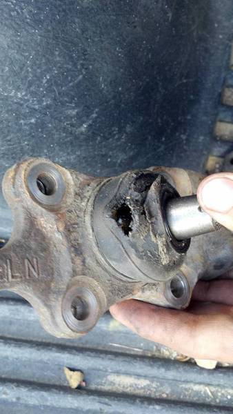

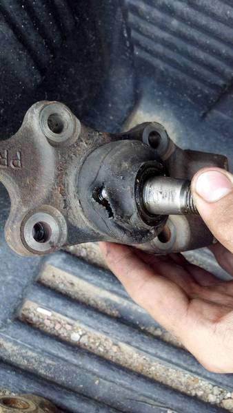

    Replaced mie today... here are the ones i replaced

    Aren't those for 2nd gen. ??

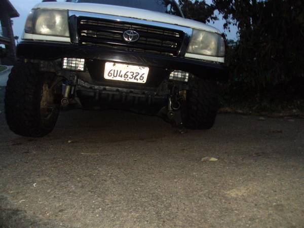

    Don't wait for this.... when bad LBJ's get worse....

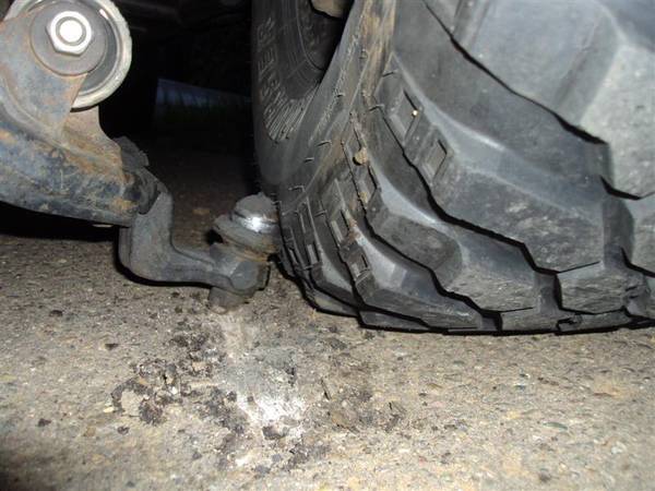

    Luckily it happened in my driveway & not doing 70mph down the freeway..

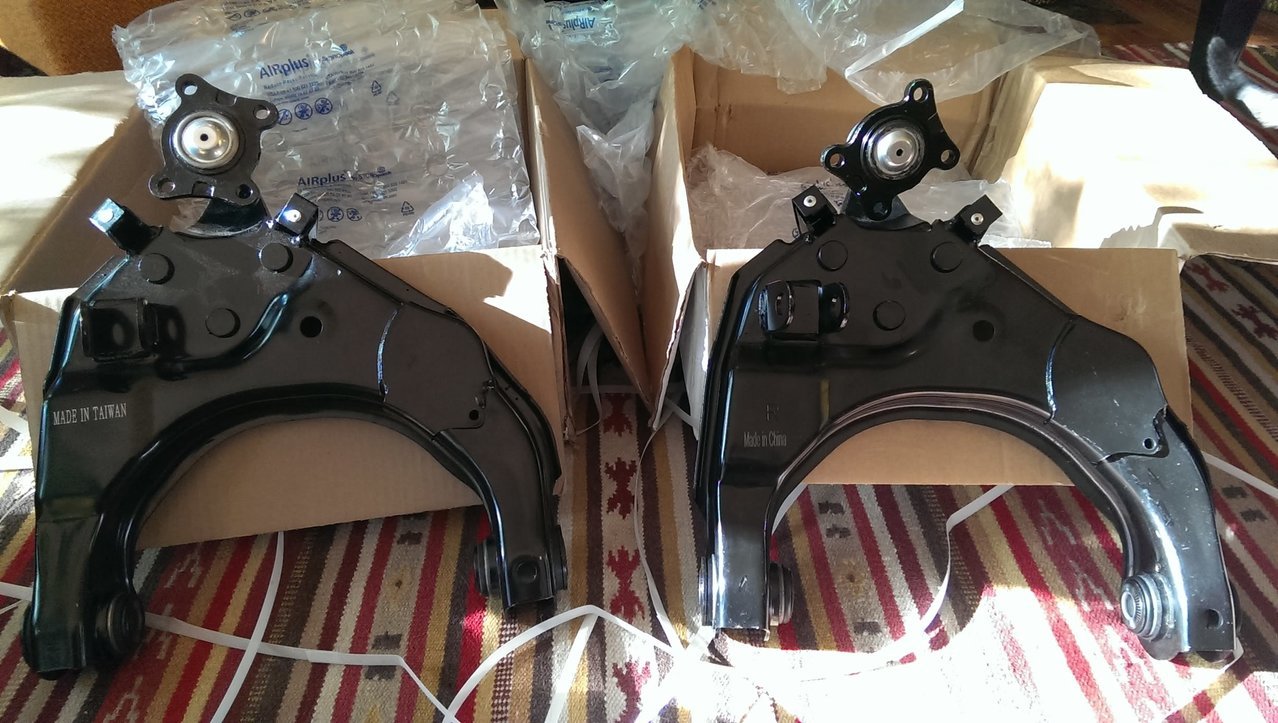

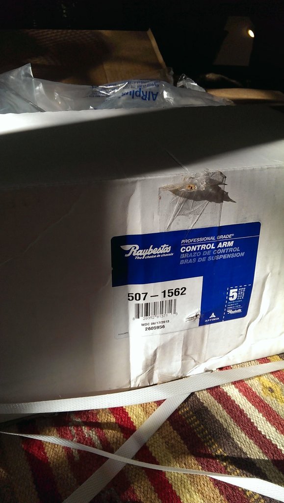

    So, i receive two different boxes. One, white with a Raysbestos "Professional Grade" label and the part number RA listed on their site on the outside of the box. The other, a plain brown box with a generic sticker on it. With the other RA part number listed for the LH LCA. (RA=RockAuto)

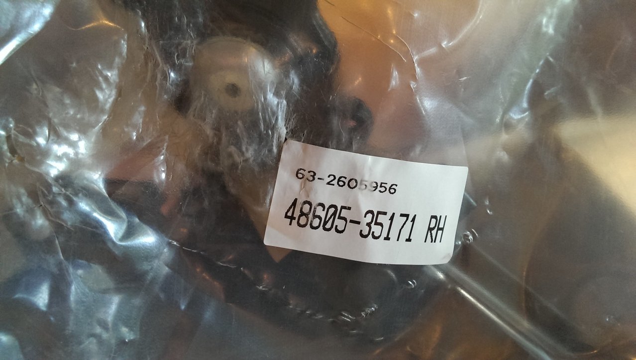

    Inside the white box, a bagged part. Googling this number tells me it's a "Tahiko" brand HILUX LCA! You know, for a Hilux...

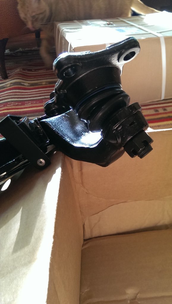

    Lets open the brown box and have a look. Ok, the parts not in a bag, but here's the kicker, that's right... i received TWO Right side LCA's!
    And here's that ball joint. The Taiwanese part (Brown box) Had "SL-40" Laser etched in to the silver base. The white box part did not.
    So i called RA, and the rep initially told me i'd be out the $ for the original shipping but they'd cover the return shipping plus the parts refund (Std. policy). That was 'ok' but not ideal... i mean, these were clearly not even for the correct vehicle and i called and verified the parts were for my truck prior to ordering. When i reminded the rep that on top of them not being for my vehicle, they were two Right side LCA's... She budged and covered the entire order+1/2 of the original shipping. That made me feel alot better, even though it wasn't much cash. She also mentioned that there were multiple notes on this part of customers complaining about incorrect fit/wrong part. So, hopefully this part will be pulled from their catalog and no one else will order hoping for a deal and end up having to send them back.
    TL;DR - Don't order parts 507-1561/507-1562 thinking you'll get what you need. Just do it right. Either buy OEM (If you have unlimited funds) or do what i'll probably do, replace the horribly seized bushings in your stock LCA's, and buy the nicest LBJ's you can afford.

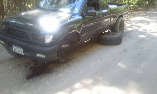

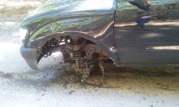

    I still think I have the worst ball joint failure on here... Haha going 25mph when it happened too. Bent frame, over $1,000 in damage
    It does well at clearancing fenders though! Lol

    That's pretty bad!! We're they worn out or something?

    As far as I knew they weren't. Never had any play that I can remember. Wish I would have kept the truck and SAS'ed it...

    Nope... NelsonTmatt happened to him twice the first time I think he was going 65mph on Santa Ana freeway or some shit, the 2nd time not as fast on some surface street in L.A. IIRC
