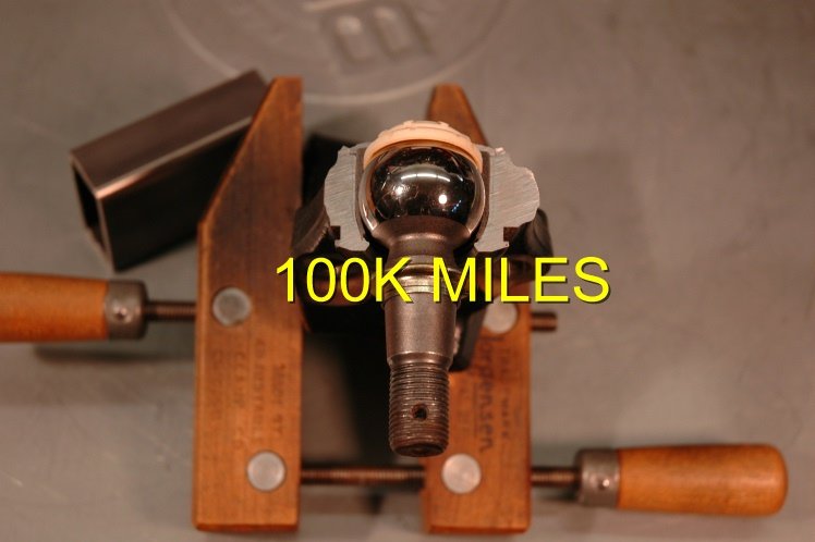

    From another thread/subject.
    There should have been a 100% refund, shipping and all.
    I will say it again for everyone reading this thread. OEM LBJ's do not just pop apart. They come apart when they have been pushed 20K-40k miles or more after they are worn out. In addition, the 4 LBJ mount bolts do not "just shear". They loosen then shear and by all rights should be used only once.
    Look at these pics. The sectioned joint below, had maybe .030" of play, worn out by the Toyota spec of .020". The ball had not even come close to wearing through the PTFE liner. For one of these to separate it would have to wear through the liner completely resulting in better than 1/8" of up and down play. Then the ball would have to chew it's way through a hardened ring of steel. That is a long period of neglect.
    The Toyota design flaw of mounting the 1st gen LBJ's so the joint is in a constant state of tension makes checking for play tricky and the traditional methods of checking a ball joint do not apply. Subsequently many folks, "techs" included, let these babies go way to long and they fail catastrophicly. They can only be checked by a very specific process, explained here. http://www.tacomaworld.com/forum/1st...ll-joints.html
    The bluing from the hardening process is clearly seen around the center ring of this joint. When my band saw blade hit the hardened area, it went from premium Starrett bi-metal to junk in 2 seconds.

    Pardon the Pontification.
    Unsupported blanket statements like "raybestos pro grade are shitty" are for the most part internet post ho kiddie speak (not directed at you).
    I have been monitoring 1st gen ball joint issues since they started to crop up some 16 years ago and I adapt my position as new info surfaces.
    As it stands today there are only 3 LBJ manufacturers that I am aware of. In order of quality, Toyota OEM, "555" brand, and Chinese "bastard" joints. Moog, Raybestos and most likely any other aftermarket "premium" joints are just outsourced "555" brand. These "555" joints are a cut rate version of the standard they supply to Toyota for OEM applications. This is documented fact.
    The Moog "gusher Bearing" hype comes with the fine print "most applications". To me, it is still up in the air exactly what is inside the aftermarket "555" joints. Until I can dissect one I have my suspicions.
    The OEM Toyota joint uses a highly polished (mirror like finish) ball in a Teflon type socket, assembled under high pressure. This technology requires only enough lube, at assembly, to "condition" the plastic socket. The mirror finish of the ball is the key to longevity, not a repeated lube schedule. This is why there is no zerk on OEM joints. The fact that the after market "555" joints come with a zerk leads me to believe that they are just cheaper to produce "metal ball in metal socket" technology requiring supplemental lubrication. Additionally, several folks have mentioned these joints feel "rough" out of the box, indicative of the old metal on metal technology. Further, they do not specify any specific lube. Some lubricants will attack Teflon. Just ask the uniball UCA folks.
    I would not worry to much about the less than OEM grade Moogs but I would keep an Eagle eye on them learn how to properly check them and expect significantly less than a 100K safe life. This is assuming they were installed correctly, a whole other story that goes way beyond "use thread locker".
    If anyone wants to send me an old Moog, I will gladly section it for comparison to OEM.
